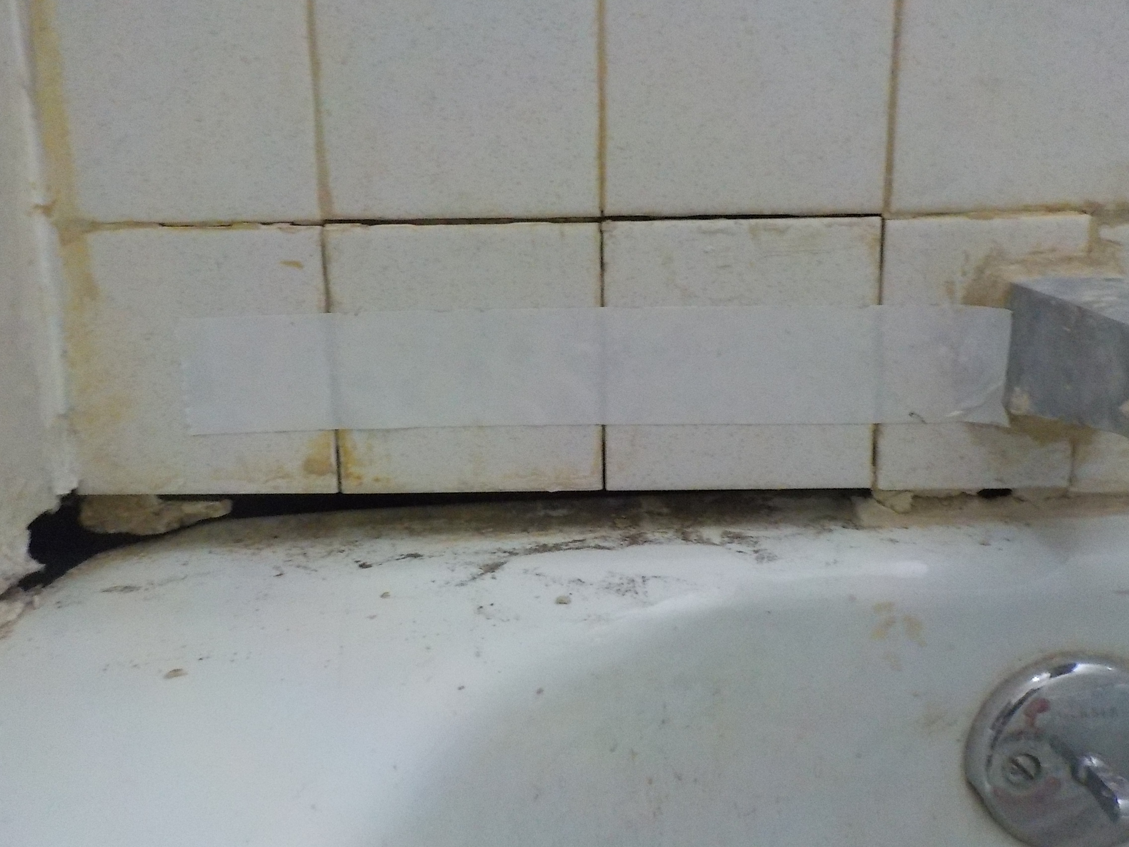

I am new to this site. Hope you can see the photo & read my reply. I don't know why my photo shows up twice, but I don't have time to change it. Thanks for your help.
That bath definitely looks as tho it has moved down, the problem is that you don’t know if it’s still moving down or has it stopped. Is it the bath legs or is the floor under the bath giving way. You need to take bath panel off and see why this is happening or you could be visiting your neighbor or basement the quick way. No amount of Silicon or quadrants will permanently fix this and IMO those tiles look past their sell by date and all need renewed anyway. So in short fix the bath and floor first then get some new tiles on :thumbsup:
