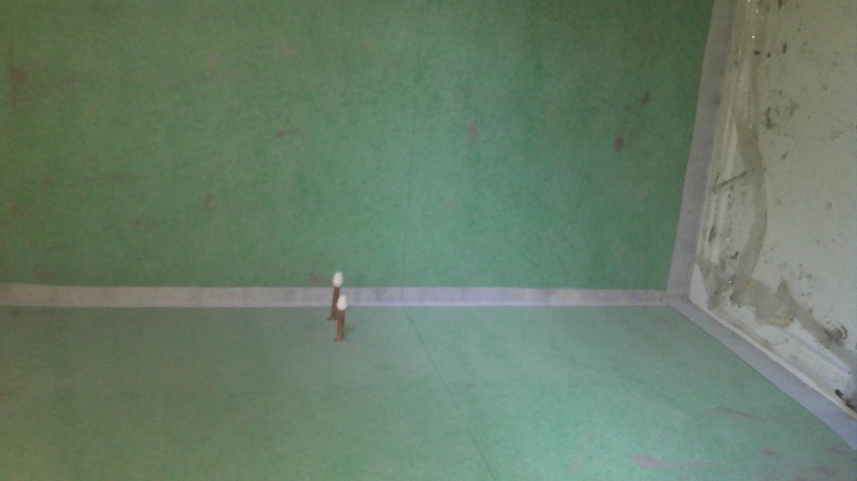

Hi,
I Is it best to use Mapei Shower Waterproofing Kit on bare plasterboard or skimmed plasterboard in the shower? I was going to use Aquapanel but there is not enough room to fit stud supports behind it and I have learnt it is not supposed to be dot and dabbed. Should I use moisture resistant or is normal plasterboard OK?
Thanks for any help

As Dave said, just tank the bare plasterboard. On with one now.
