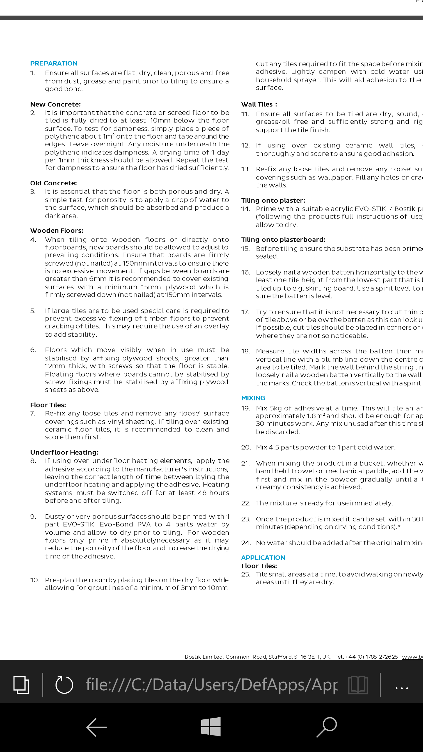

evo-stik recommends priming with PVA
Underfloor Heating: 8. If using over underfloor heating elements, apply the adhesive according to the manufacturer’s instructions, leaving the correct length of time between laying the underfloor heating and applying the adhesive. Heating systems must be switched off for at least 48 hours before and after tiling.
9. Dusty or very porous surfaces should be primed with 1 part EVO-STIK Evo-Bond PVA to 4 parts water by volume and allow to dry prior to tiling. For wooden floors only prime if absolutelynecessary as it may reduce the porosity of the floor and increase the drying time of the adhesive.
