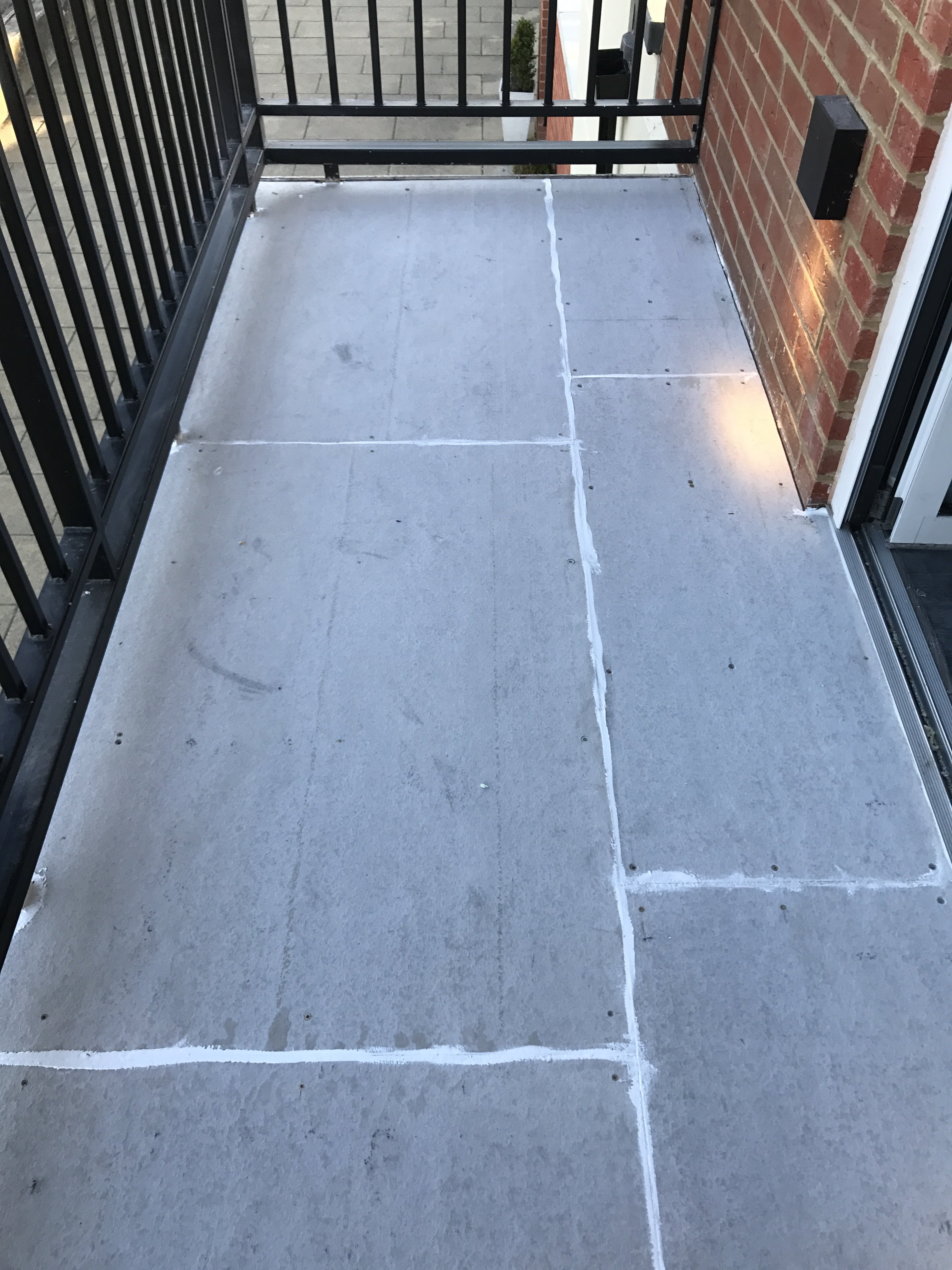

Hardie Floor structural board, really good product.
Tongue and groove cement board, 19 & 22mm thicknesses, finished job.
If there’s no danger of moisture ingress, then totally recommend it.

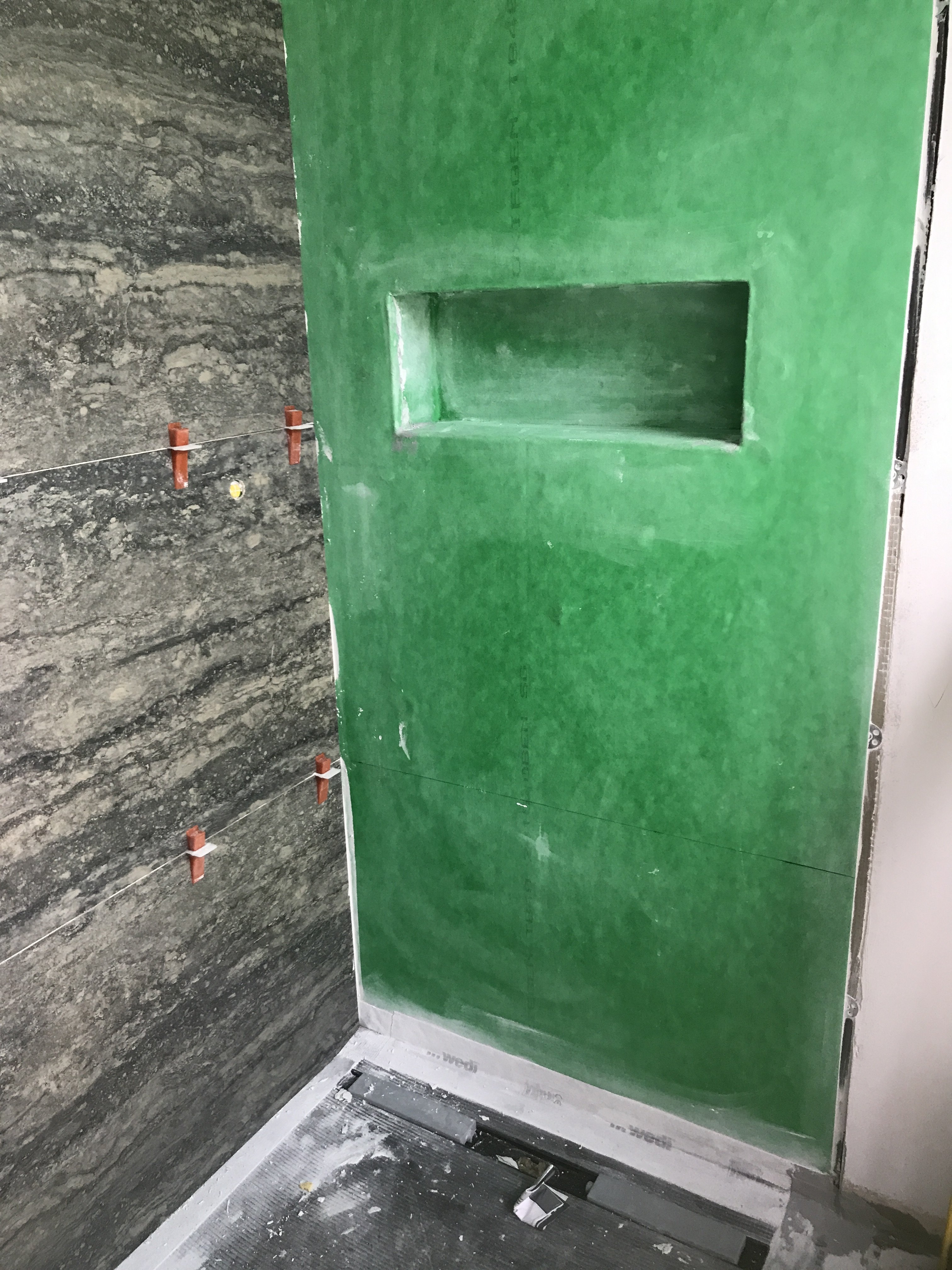

If your going to use a matting on a bathroom floor, then use Isomats waterproof decoupling membrane.
Two products in one and very versatile.
This can also be used on shower walls for tanking purposes.
