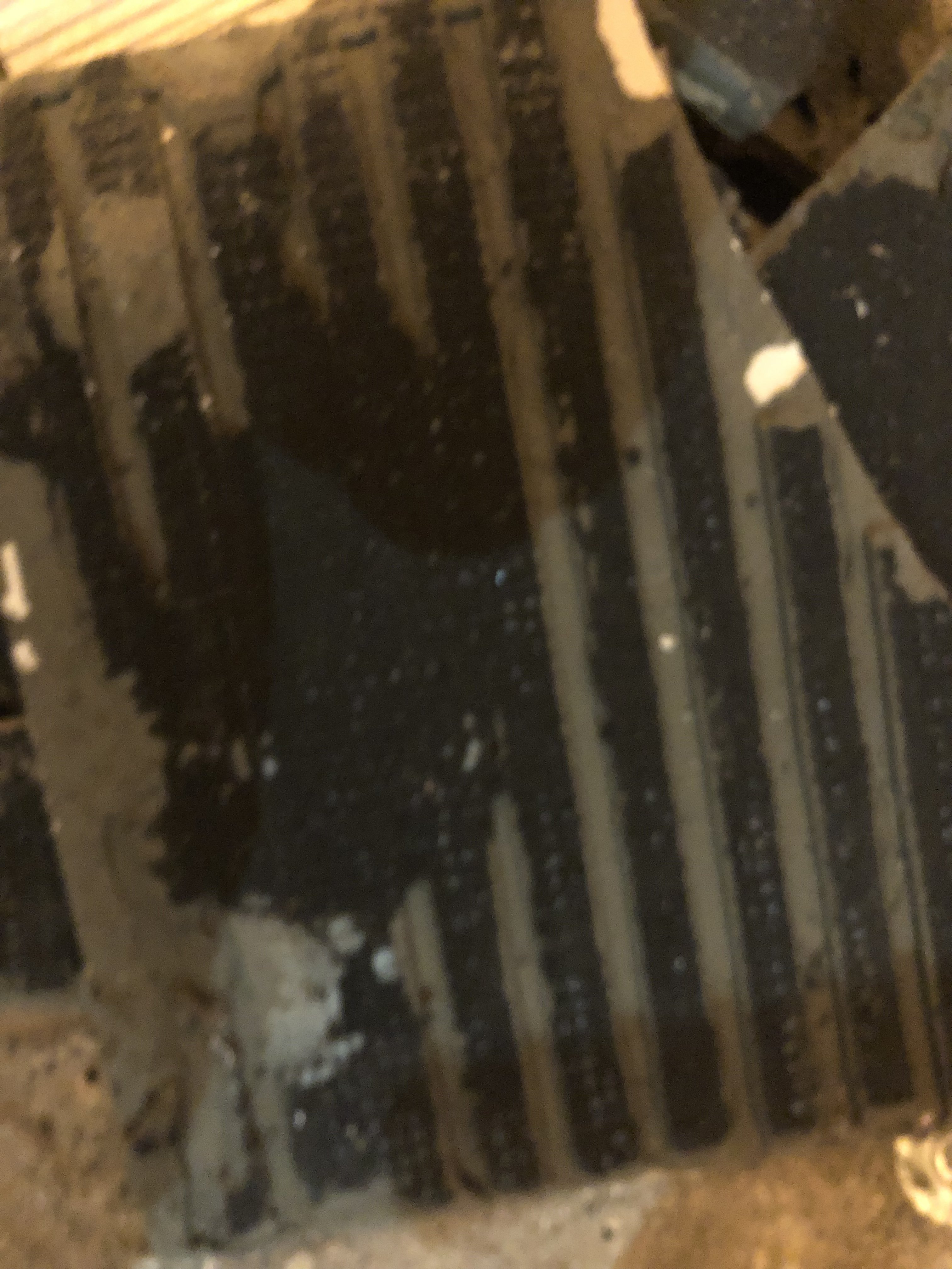

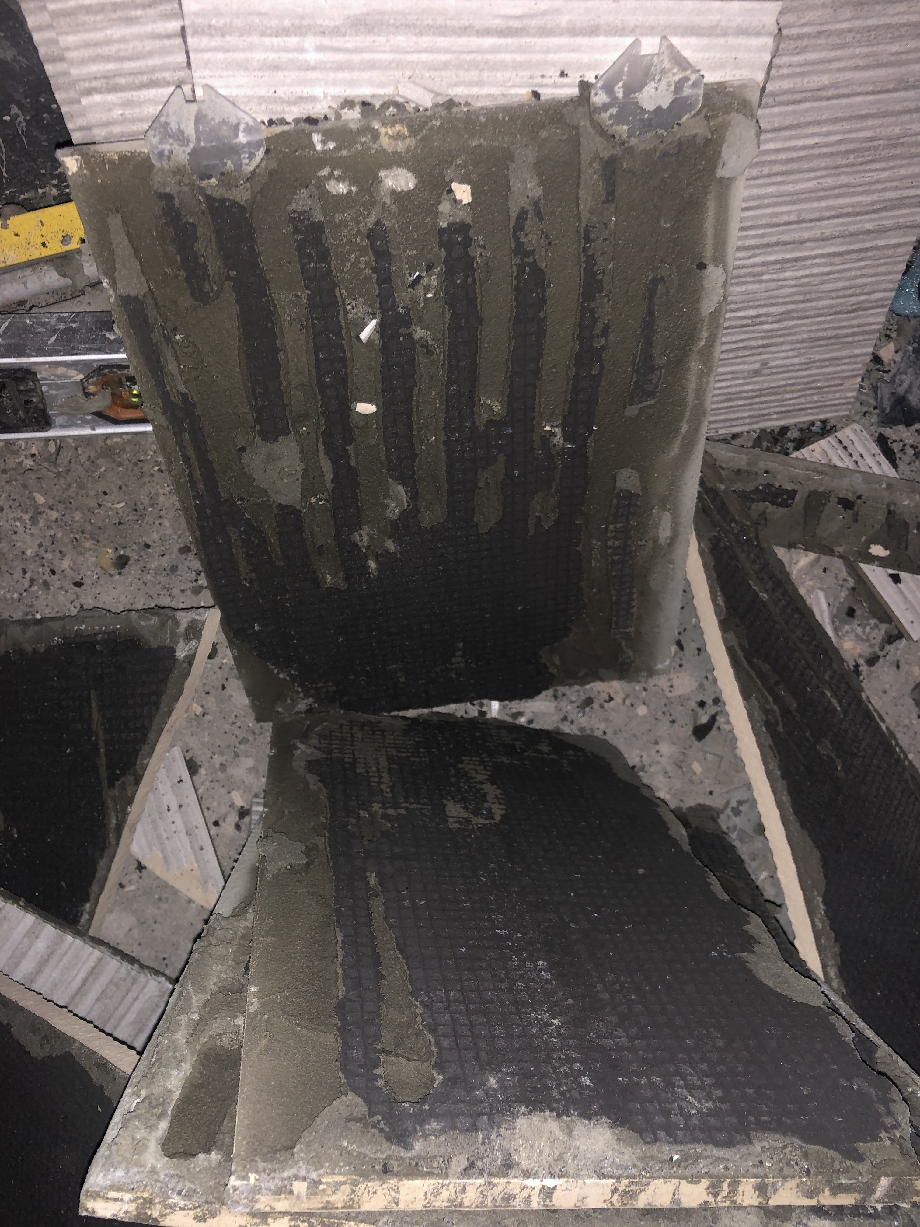

Help ... 2 different tiles joint don’t line up (assumed both 30x60 but not)
After removal photos. I think I need to press the tiles a bit more, although I did remove some tiles during the tiling and it seems they were fully covered. I used 12mm square notched trowel and back buttered. Also what is your thoughts on keeping the gloss tile row? The tile last tile is 15mm short of the wall, but would sealant hide this with the split face tiles against it?
