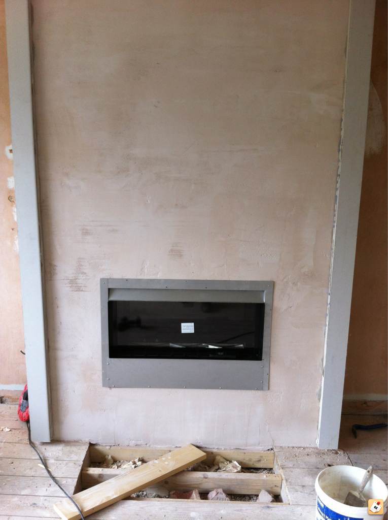

Any recommendation on a heat proof tile adhesive? I'm tilling around my fireplace with slate tiles but the fire gets very hot. Will any decent flexi adhesive work ok?

I would recommend a modified c1 but not more than that , as the polymers could soften , most adhesives are fine to 100 dgs cel , so always check with manufacturer for suitability .
