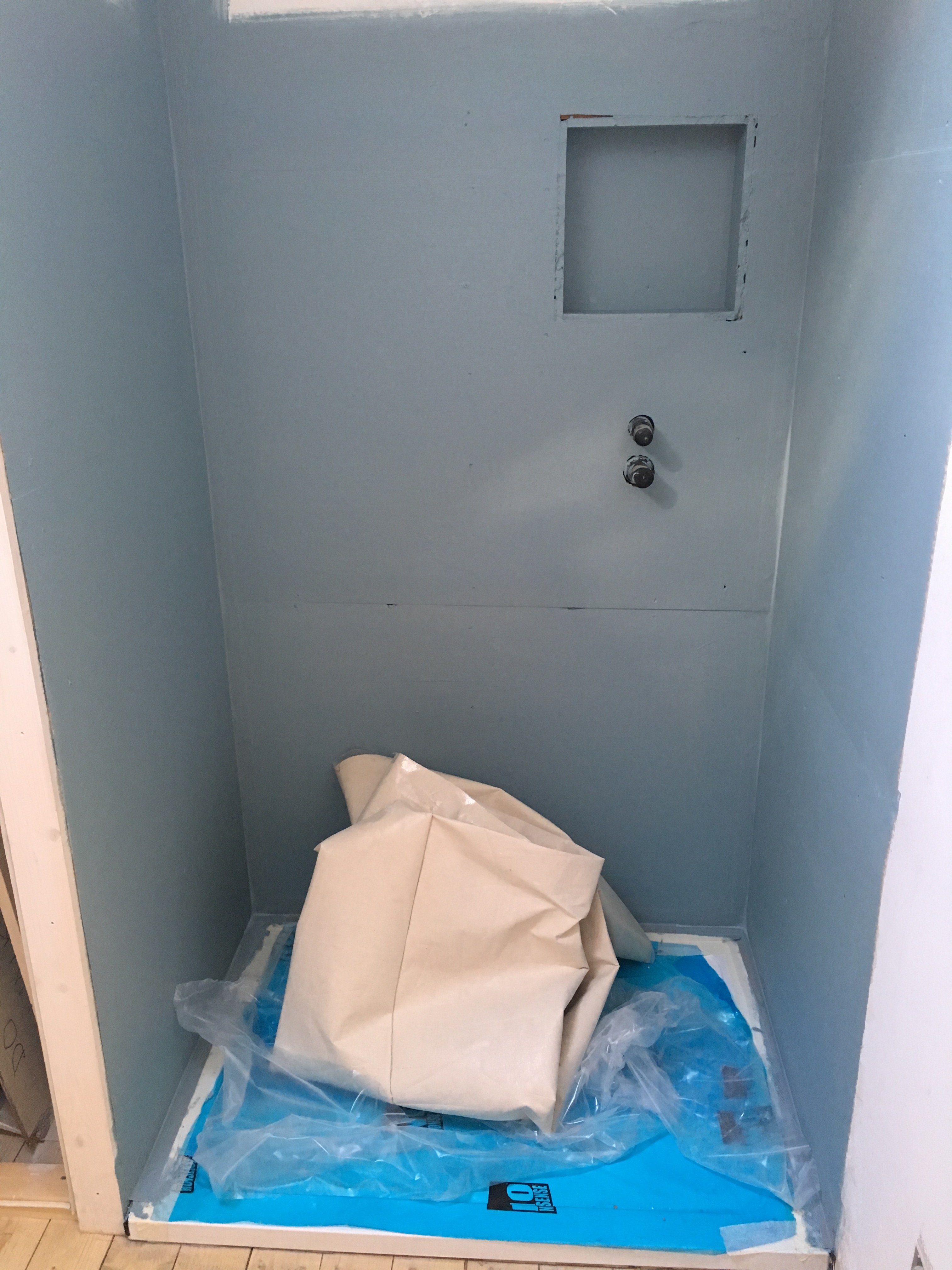

Hardie in a shower I've just completed.
It needs tanked to be waterproof.
