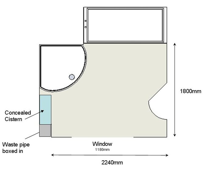

The room is approx 2.2m in length and 1.8m in width. It's actually an L-shaped room but the bath is going into the recess which theoretically makes it into a rectangular room regarding the floor tiling. I have attached an image which should give you a rough idea of the layout. Thanks.

The floor is only small and that will help you, you can open and close the grout line very slightly to line things up, however if the tiles are very much bigger than each other then it will prove difficult regarding grout lines. You could opt for placing a floor tile in the middle of the wall tile, so you will get a half bond or brick bond. Cutting the larger tile down by a few mill is a no go so don't try it Bob. If its only a mill or so you should be able to get the grout lines lined up, as you progress across the floor you will have to decide how they are looking, I have done this a thousand times and to be honest Bob I only know for definate if its going to work when I can actually see the tiles on the job. Dry lay the floor after the walls are done so that you can see how they will look when finished.

I would normally do the floor first to be sure of getting every wall to line up with the floor......but with the floor tiles being bigger it's going to be a nightmare!
If you are going for the Diamond pattern then just make sure you set out properly so that all cuts are the same all around the walls, there is nothing worse than a small diagonal than gets progressively bigger along the wall, in your case find the middle and set out from there.

diamond sounds good to me:thumbsup:if u do decide against diamond i would not bother trying to align joints.like u said variation in tiles and bigger grout lines usually on floor means it wont work.can make setting out difficult aswell
dimond is good but when a grout line goes down one wall across the floor and up the other wall its very impressive!
