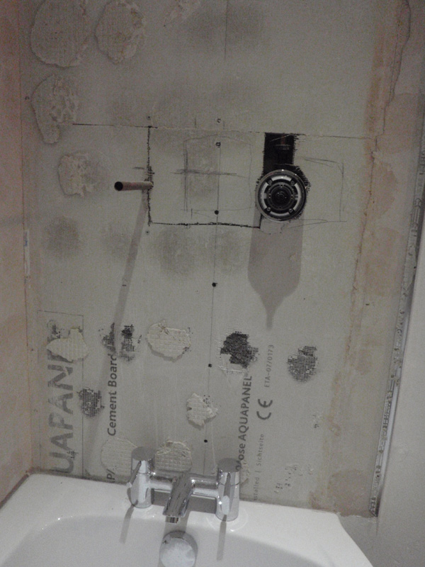

They're 25cm x 40cm the dot and dabbed seemed to dry ok. Do you think the all over will dry OK once redone?
Pics of cement boad damage below.
If you do go for bagged adhesive t hen make sure you acrylic prime plaster areas..directions for this will be on the bottle
How was the Aquapanel fixed to the wall, screw only or screws and adhesive?
Not saying you should remove it! just thinking if you can cut out the damaged sections and replace if you have any left over, and tape the joints.
Or you could use the cement based bagged addy to fill the holes and then tank the area over for belt and braces.
The cement board is ok just spread a bit of adhesive in the damaged parts to repair it. As Dave has mentioned above, use a powdered, cement based adhesive, you will get more out of a bag than a tub so is better value and also it's really easy to use (get a slow setting one) and the only difference is you have to mix it yourself. I make it sound simple, and it is really!
