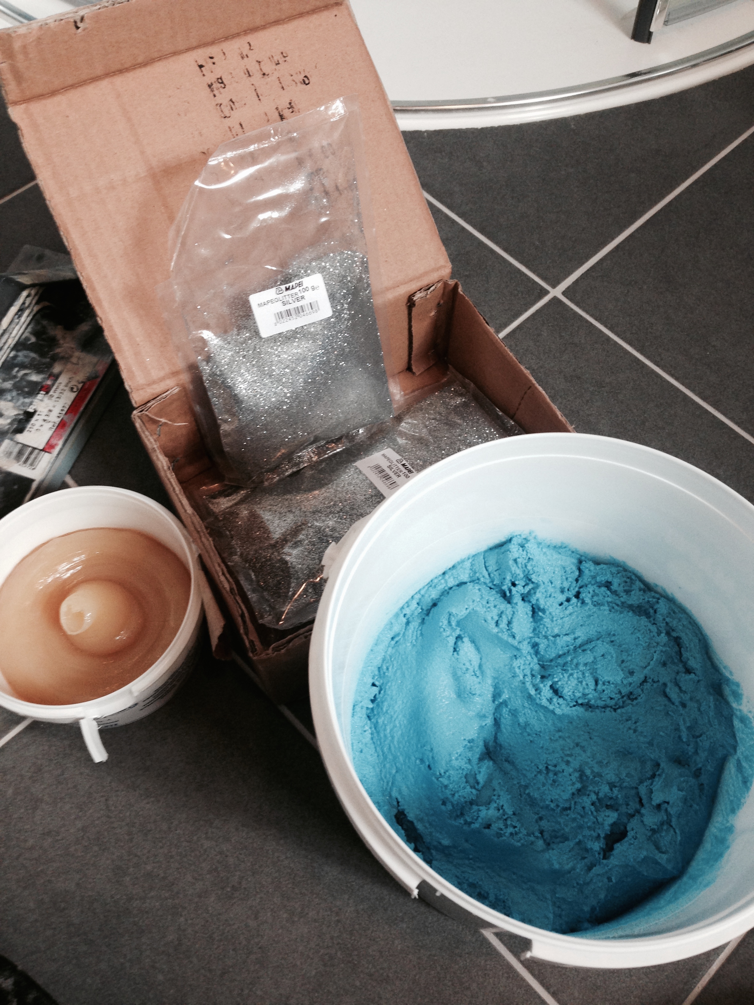

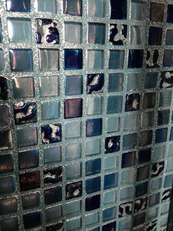

I used the Mapei glitter grout, easy as to use. Clean up with water as normal. I used the max ratio of glitter to grout. Great stuff and it gives a great result. IMG_0882.jpg IMG_0894.jpg

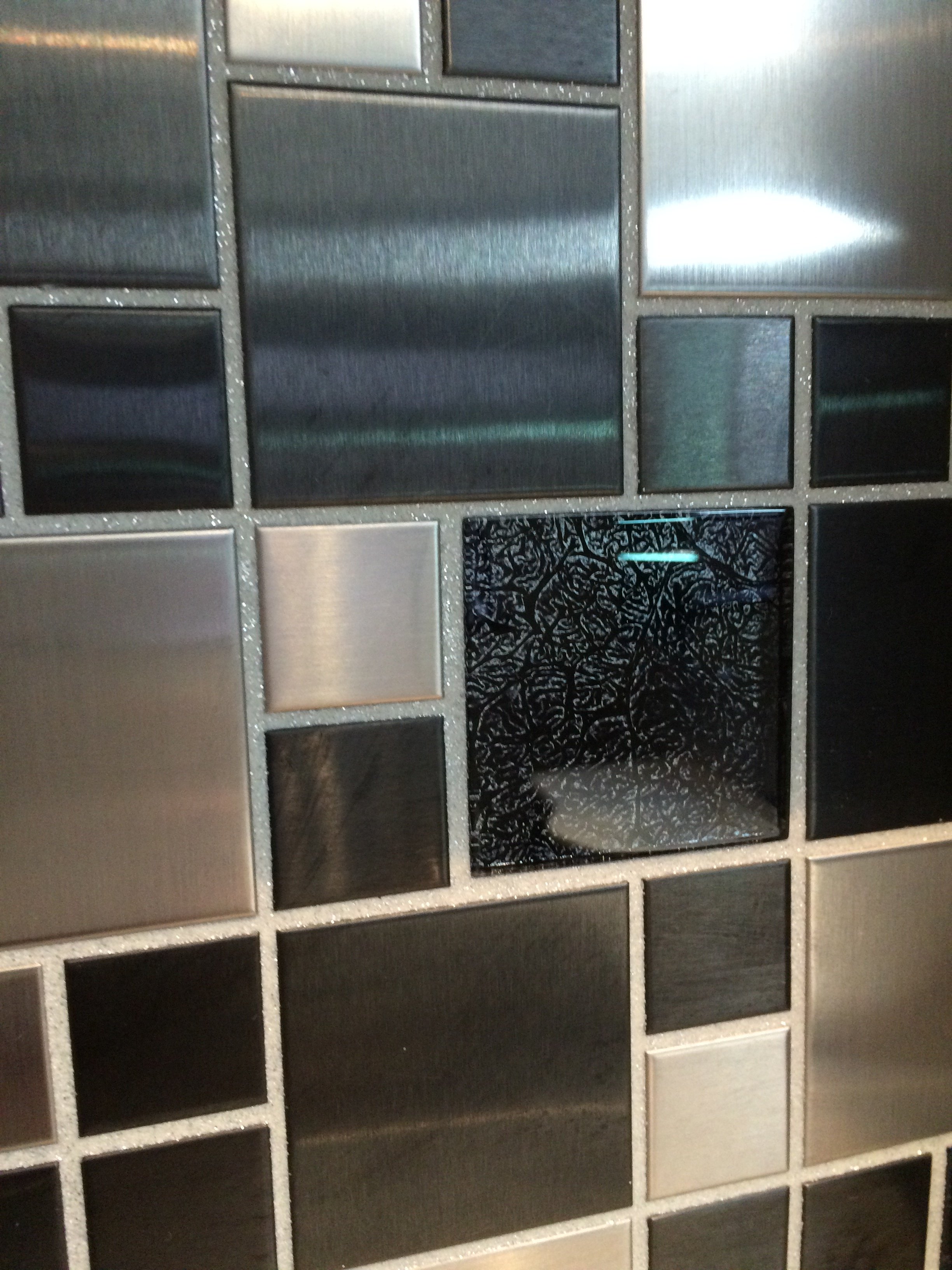

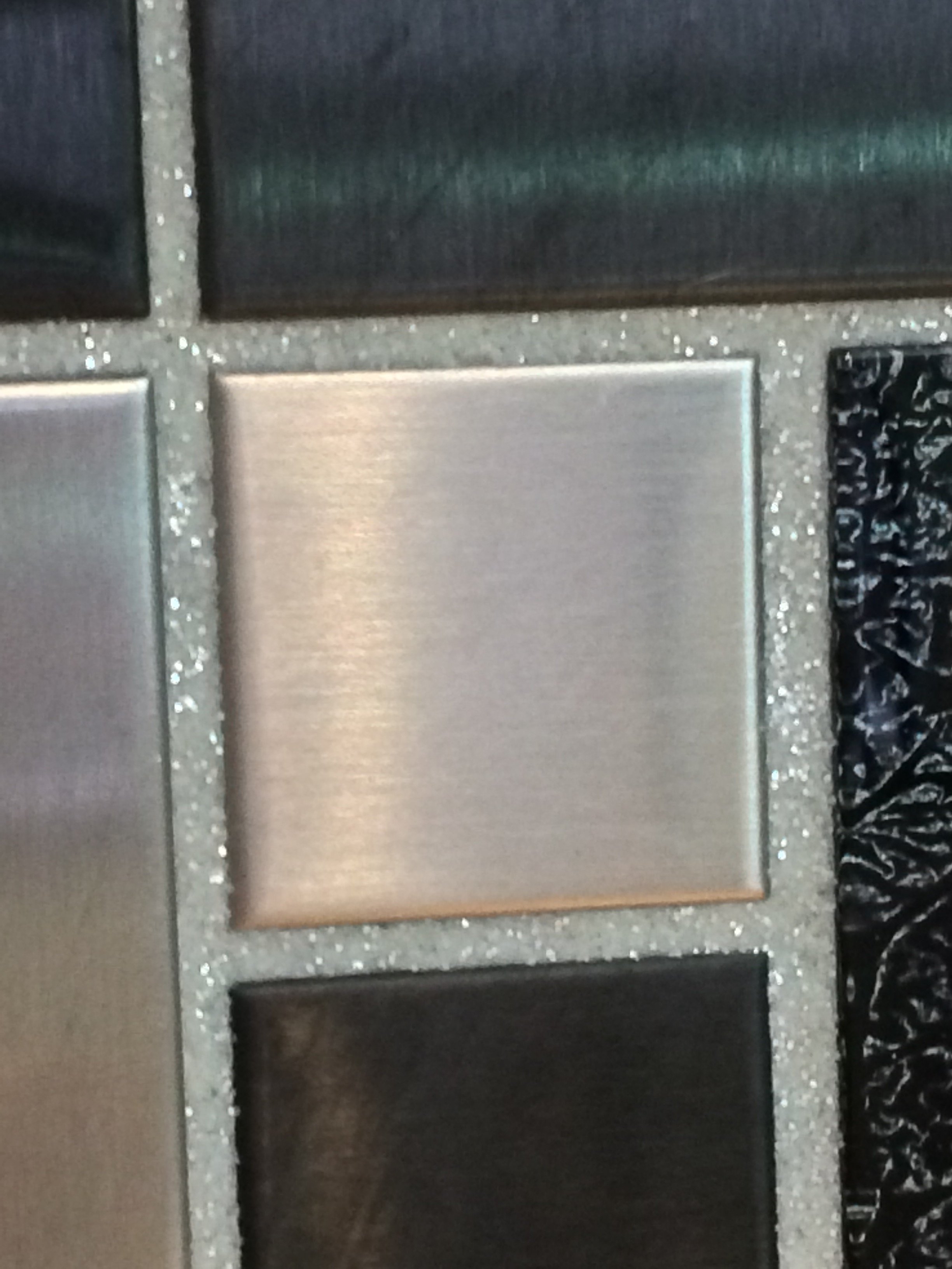

View attachment 79755 View attachment 79756
what make of grout did youn use on that job@Plan Tec Tiling, there real neat lines, how did you achieve this. Thanks.
Mapei Mapeiglitter. Following the instructions to the letter, using white emulsifying pads and plenty of clean water. I did use LTP solvex after to clean the residue off of the face of the mosaic as epoxy leaves a very slight film.

I used the Mapei glitter grout, easy as to use. Clean up with water as normal. I used the max ratio of glitter to grout. Great stuff and it gives a great result. View attachment 79752 View attachment 79753
Without being too critical, that to me looks a bit messy. I appreciate that the mosaic is full of dips, but it stands out. There is residue all over the face of the mosaic too and the joints don't look uniform. Was the photo taken prior to wiping down?
