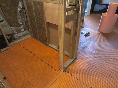

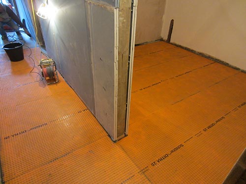

that said I have just installed this last Sunday:
