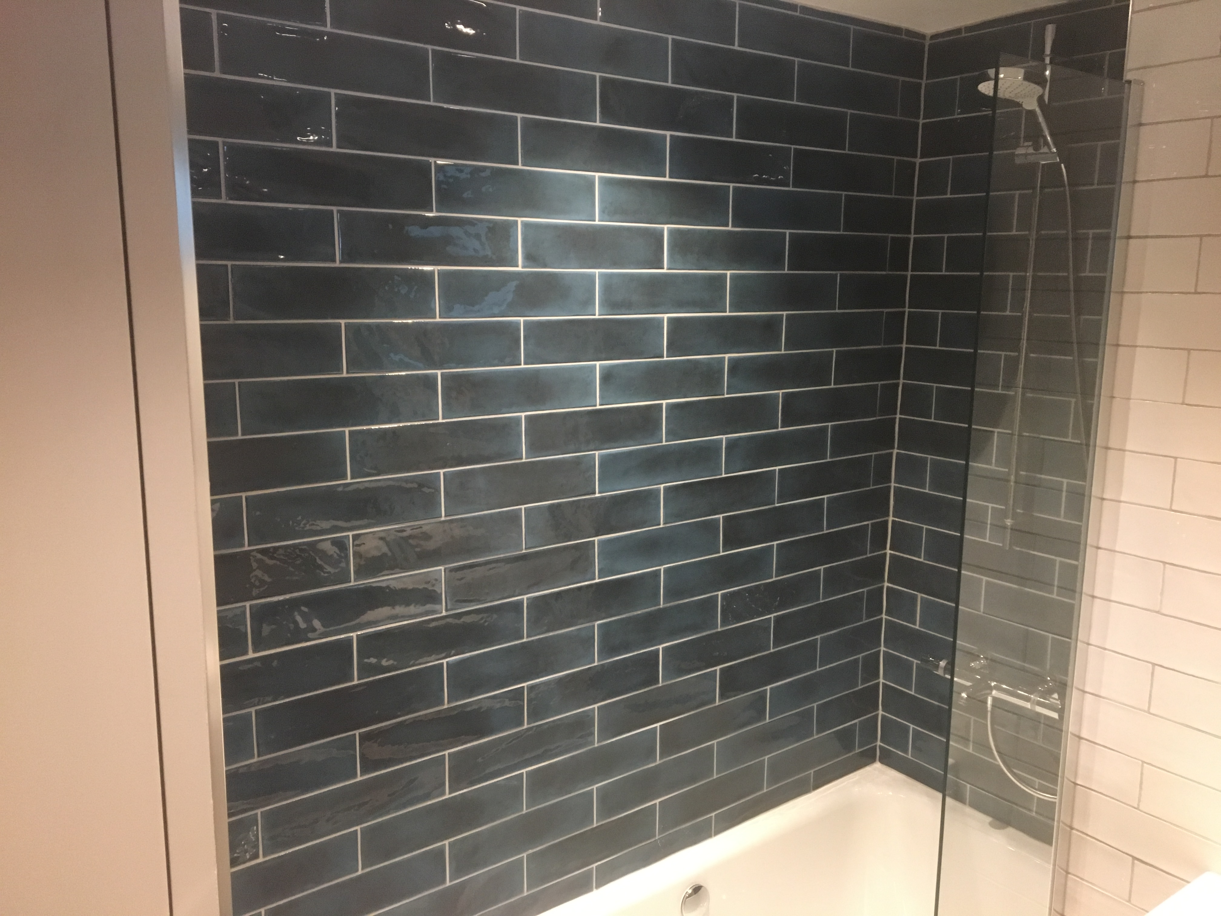

Pictures to further illustrate:
Close up of the cracked tiles. Tricky to show. This carries on up the entire wall, alternating cracked tile, cracked vertical grout line.
These two walls in blue; the long wall and the wall with the shower & mixer on, were re-done in bonding plaster. Not tanked. primed with waterproof PVA.

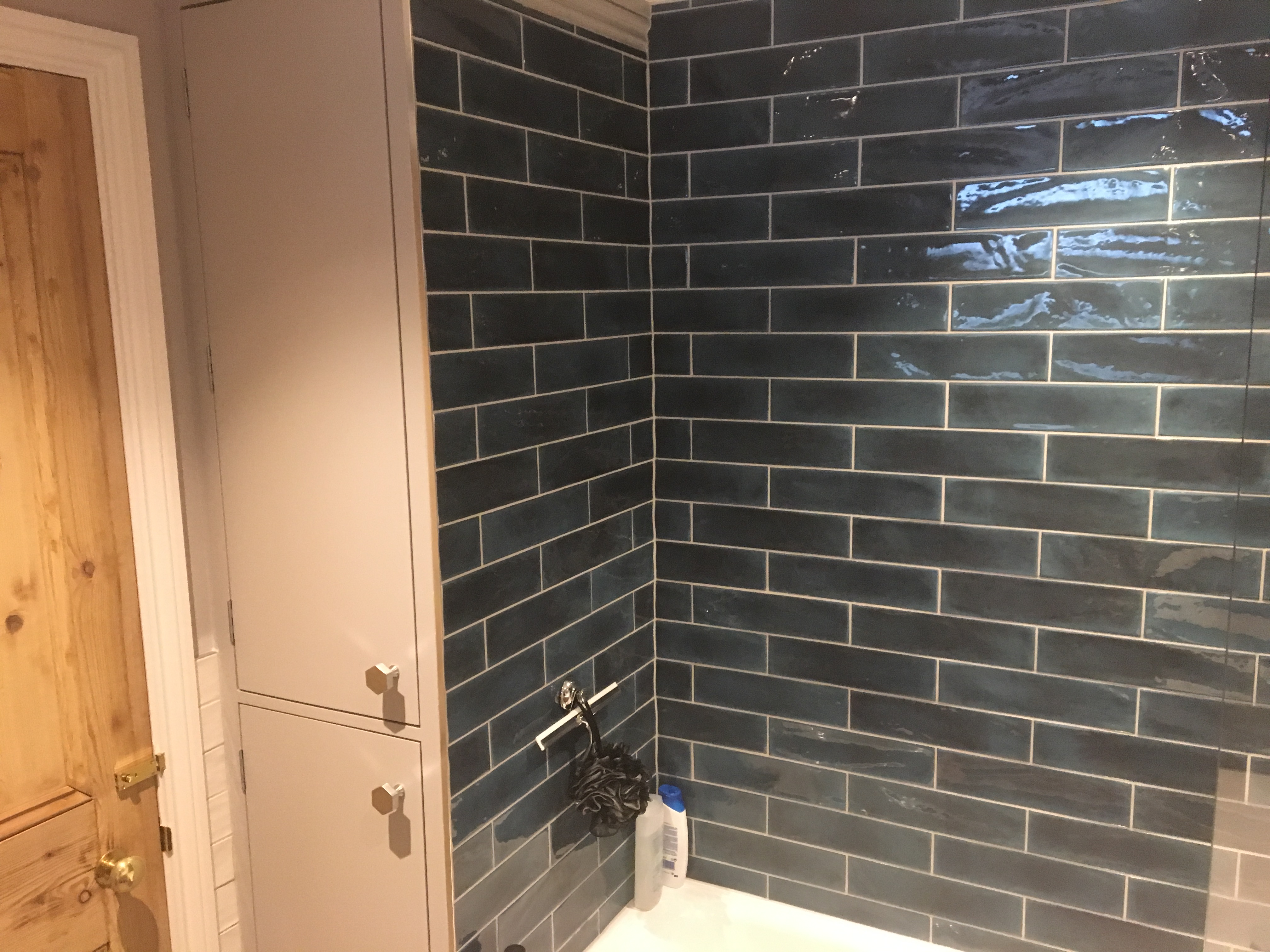

This cupboard was here before the bathroom was re-done. It was previously just painted MDF at the end of the shower. We decided to keep it, and so the painted MDF was tiled over. It was not tanked.
This small wall is the side of the chimney breast, the bath is squeezed in the gap alongside the chimney breast. This return was built out (chimney breast made approx 25mm wider) over the bath, to allow the glass screen to be fitted along the bath line. The bath was fitted, and then plastered on to.
