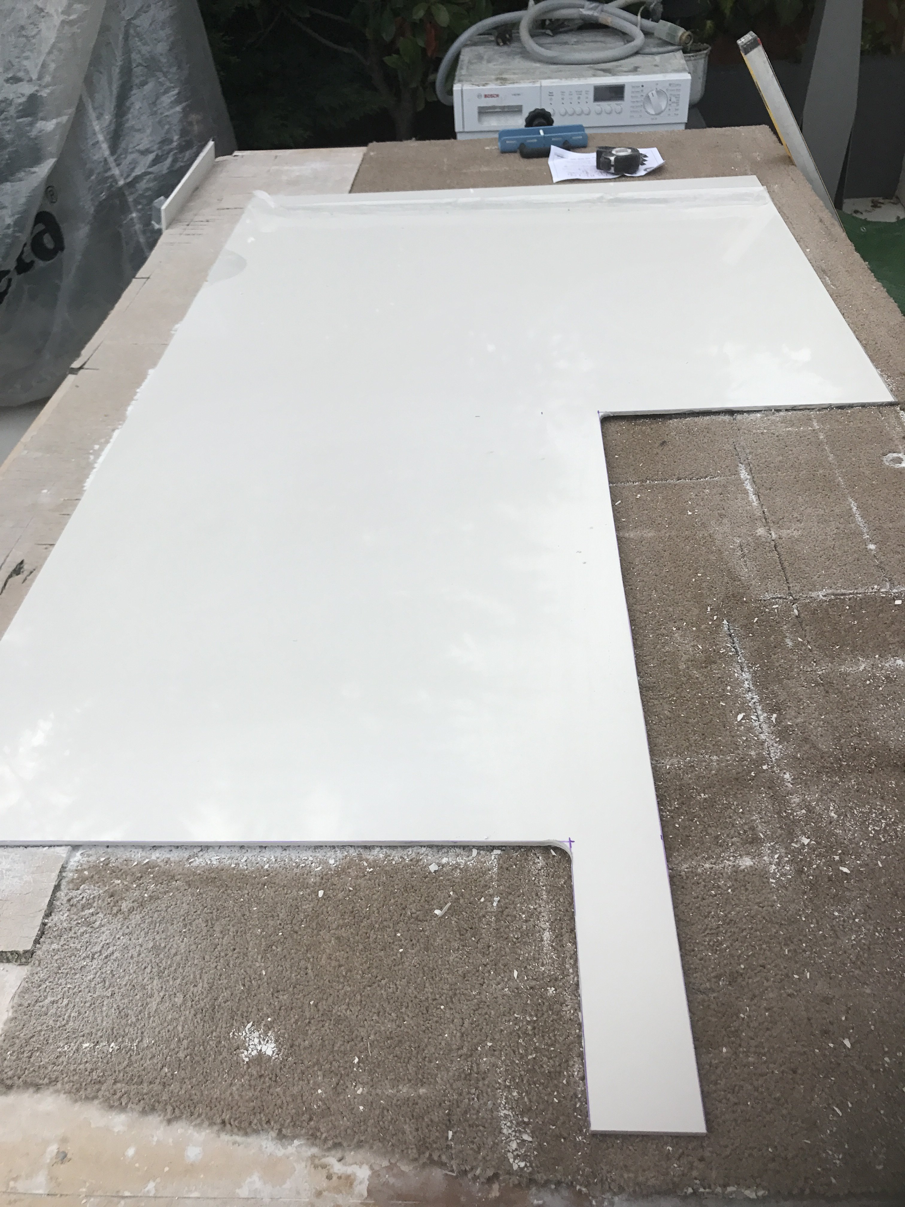

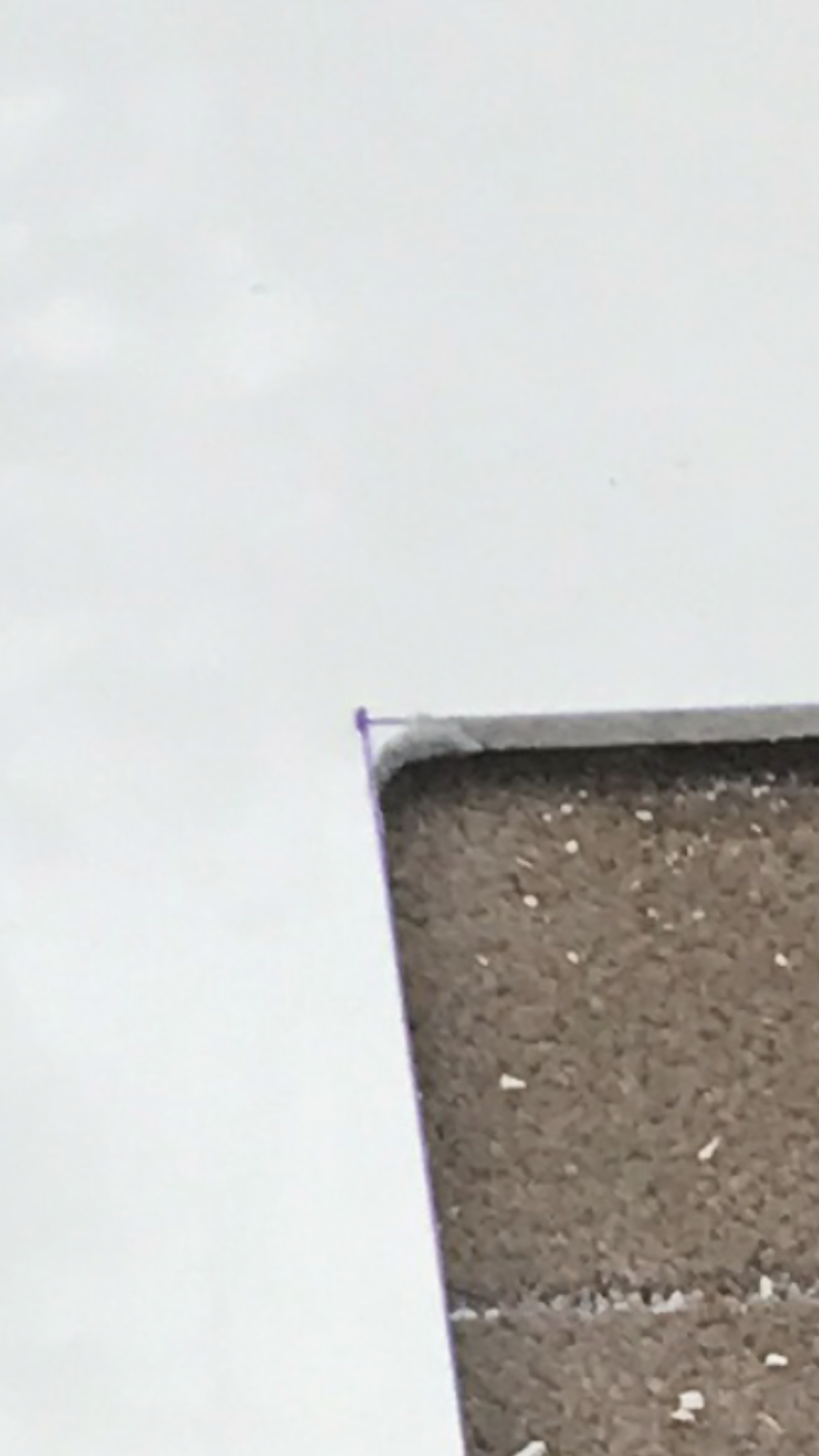

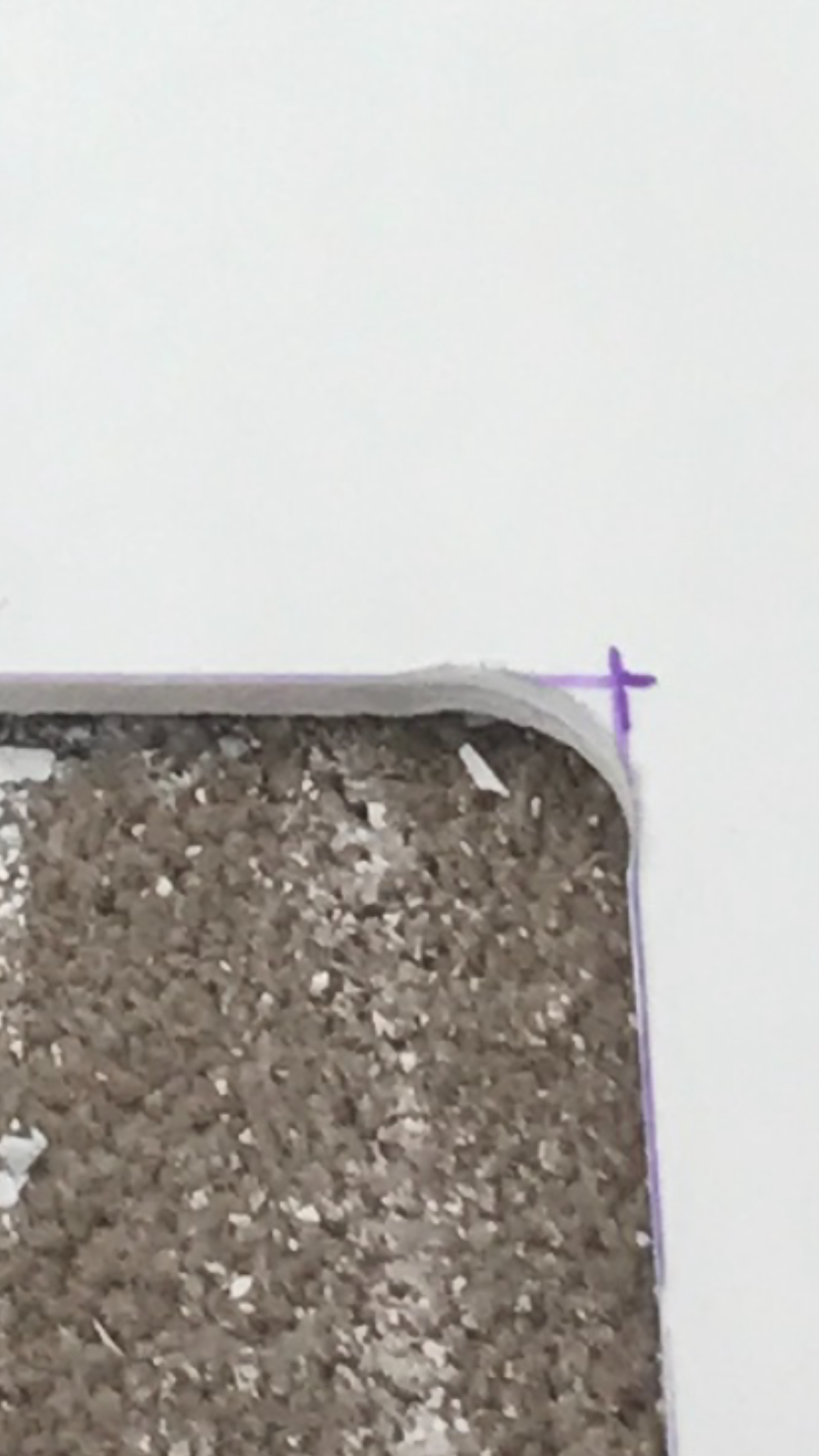

This is a piece I cut today, 1800 x 900 x 5.4mm
I used a 28mm core bit in the internal angle, and used grinder for the rest.
Always drill first, this helps relieve any surface tension too.
