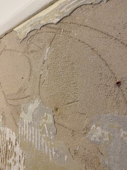

Any pics ?What's your tiling question? Pictures can be added.Hi I’ve stripped old tiles of bathroom wall and a lot of the old plaster has pulled of leaving uneven surface of about 2-3mm can I still tile this or will I need to fit backerboard. Neill.

Many thanks I think I’ll just dryline it.Looks like bonding coat and cannot be tiled directly too , scrape off all the loose and prime and patch in with one coat or re-skim. Another option if you have room is to dryline it.
