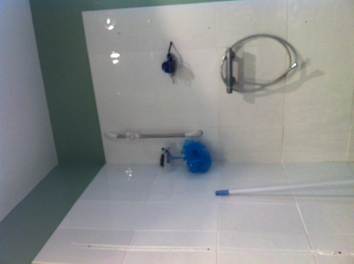

were moving the bath from our downstairs bathroom in to our ensuite
weve taken the door off our ensuite and cut a hole for a new door , tomorrow we are starting on blocking up the old one which is where the bath will be going
so building a new frame and attaching plasterboard to it ive gotten mixed advice on what i should do about the gaps around the edges some say tape then skim over others say use bonding coat to fill the gaps. what is the best thing to do on the side where the tiles will be going
also when i do have the boards up and gaps covered do i tile straight on to the PB or do i skim it first. and if i skim how long do i have to wait before tileing and do i need to paint the wall before i tile . the rest of the bathroom has a skim (i dont trust the previous guys work as he bodged a lot of crap in my house that we've had to fix)

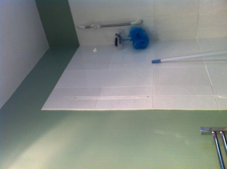

do i pva the boards to seal them or buy another type of sealer or do i adhesive straight on to the boards what is the best way to go about this job i have attached photos to try and show the current situation sorry they are the wrong way around i dont know how to rotate them the plan is to mirror the tiles that are already there on the other side then have the bath in that gap with the shower over it
(the door is just there on its side to stop my 16 month old twins getting in)

the existing walls are stud walls with plaster board and a skim on them the white tiles that are there atm where the shower is/was i started removing today and they came straight off the wall so they werent stuck down very well (not surprised at all the guy who did it is a massive bodge king) so i plan to re tile the entire area to make sure itd done right so now im wondering if when ive got the tiles off and my plaster board up where the door is (the shower thats going over the bath will be staying where it is atm where the white tiles are so where im blocking up wont get as wet kinda thing )
im thinking i should skim the door way so i have 1 even surface otherwise the wall will dip by a few ml from where it is skimmed atm to where the new board is ??
