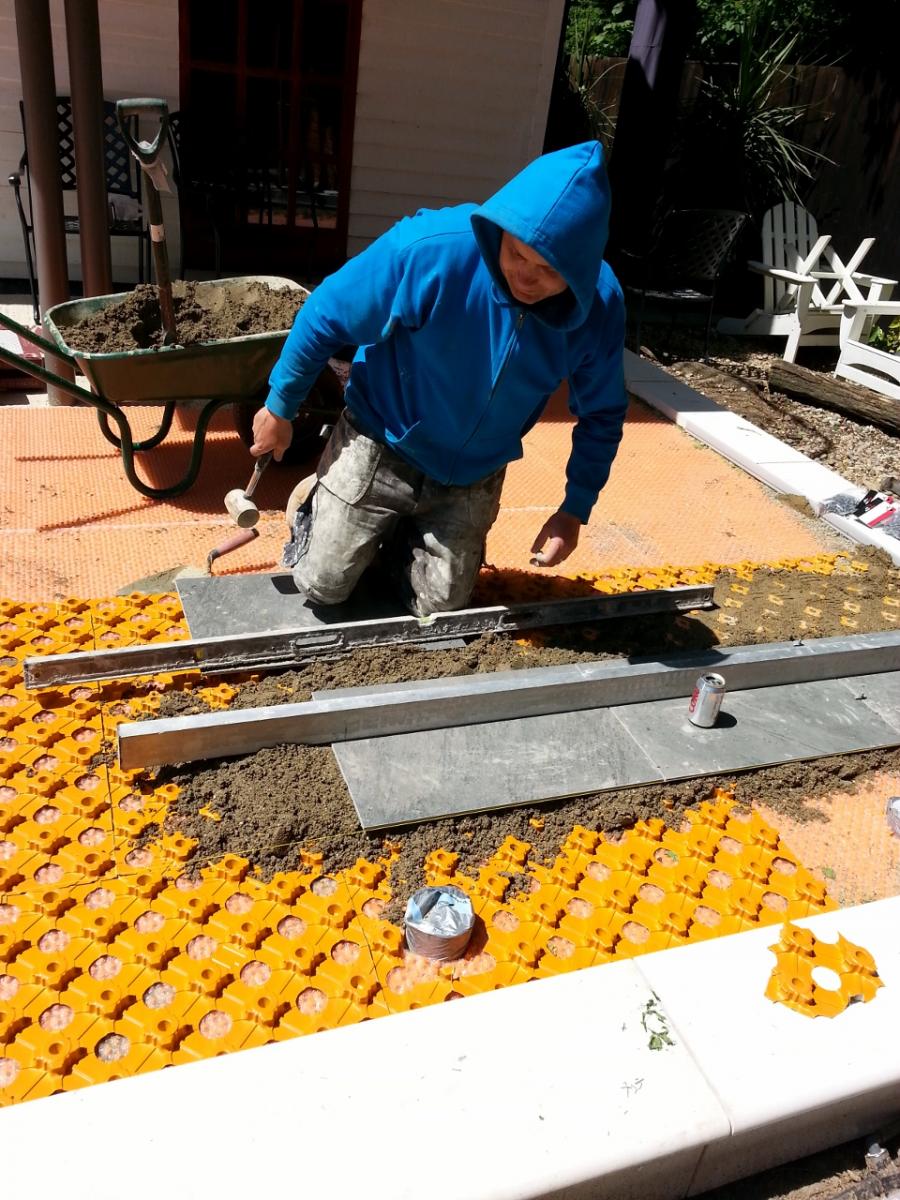

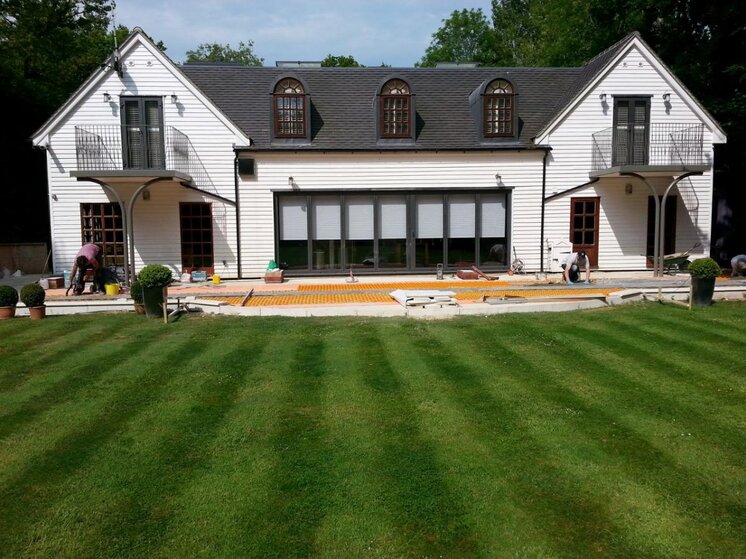

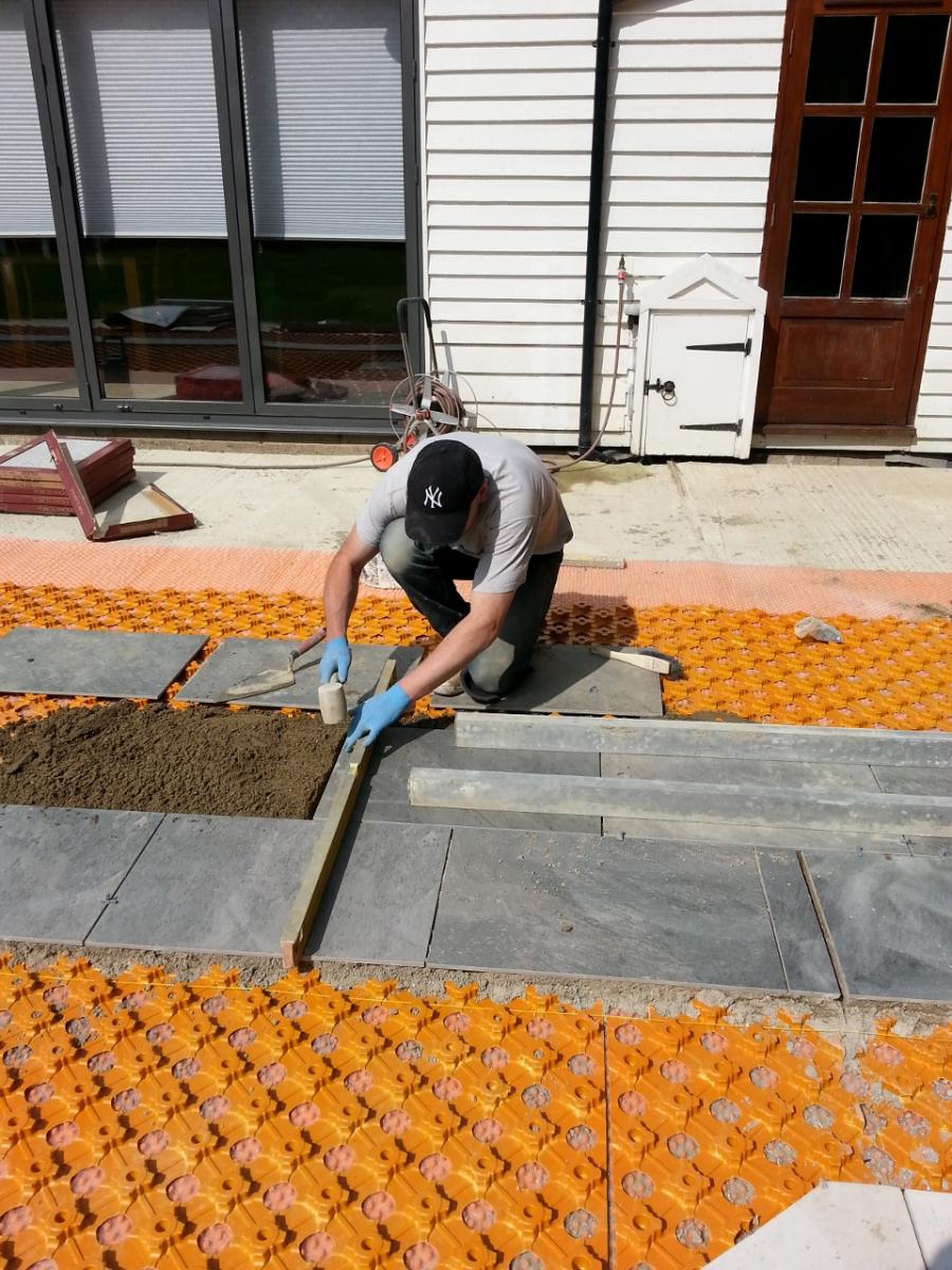

I am using troba plus and bekotec drain on one of my jobs at the moment i will post some pictures in a minute once i have got them off my phone
Be worth seeing that Gary, was it spec'd on a new build or doing it on an existing balcony??
its a patio terrace Bugs not a balcony, the specification was for a bonded screed and tile surface we decided to go unbonded as we didnt want any issues with frost damage ,the system we went with drains away any water out of the installation so should be resistant to frost hopefully, I had to pre screed some areas and grind out others to keep within the minimum and maximum tolerances of the bekotec matting we mechanically fixed all the haddon stone with corbels and stainless wire and the terrace has a 1;80 fall away from the house i will post the finished pictures next week when we have completed the job

Good stuff, it that system will work a treat :thumbsup:
Ditra drain is a great product, the guys at Schluter were saying it was developed for another use originally. Schluter had found that very large format tiles with cement based adhesive actually retained some of the moisture from when the adhesive cured (sounds odd, but this is what they told me, a bit like dispersal adhesive), so the Ditra Drain works as an uncoupling membrane but the moisture from the adhesive could escape too, then they thought of using is a self draining layer for the above usage.
Great work there, well timed with the weather!!!
