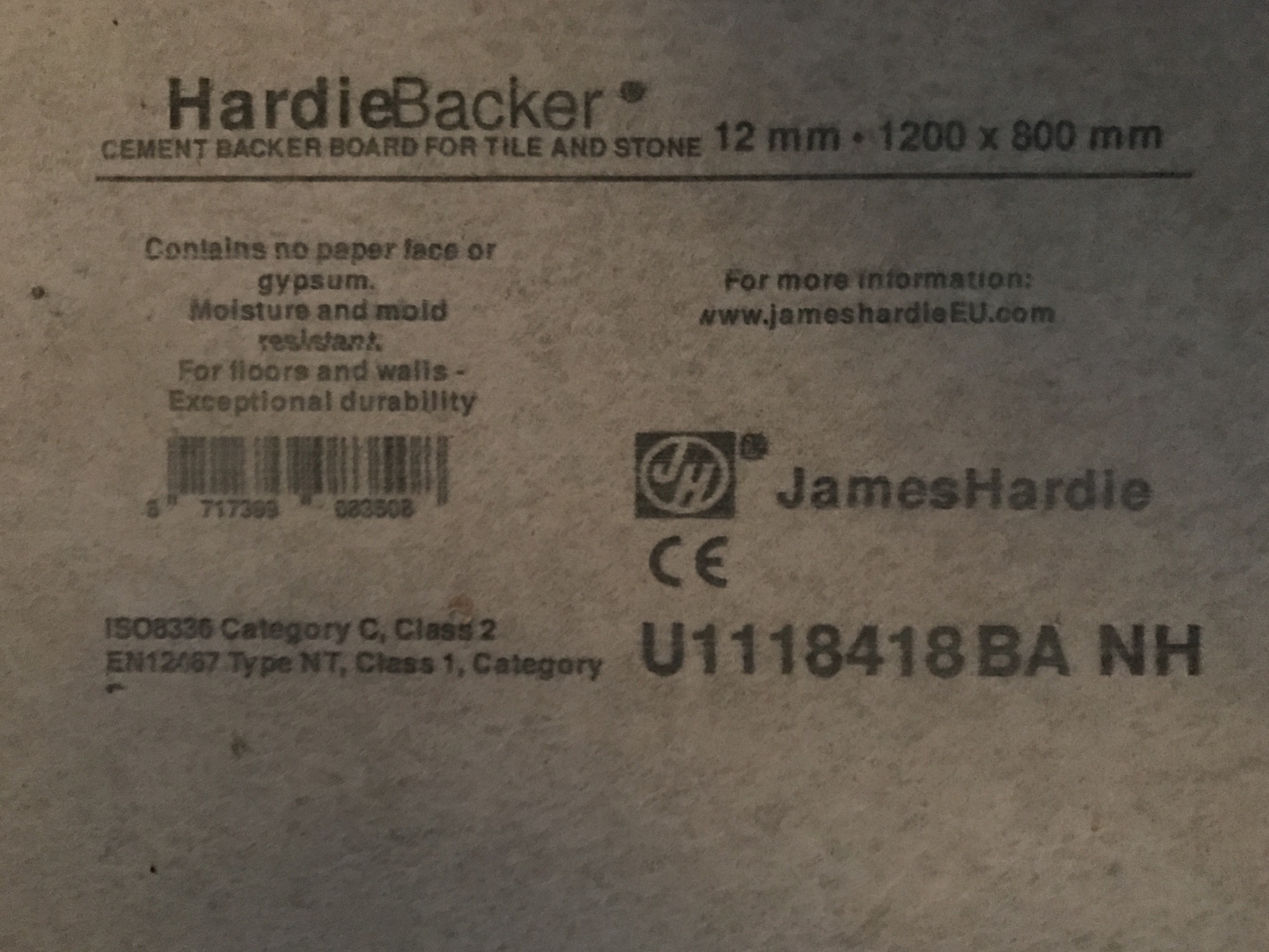

Hi I’m new to the forum and have a similar question. My builder is wanting to use hardiebacker board (12mm) (picture attached) on top on the laid water pipes. My concern is that unless they use a cement board specifically designed to be highly conductive, the Hardiebacker board will significantly limit heat transfer. Is this correct?
I know expert on this matter but maybe you should phone hardi and get them to integrate the u values of their board and also no more ply and Beava board . I do expect their values to be similar in a like for like thickness . Cement boards transfer heat to a degree whereas foam insulation boards are designed to insulate so therefor wi limit heat transfer . But I would say that the builder is doing the correct thing . But one question why are you not using a tiler their are regularly people on here saying something gone wrong when their builder has tiled something . After all would you ask a tiler to build a wall
Thanks for your reply. I will email hardiebacker and ask the question. I take your point regarding using a tiler. Reading this forum has highlighted how specialist this business is. Kicking myself.
hardie would be fine, and hardie will tell you so, it will heat up like a screed as it’s directly on top of your pipes.
So it’s just acting like a pumped or s/c screed
Orbry Pro Ply to go onto wet UFH.
It’s listed in its technical literature.
HB and Aquapanel are also both suitable but can’t find any info on that.
They have already laid a timber floor in the bulk of the area... timber a great insulator.... something like hardibacker board would be ideal. I agree annjnsulated backer board would present an minor issue but really at 4mm depth it is a technical and not a practical issue. The effect on the heating woild be very very small. It would also act as a very good uncoupling system. Trouble is customers always know better cosntheybhave read a brochure and listened to largely uninformed opinion from non tilers, and non experts in heating systems and screeds.
