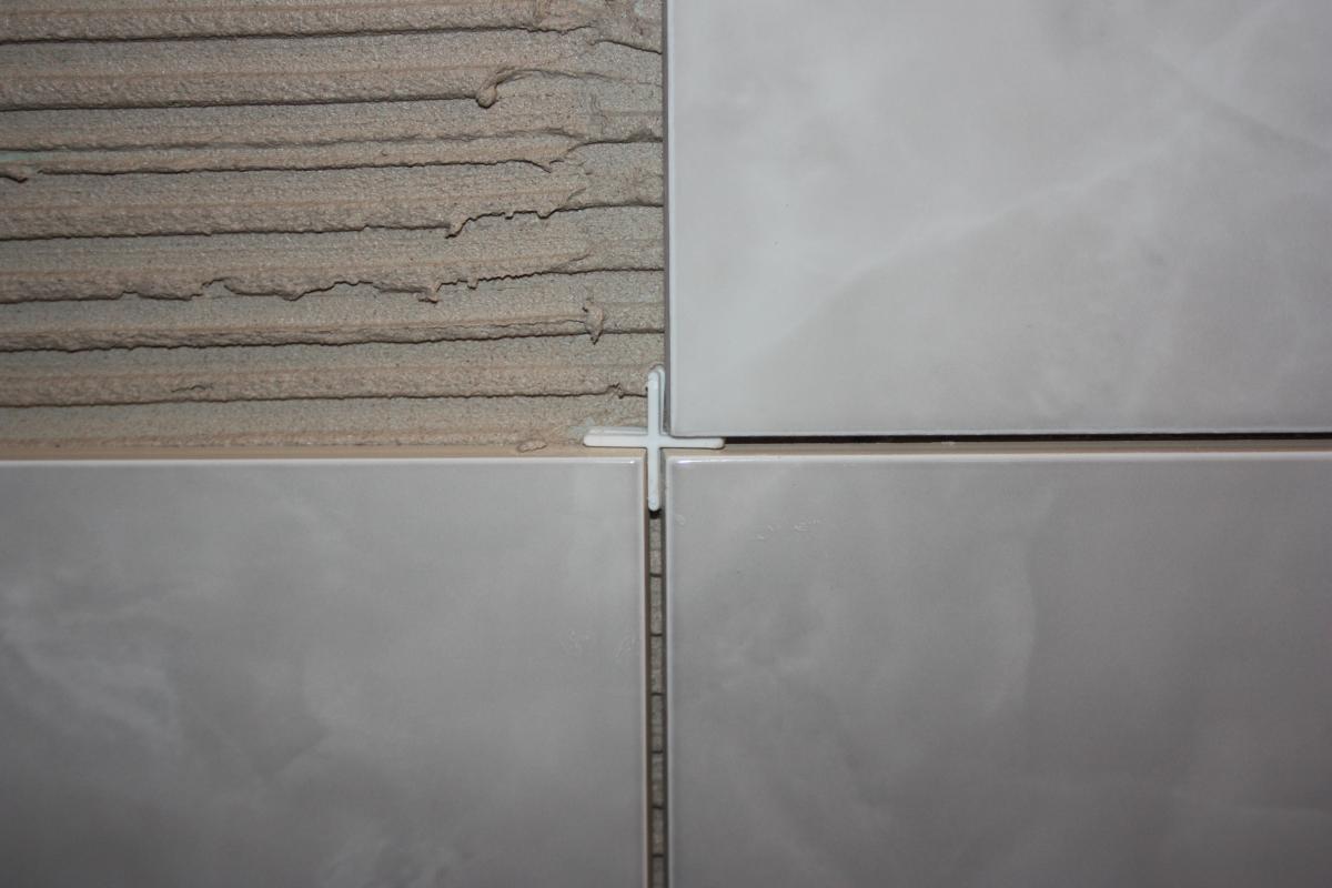

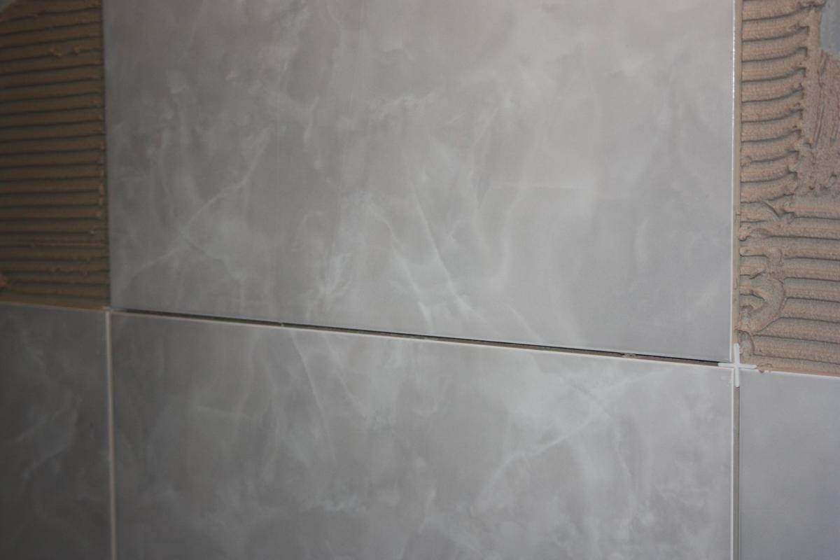

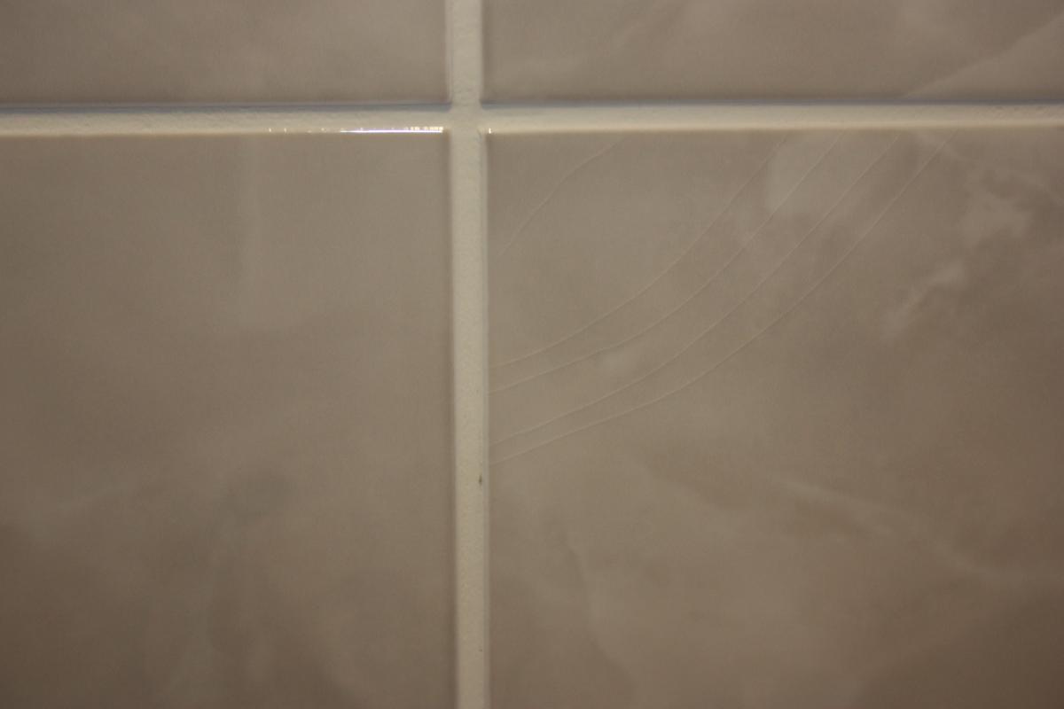

I'm using British Ceramic Tiles (Not my choice) Had an initial problem with somer tiles being 2mm different in size.

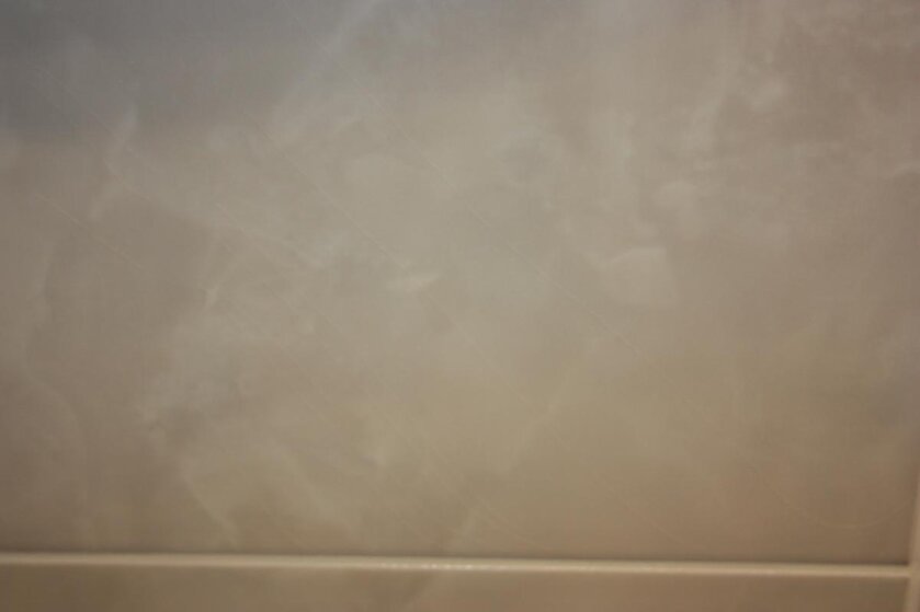

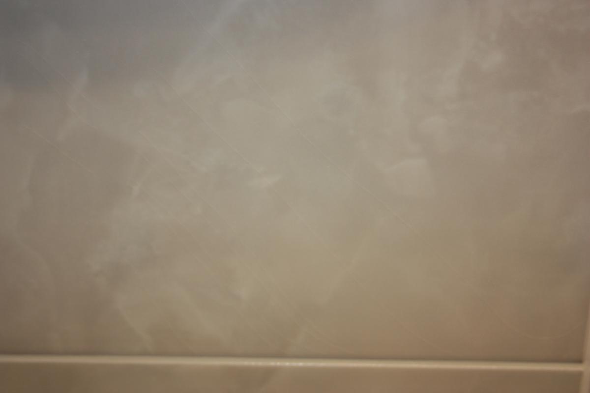

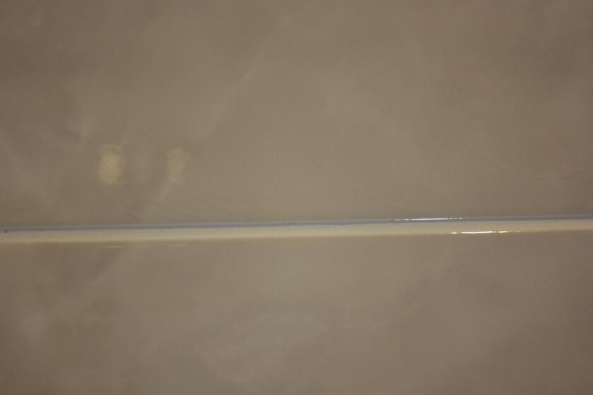

But now Im finding the ones that Iv'e fitted are starting to craze. There were a few in the boxes that were crazed but put these to one side along with the different sized ones.
Problem I now have is that every day Im finding new crazed ones on the wall. Upto 8 at the minute and have changed 4 already.
Not sure what to do? Where do I stand by contacting BCT. Any advice would be appreciated.
Here are a few pics of the ones fitted.
And some of the different sizes

Have already voiced my concerns with my supplier last week when I had to change several tiles due to size difference.
called in to my supplier with 3 tiles I had left outside overnight and all 3 had crazed.
Have a feeling that BCT are going to fob me off saying its temperature related and my fault. I also found that when I drilled 6mm holes in tiles that crazing would appear after a few minutes. Even when I used my 20mm pct hole kit with water same thing happened.
you need to cut two peices of the tile get a bucket put a sponge in it then put the two peices of tile on top one face down one face up now poor water in until the sponge takes in the water but does not float .this will tell you wheather the biscuit is at fault or the glaze .watch witch one causes the crazing
Cheers ray will try that 1 tomorrow.
Personally I think its a manufacturing problem (Thermal shock) would like to find out if any more of these tiles (same batch) have problems.
