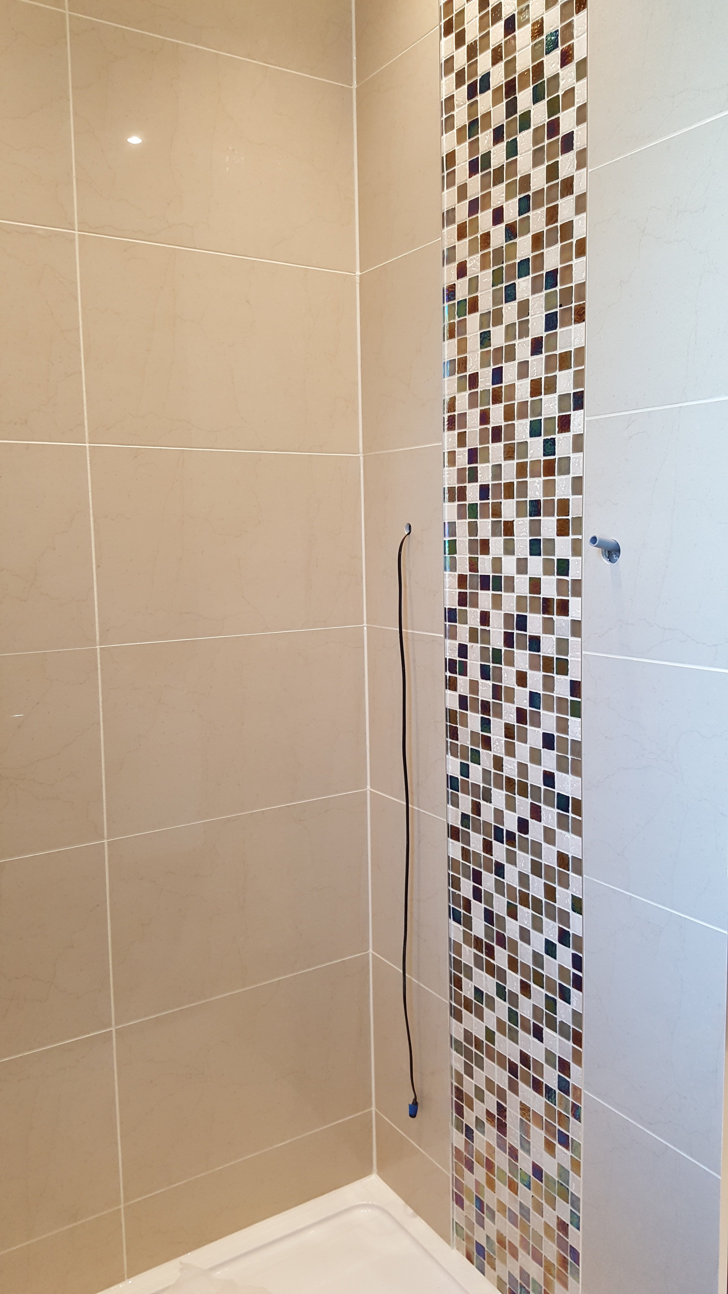

To get over the difference in thickness of the tiles and the mosaics you can introduce a bit of bling to your bathroom. In the above picture I have tiled a shower with a large tile, then a 10mm chrome trim, then the mosaics, then a 10mm chrome trim and then a large tile. The picture may be a little fuzzy as camera flash is bouncing off the chrome trim. The mosaics are recessed by a couple of mm, but the trim hides the sides of the large tile.
