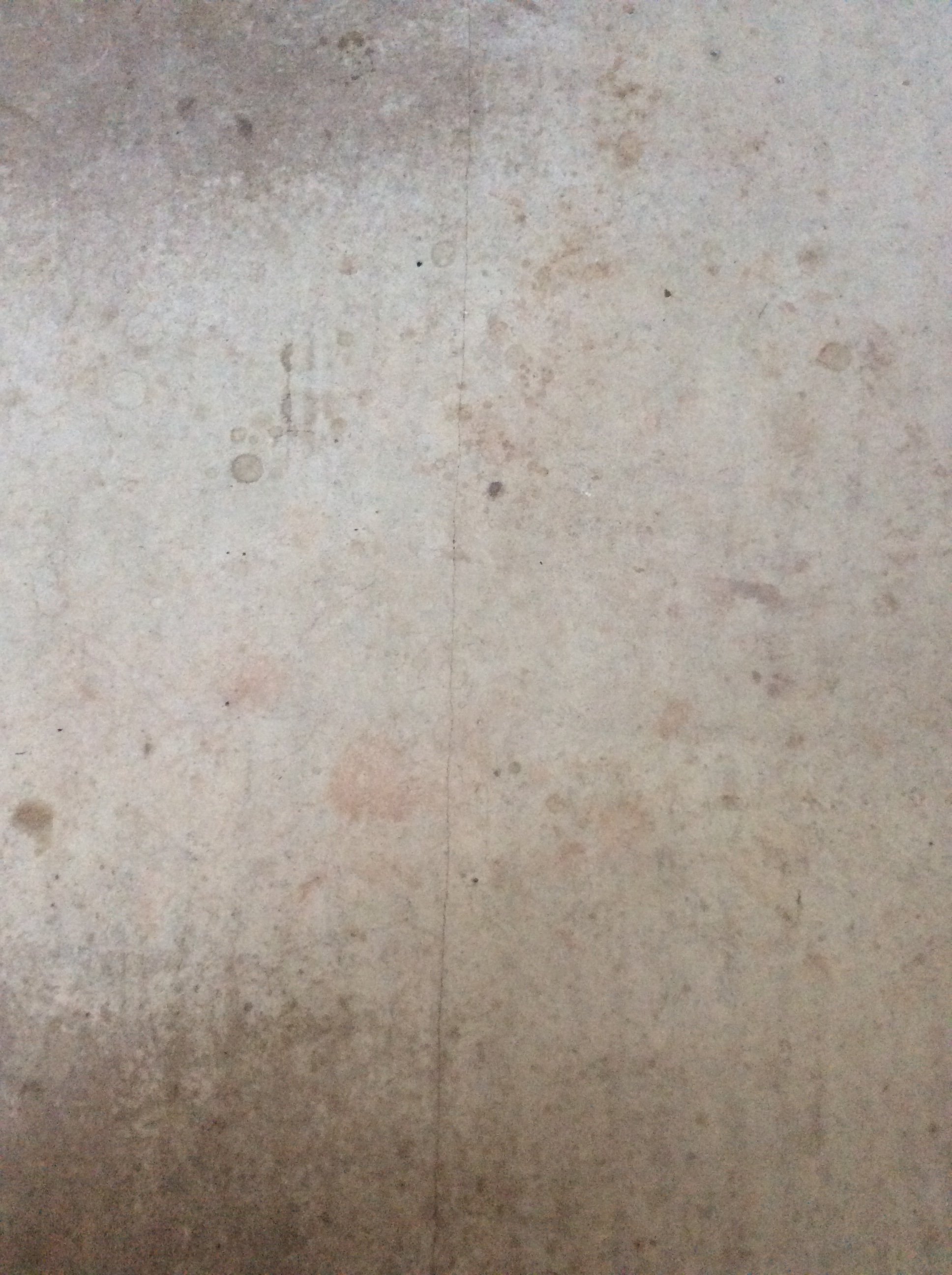

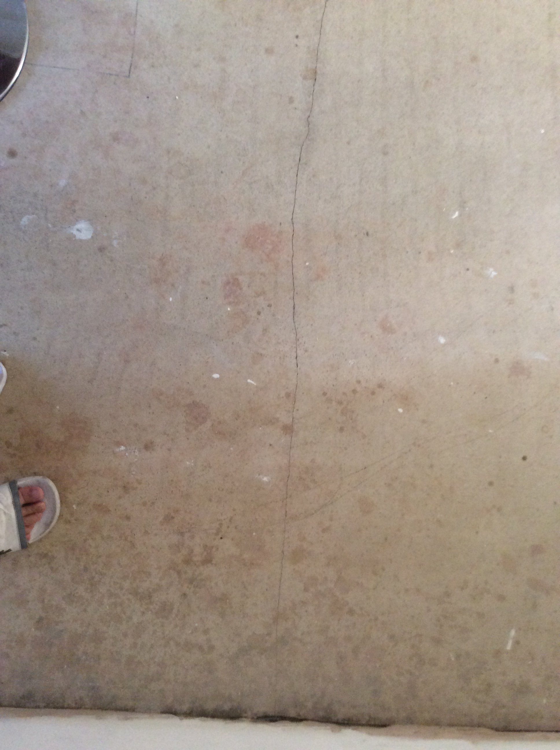

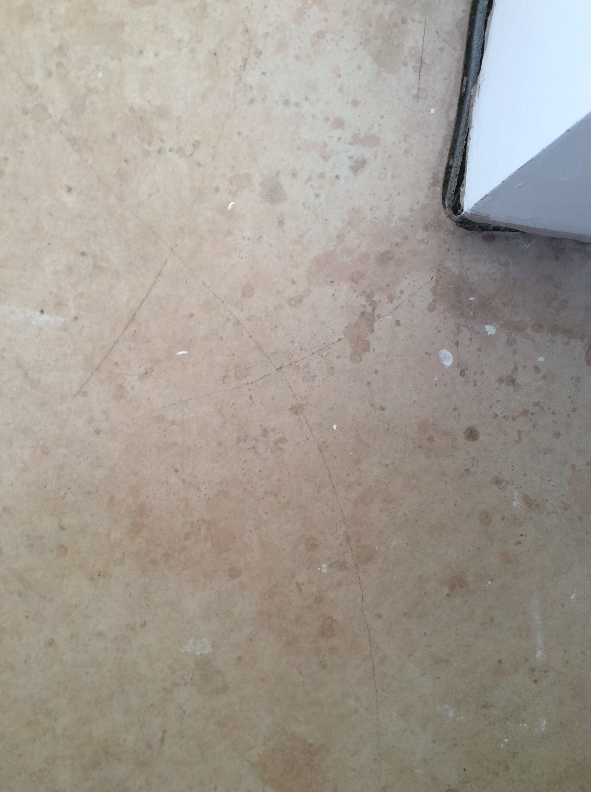

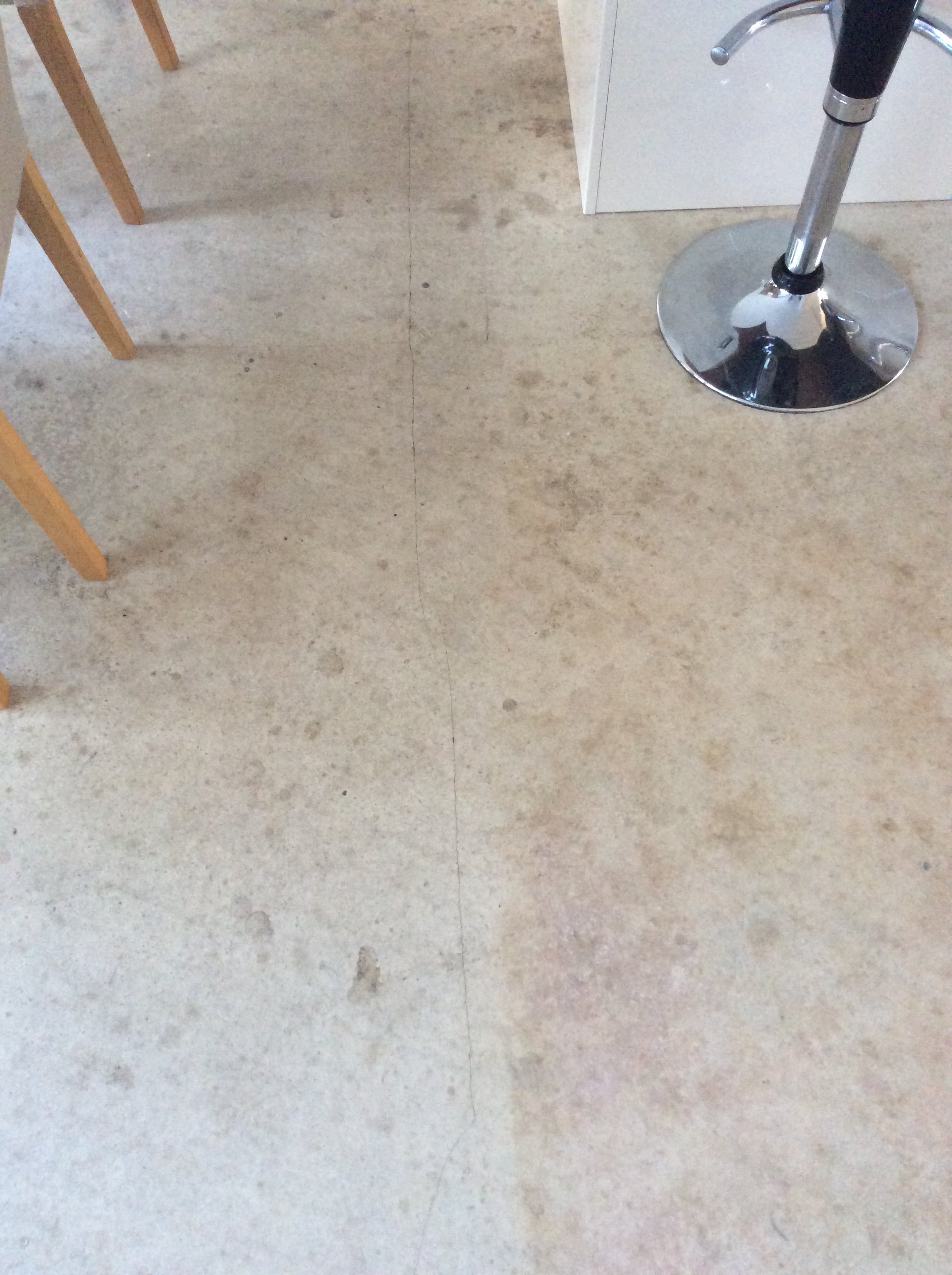

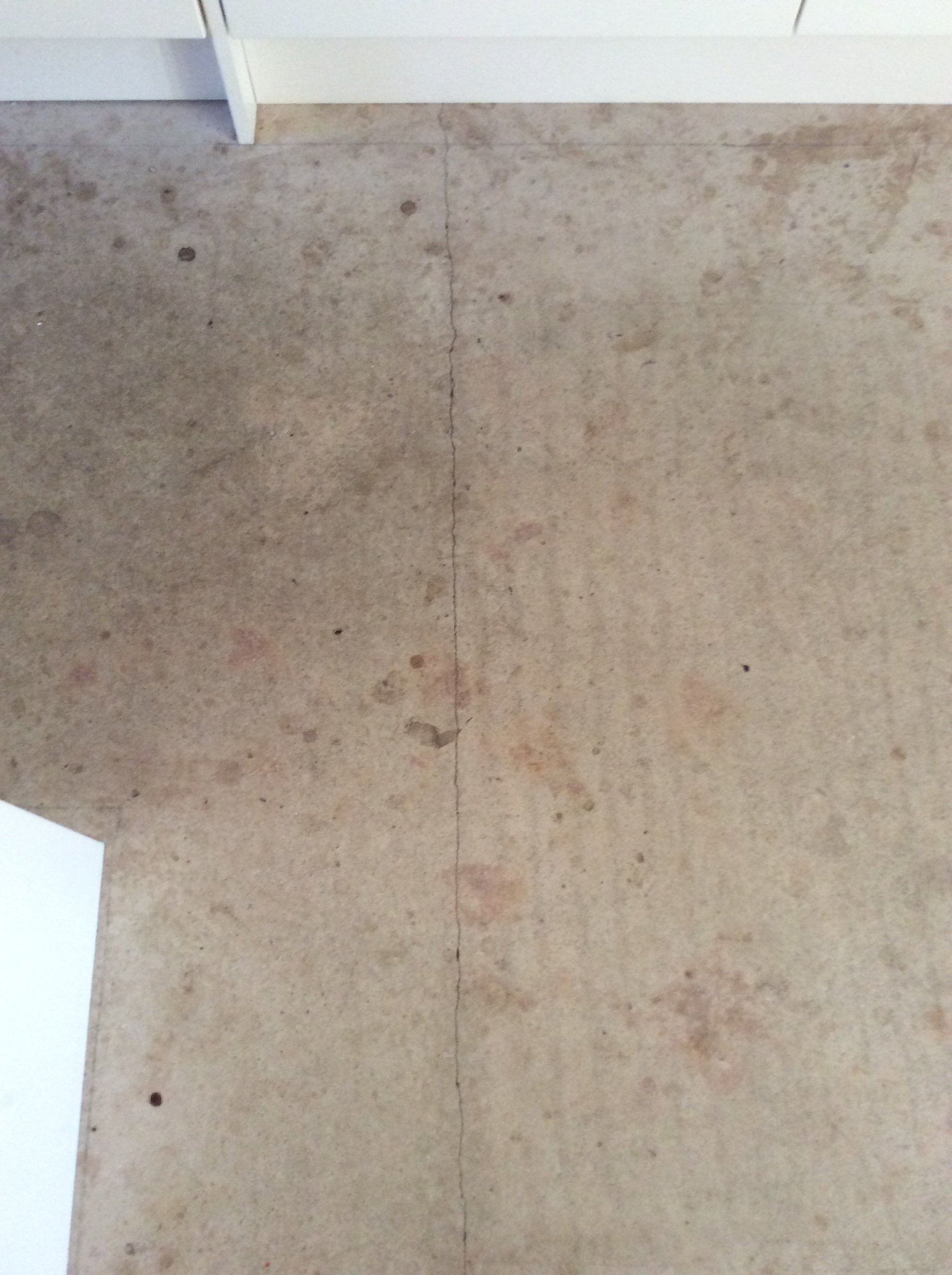

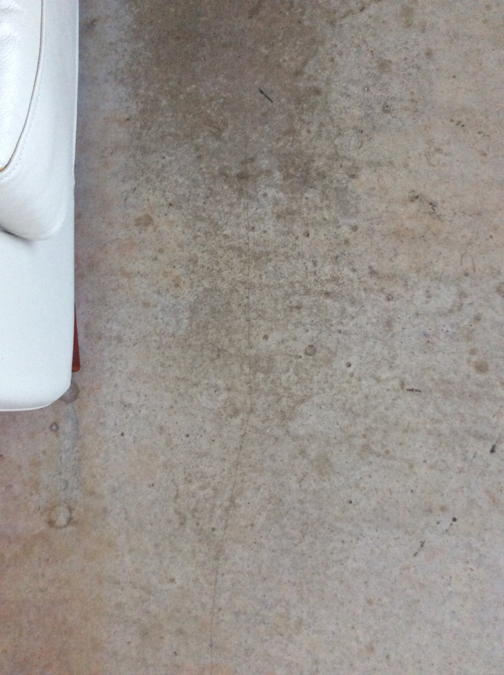

Thanks for the quick reply Wilder, Only reason I'm thinking of going with matting is I've got a couple of cracks in the screed, they are straight above where the ufh clip channels are ,and a couple seem to follow the pipe runs,is this common on this type of screed?also I'm thinking using the matting will let me use setaflex which will give me more open time with adhesive.
Not seen many anyldrite screeds to be honest, ive only seen and tiled one in 30 years!
Went to see it today , 110m2 of porcalain , all different rooms , all tiled up to wall and no skirting :grimacing:looks mint , no cracks ect :sunglasses:
Not sure on the cracking to be honest , on your screed , but prob better be safe than sorry though as well with the matting and use it.:thumbsup:
