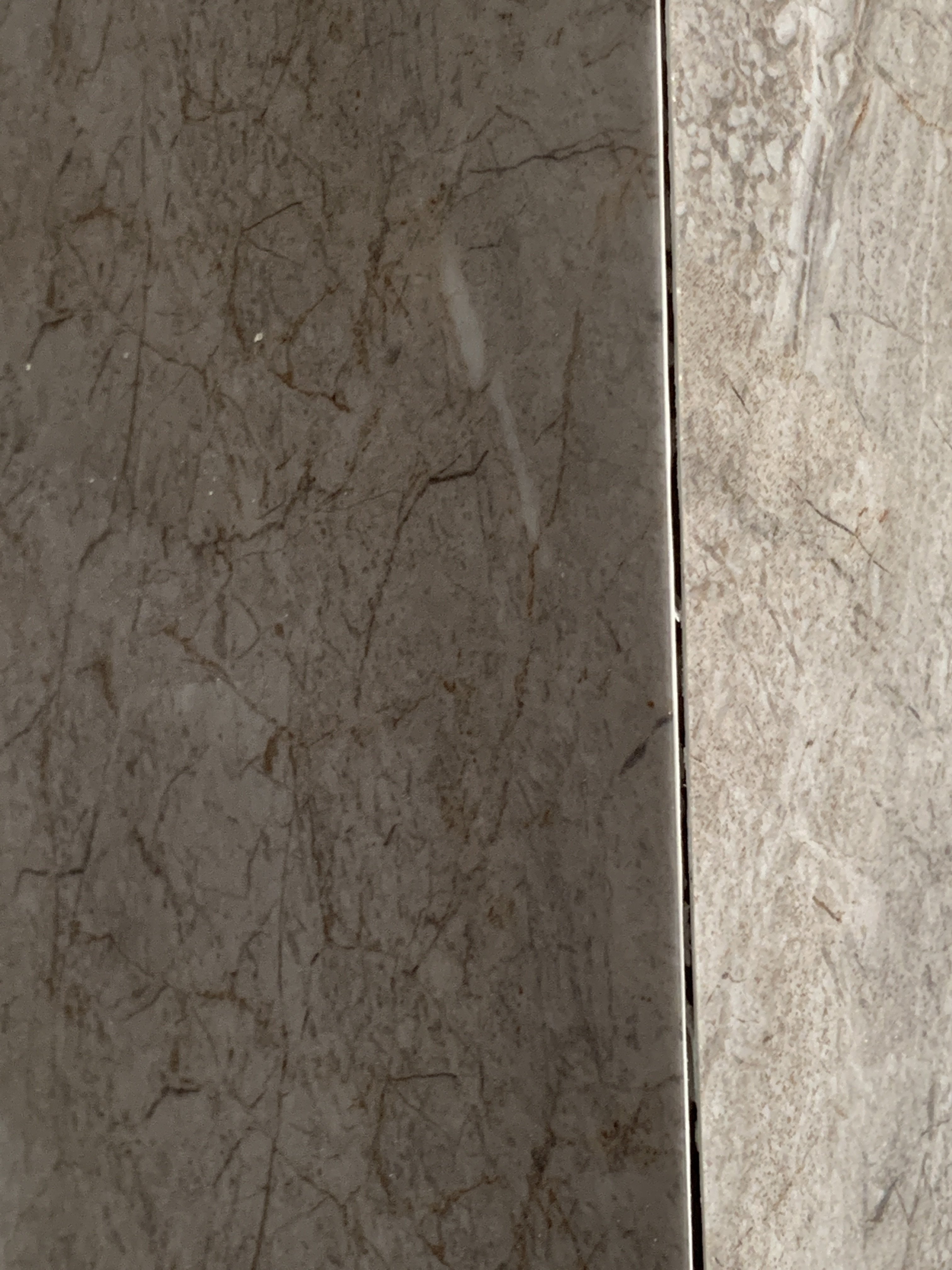

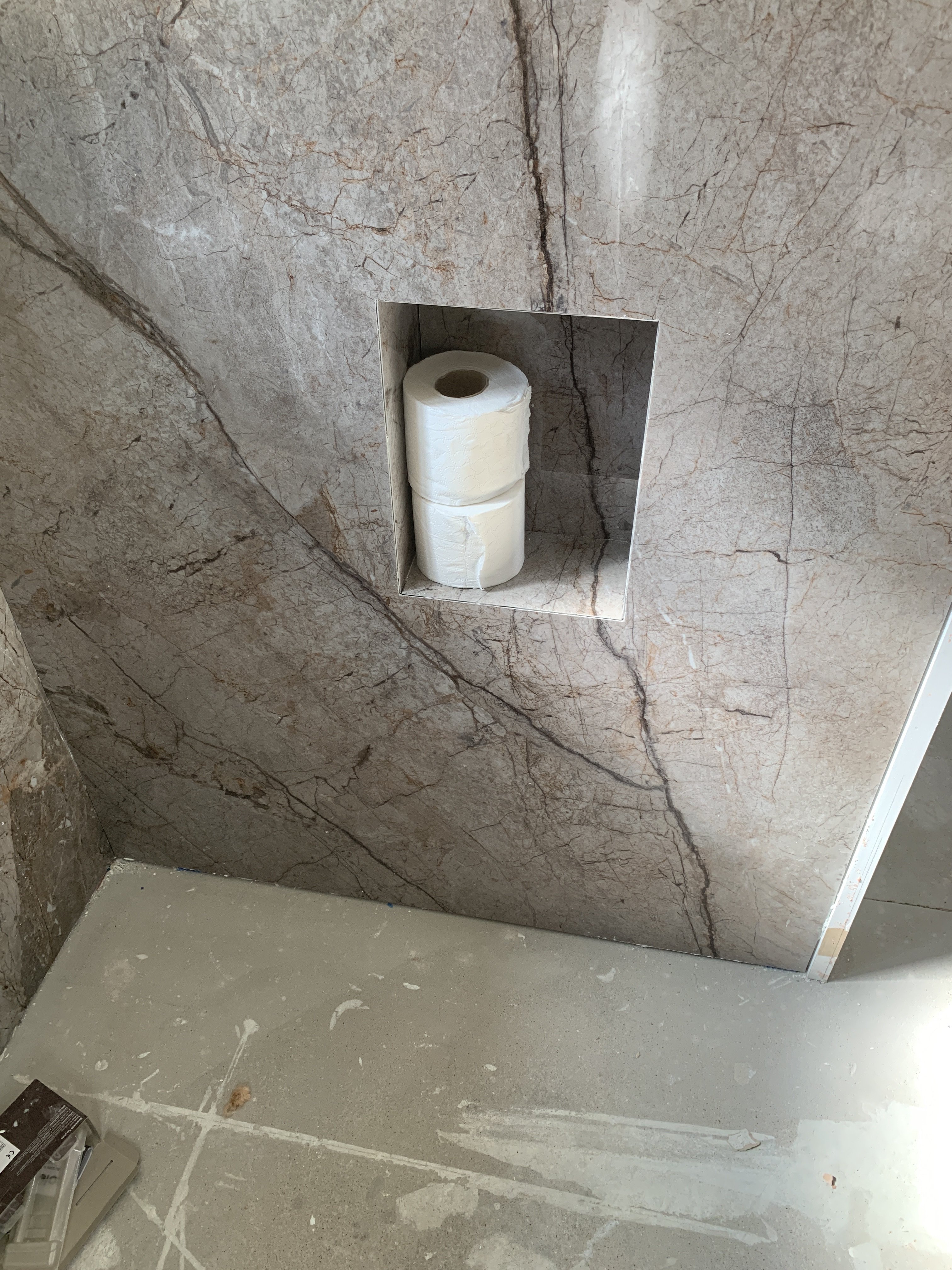

In fact I’ve just finished this, 5 mins ago.
Machines are too heavy and have a lot of vibration, causing the front to sometimes break out.
That edge is less than 1mm, even if photo doesn’t do it justice :tearsofjoy:
Those machines that run on rails, do exactly that, so for example, if you place the rail on the piece and it does not follow the face of the tile exactly, the machine just carries on regardless, following the line of the rail.
This means that if the tile dips in the middle for instance, the cutting or grinding blade will come up thro the front and you won’t even feel it happen. You’ll just see it after the machine passes over it.
By hand, the tools will give feedback and you’ll adjust the angle/line/pressure accordingly.
Machines can’t do that.

One expensive toilet roll holder. :tearsofjoy:
