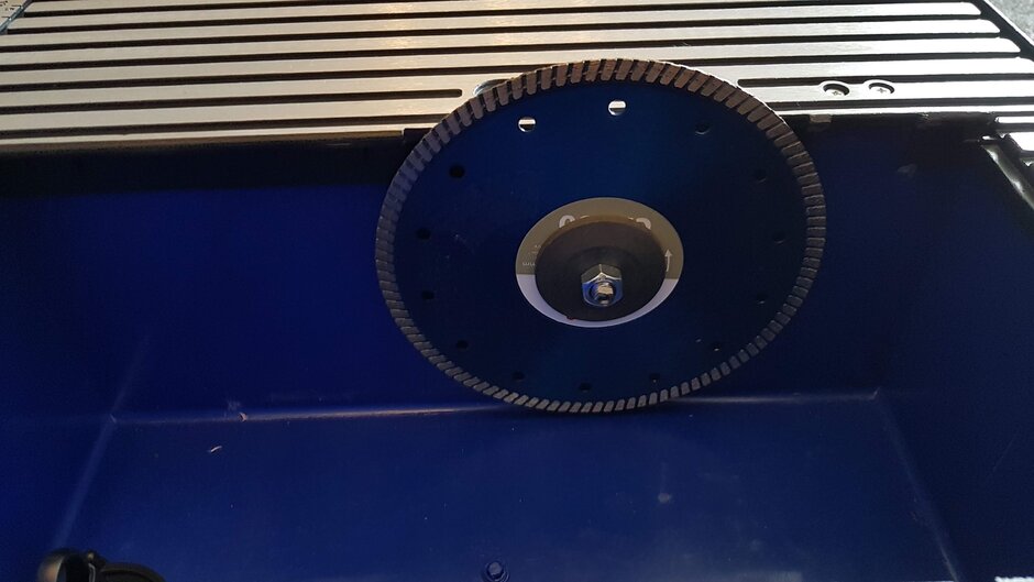

well got the vitrex tile cutter today along with a marcrist blade and everything else i needed.
the 'bits and bob's' cost more than the tiles lol! 😳
and yes it does take both 16mm and 22.2mm discs by reversing the carrier...
