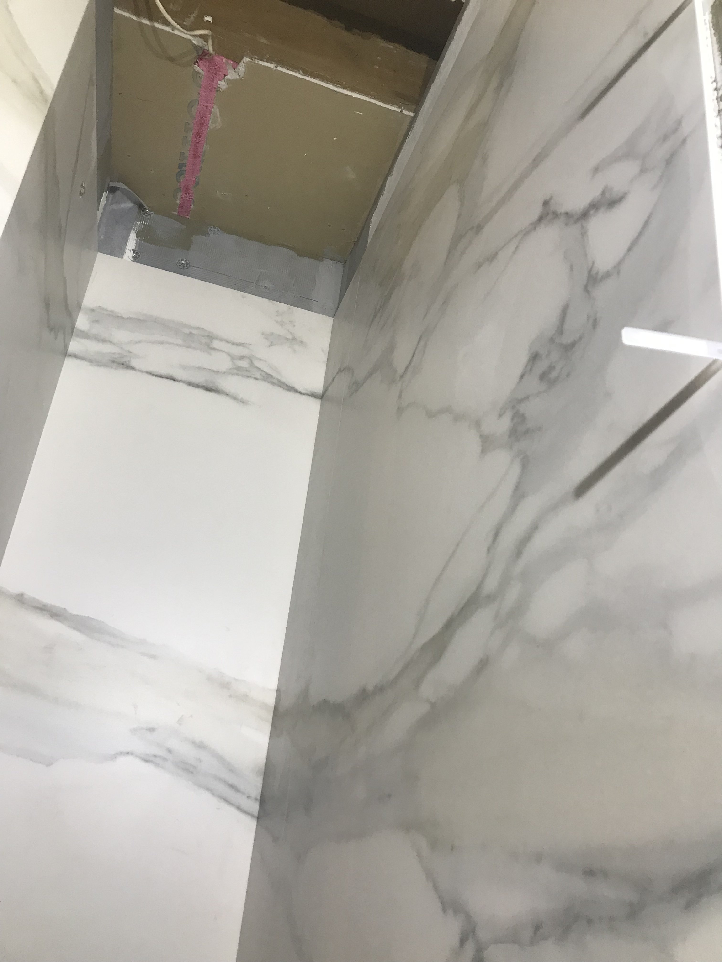

Not really to be honest, everyone strives to have as few joints as possible now, so that it gives the appearance of natural stone slabs.
The images don’t do it real justice because I don’t have a wide enough angle lens.
I’ve tried bolt lenses and it gets too distorted.
This particular client who works in advertising on the design side, had a very specific idea of what he wanted to achieve, and I’m pleased to say he was overjoyed that his vision had been realised.

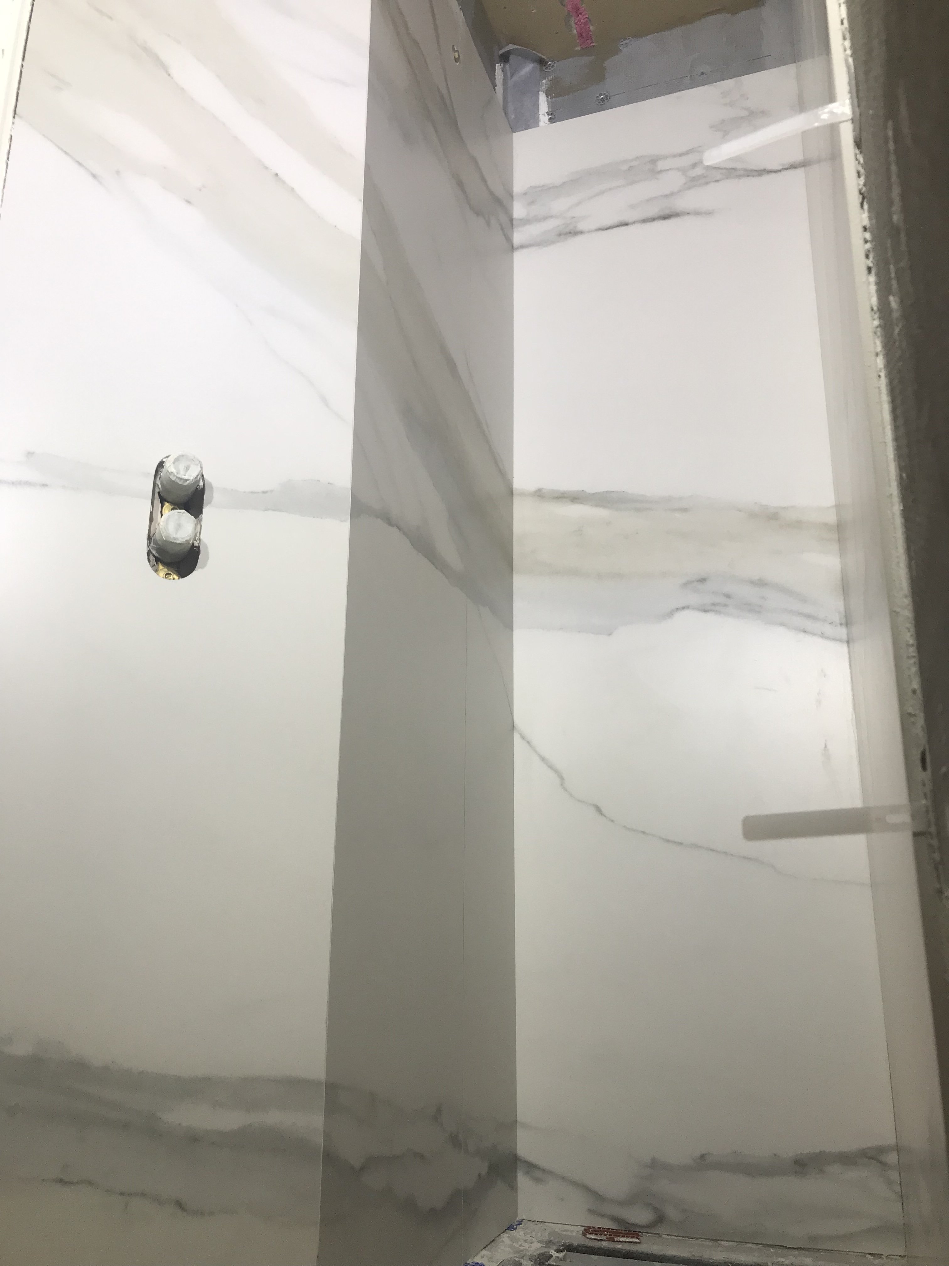

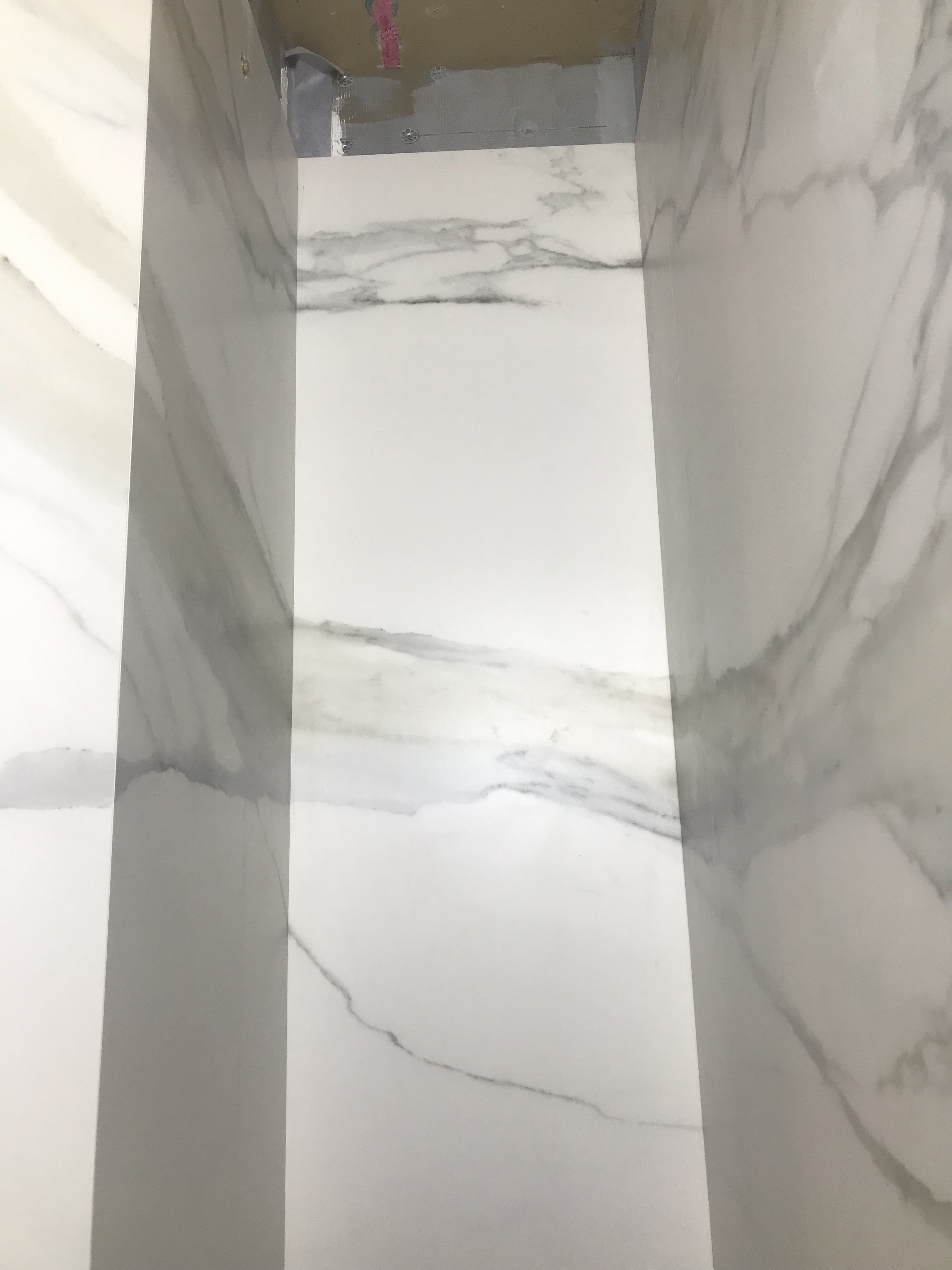

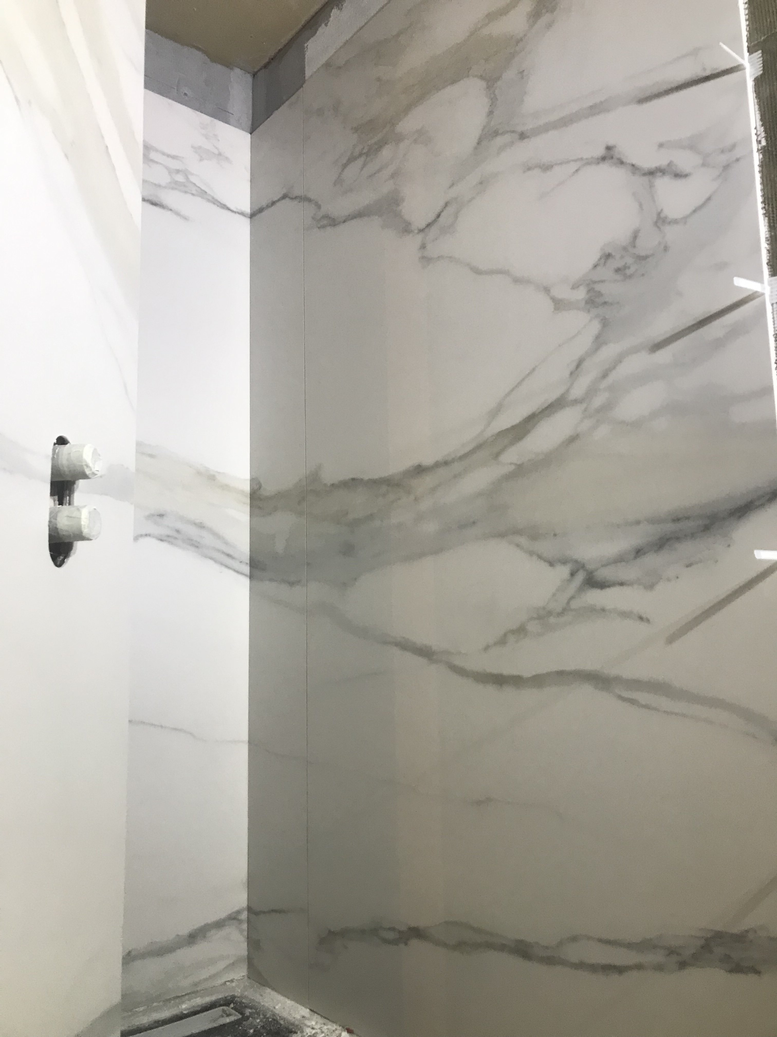

One of the smallest ex-large format projects I’ve undertaken, in more ways than one.
I was asked what the feasibility was of installing a 4 tile string of 2.4 x 1.2 x 6mm thin tile to a rather compact shower room.
I went along to the property, and quickly understood everyone’s point of view, general consensus was it wasn’t possible because of access.
But the client wants what the client wants.
My proposed solution was to dismantle a shower wall that backed in to the bedroom.
Bring the largest two pieces thro the wall in the upright position, and then reinstate and waterproof the shower.
The rest were going to be reduced in size sufficiently to be passed through the door.
One other issue that was to become a real thorn in my side was that one of the four pieces delivered, was incorrect, and not part of the string ordered.
And after being promised it would only take a week to replace, I’m still waiting, 10 days later.
Anyway after getting assurances from all concerned that if I was to begin the install and the missing piece turned out to be incompatible, I was not to be held responsible for proceeding without it. (Even that took almost a week to get in place)
1st image, just left of centre shows the missing shower wall.
Tiles are 2.4 x 1.2 x 6mm thin tile by Florim.
View attachment 102622 View attachment 102623 View attachment 102624 View attachment 102625 View attachment 102626 View attachment 102627 View attachment 102628
