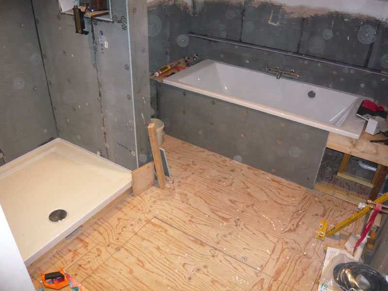

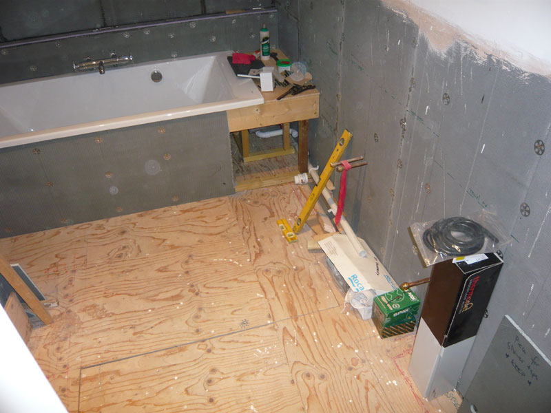

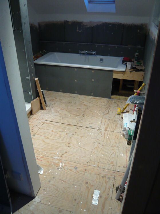

Hi everyone - I've boarded out the walls and fitted the shower tray and bath.
I'm keen to get the floor tiled now and was wondering what the best way was.
I've got 12mm pale marble tiles to go down.
The substrate is 18mm t&g flooring ply (I'm planning on fixing it down a bit better as I had to lift sections for pipe work - planning on adding extra noggins where I can and filling any gaps with ply shims and polyurethane glue).
I've bought some Thermanet UFH - it's 150W matting.
So the question is - how should I prepare the floor and add the UFH ready for tiling?
I have been using Marmox for the walls.
Should I add a layer of Marmox over the ply? If so what glue is good and should I screw down with board washers? Is 6mm board ok?
I have Ditra matt left over from the kitchen floor - enough for the bathroom.
I have Ardex x77W for the final marble tile lay.
Is this a good idea ? : ply -> glue/screw -> 6mm Marmox -> ufh glued down -> slc -> ditra -> x77w -> marble

Tile the walls first, as you could easily damage the floor tiles.
Then lay the floor as you suggest, if the Marmox is glued and screwed well then i wouldn't bother using the Ditra, it's only a small area.
If you have the Ditra then I'd certainly use it for Marble. With the thermal movement caused by the UFH on a wood substrate the uncoupling properties can only be of benefit to the longevity of the floor.
ooops Timeless is bang on, i missed the marble part, yep use the ditra, and back butter the marble as they can shade from the ridges from the notched trowel.
Yes, as with Bugs & John above, 6mm Marmox over ply before UFH at 150w/m2-160w/m2.
Powdered flexible tile adhesive under Marmox.
Powdered flexible self-levelling compound over UFH, then Tiling and/or Powdered flexible tile adhesive.
