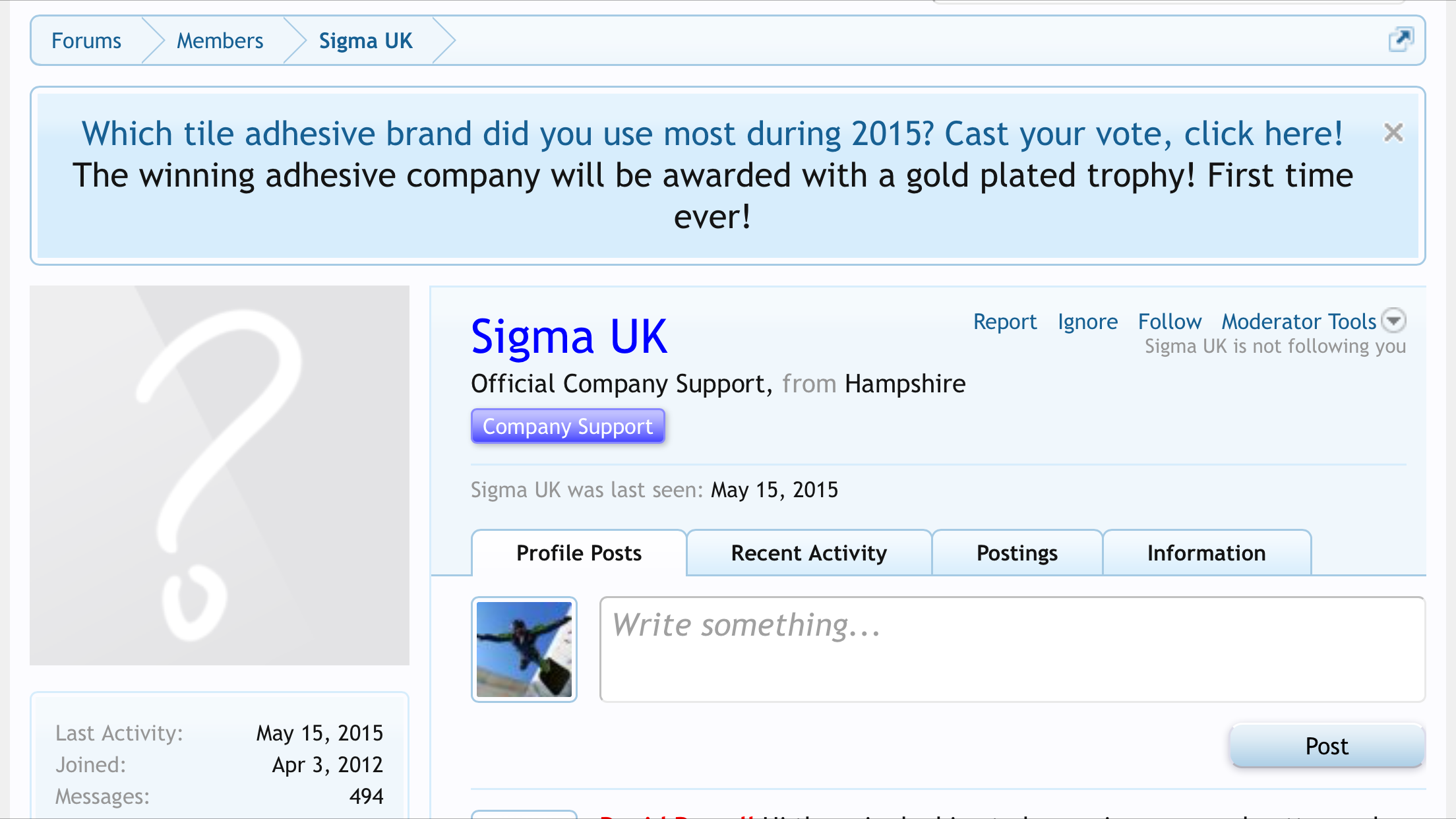

@Sigma UK are still registered, not been on since May 2015 tho.
