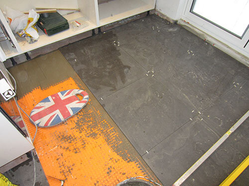

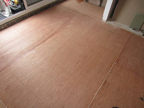

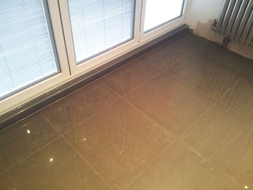

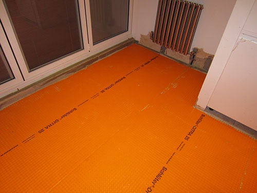

because Silicon will allow the live boards to stretch and shrink a bit.......filling the expansion joint with a solid material like adhesive will remove its ability to expand.....
Imo......this is the way to go....
lay ply with a 5mm expansion around the perimiter of the room as well as between each board and stagger the joints of the boards.....
Fill the expansion joints with an expandable material i.e Silicon......
lay a suitable decopling membrane......
fill the voids in the decoupler and tile AT THE SAME TIME!
have a cuppa!
