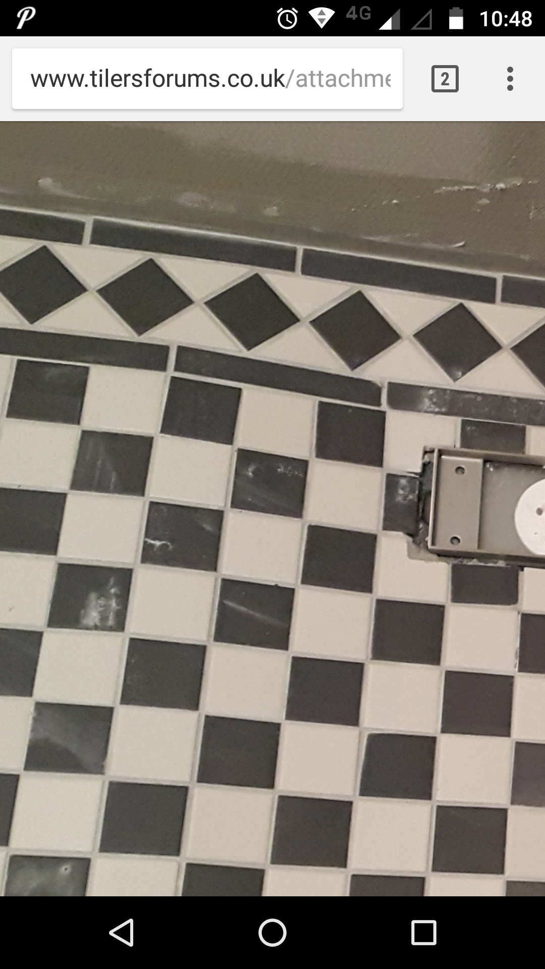

tiler made a mistake tiling a wetroom tray
Am I the only one that is wondering how it looks with the SS grate put on?
Whilst the cuts around the frame are iffy, to say the least, how far out is it with the grate on???

You can't tile a wet room without the drain in place , no one can tell you whether damage will occur trying to make good , get your money back and start again
Surely a professional wouldn't walk away from a wavy floor like this and say "right that's perfect I'll go home now".
What's the sudden ramp all about lol
The ramp is where the flat floor becomes wet room tray. Personally I don't think the tiles are suitable for this job
