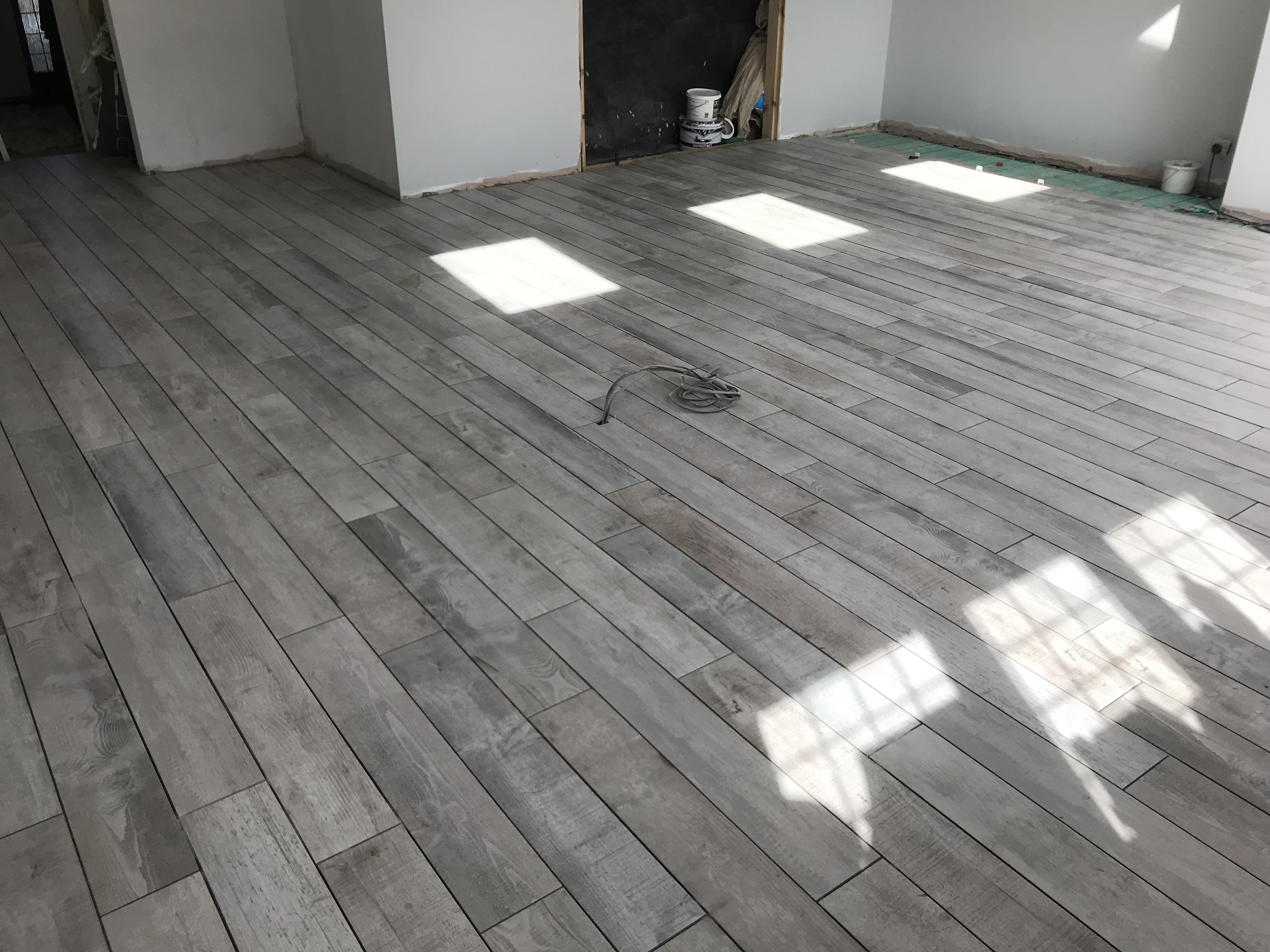

45m2 textured plank floor (900 x150) grouted the othe week in mid grey, took all morning though, half a bag at a time , 2 bags .🙂

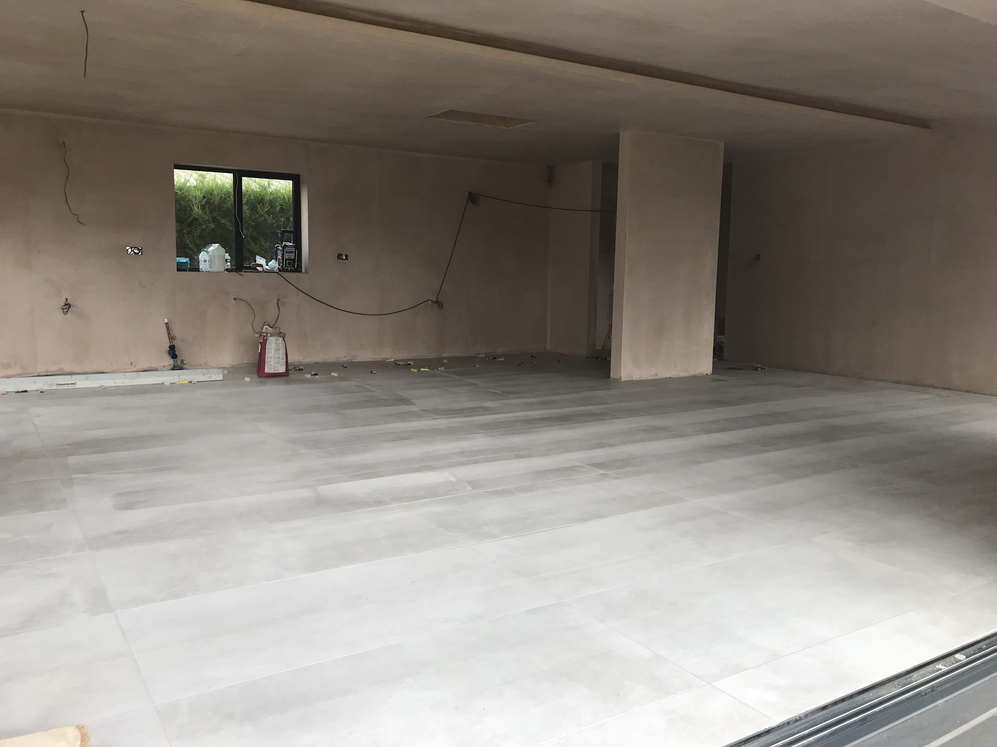

1200 x 600,about 70m2 a hour and half to grout today , 1 bag , half bag mix at a time, very hot with 4 sets of doors and a window.
Its hard graft in this heat , but the grout is brilliant stuff
