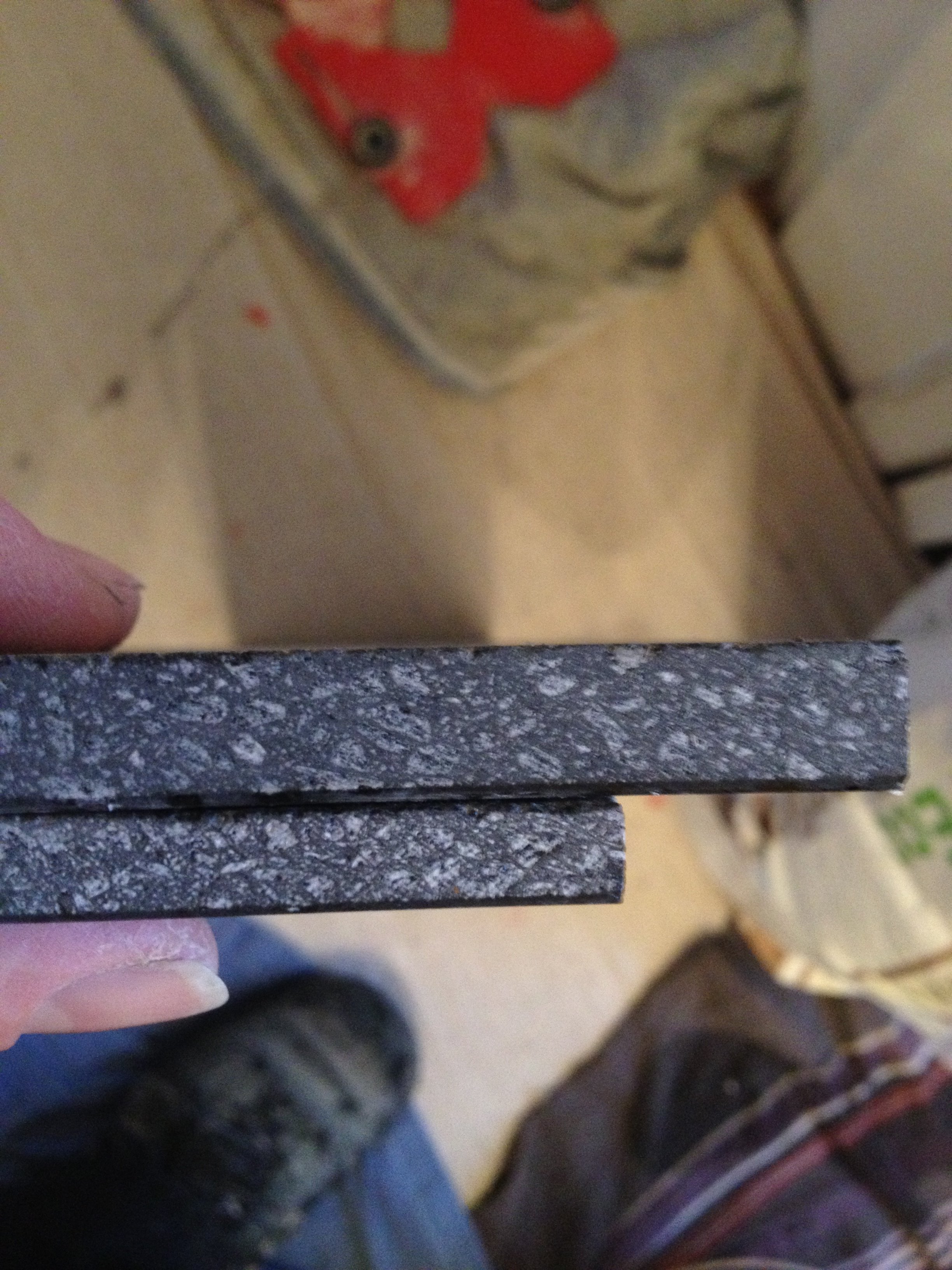

All I would say is don't buy the cheapest quartz, but from a physical shop, then you have somewhere to go back etc...and ask where ever you purchase them from, are they ok for underfloor heating (even though you perhaps are not having underfloor heating) and the thickness of the quartz should be between 10-12mm in thickness

Ps pic of some dodgy quartz

Ps pic of some dodgy quartzView attachment 79710
Thanks for the advice.
The tiles I was planning on using are from Tile Mountain which is a decent size physical shop as well as an internet retailer, I think they may advertise on here. I have been to the shop mysef to pick up some adhesive and I saw the quartz tiles while I was there. They looked good but in all honesty I was more interested in the finish that any variation in thickness. I could check this if and when I go to pick up the tiles. In their description they do say that they are suitable for underfloor heating which I wont be having. That only leaves the price, they are the cheapest around. There are several user reviews on their site all praising the tiles although it is difficult to determine whether this praise is directed at the appearance of sample pieces or fitted tiles. I have written to them and asked them to clarify the recommended adhesive.
