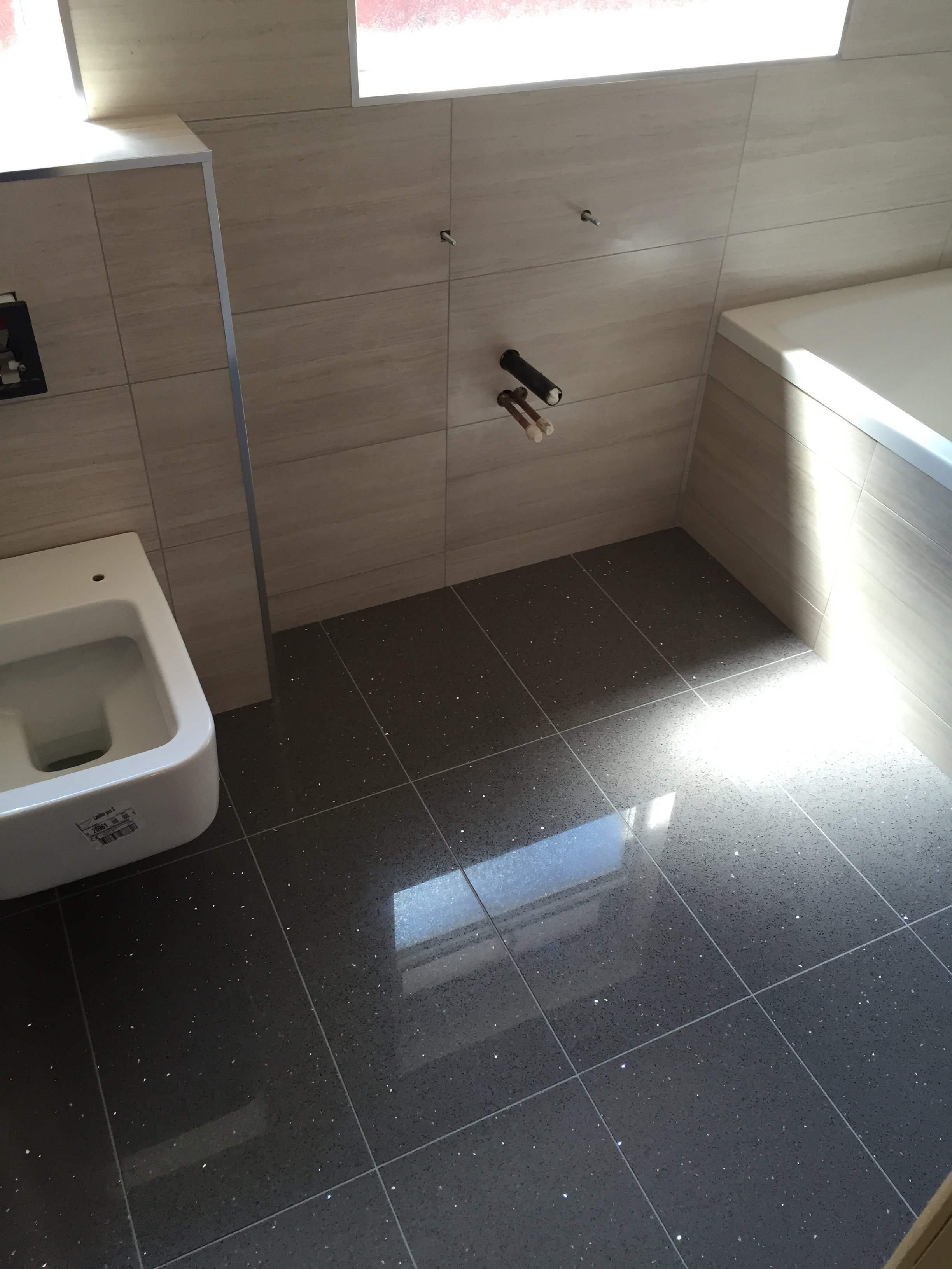

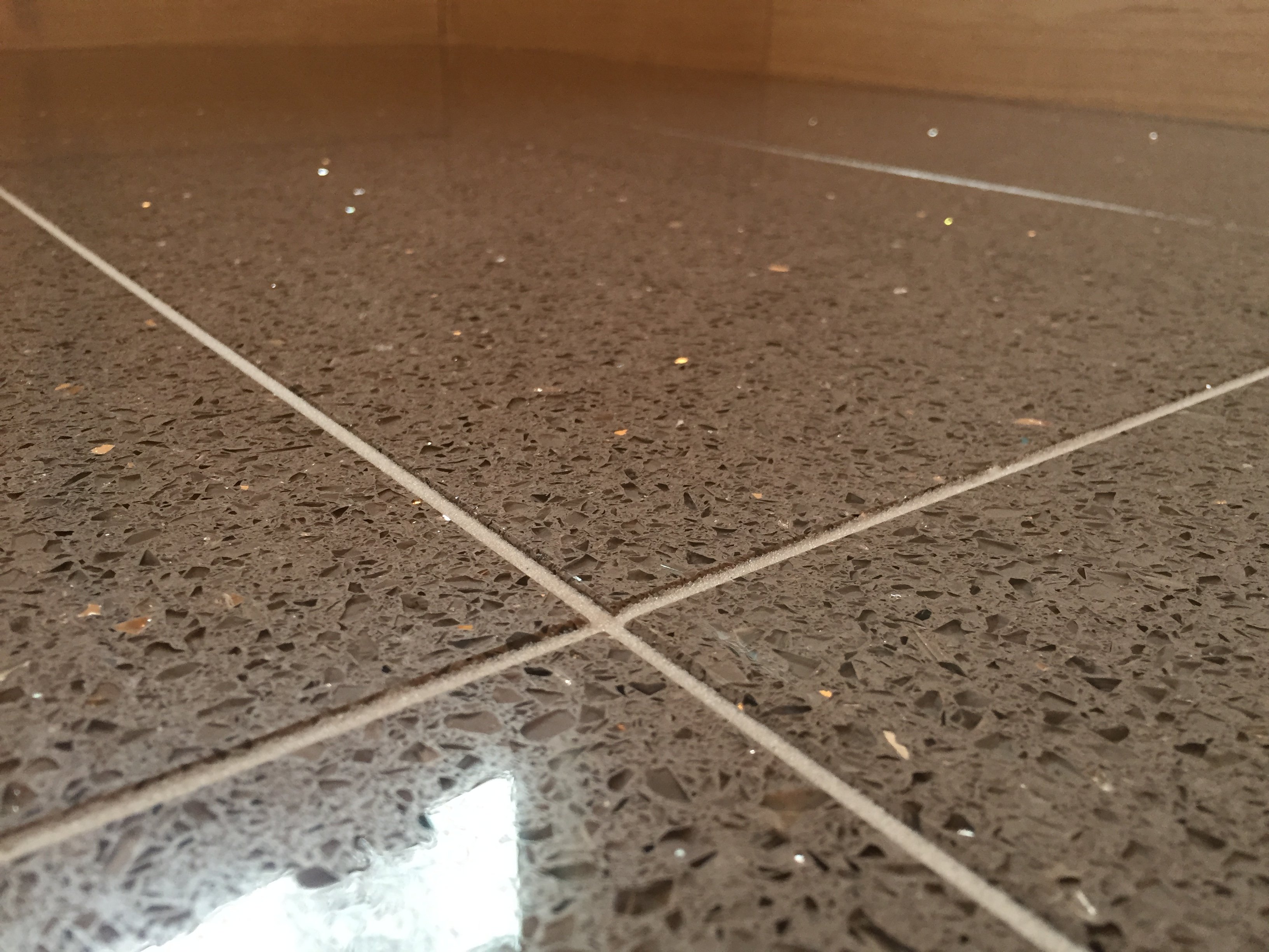

Your quartz sound fine to me, and if they have been tested, that's a bonus, as far as fixing the quartz tiles, I would go along with whoever you employ to do the job, once they have seen them, seen the job etc, ( and probably are on this Fourum site) and are happy to take on the job using what they feel confident, method of tiling etc, products they frequently use...and of course there guarantee.... You will be fine!!
All the best and enjoy your new bathroom
Did a job this year with these tile, Gulf Stone, if the same as you are having, very good tile. They recommended and supplied karaquick. Only problem was, written on the box of these tiles it says ' only fix using latex based adhesive ' (or words to that affect)
So what do you do?
Listen to the shops advice or listen to the tile manufacturers advice?
Me, I follow the advice of the tile manufacturer.
Thanks for the vote of confidence on the tiles 😉
I couldn't tell good ones from bad ones to be honest so an ok from the pros inspires a bit of confidence.
