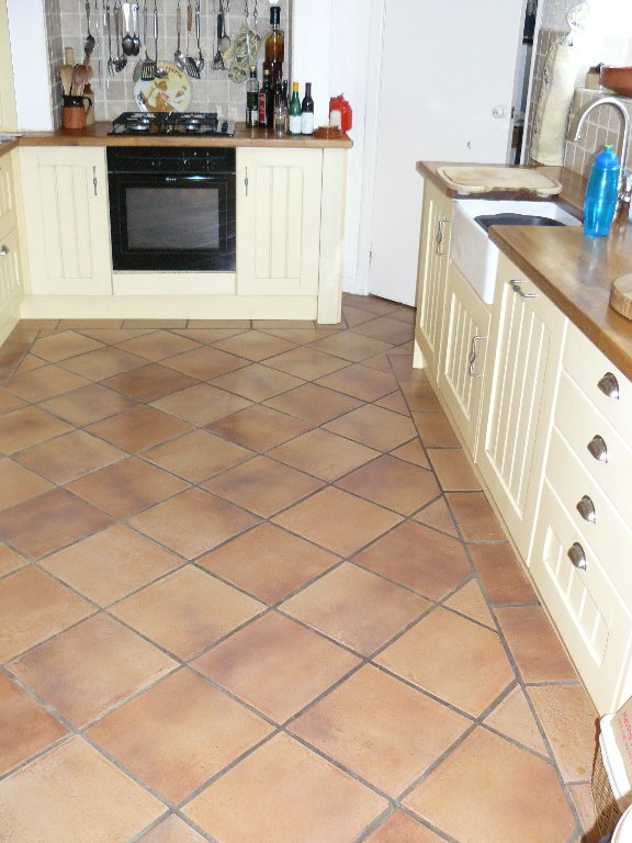

Anything I finish Terracotta with, must have a remover that will take it off. Double Boiled Linseed has always served me well, and can be thinned with genuine real Turpentine will post a pic in a minute also LTP antique oil and finished with antique brown briwax
