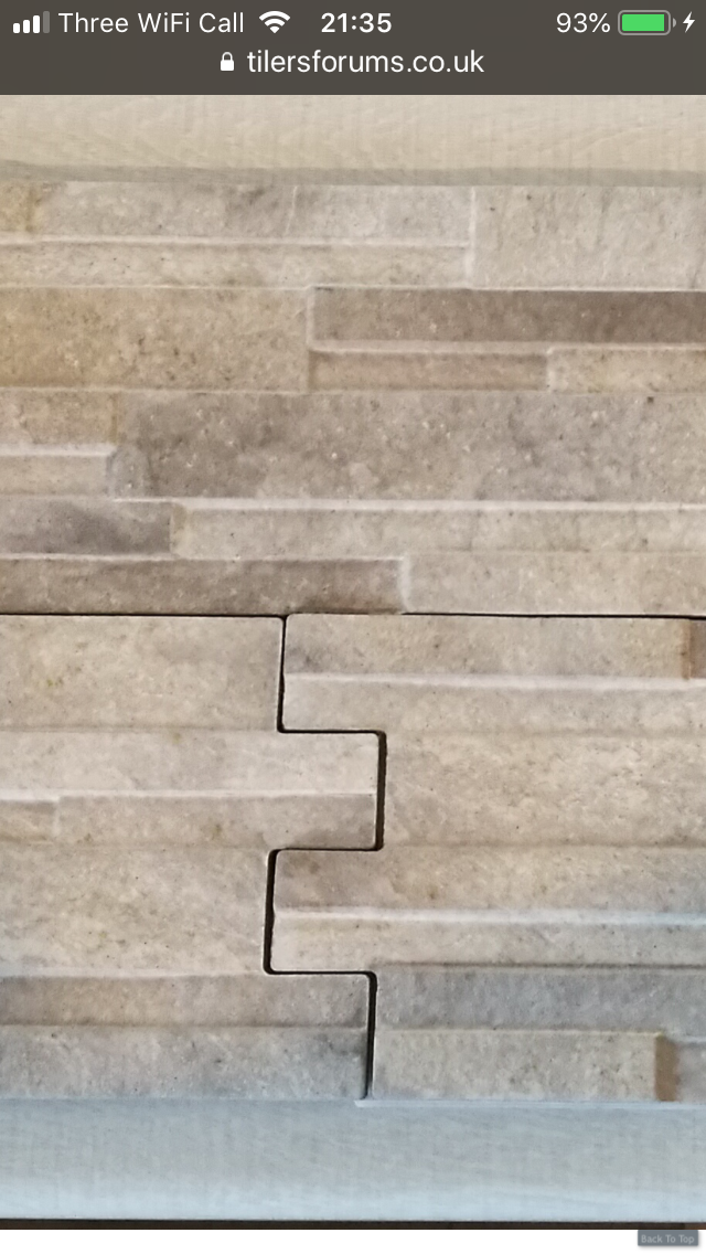

I am doing a splashback in my own home and have managed to get some Wickes porcelain Splitface tiles. Won't be the best quality but we like the look of them.
Do the tiles have to be all laid the same way so the pattern on the tiles is the same or do they need flipped 180 each time so the pattern is not the same, or does it not matter?
I have laid out 4 tiles just to show.
Should they be laid in brick effect? Only going 2 high in utility room and about 2.5 high in kitchen up to cabinets.

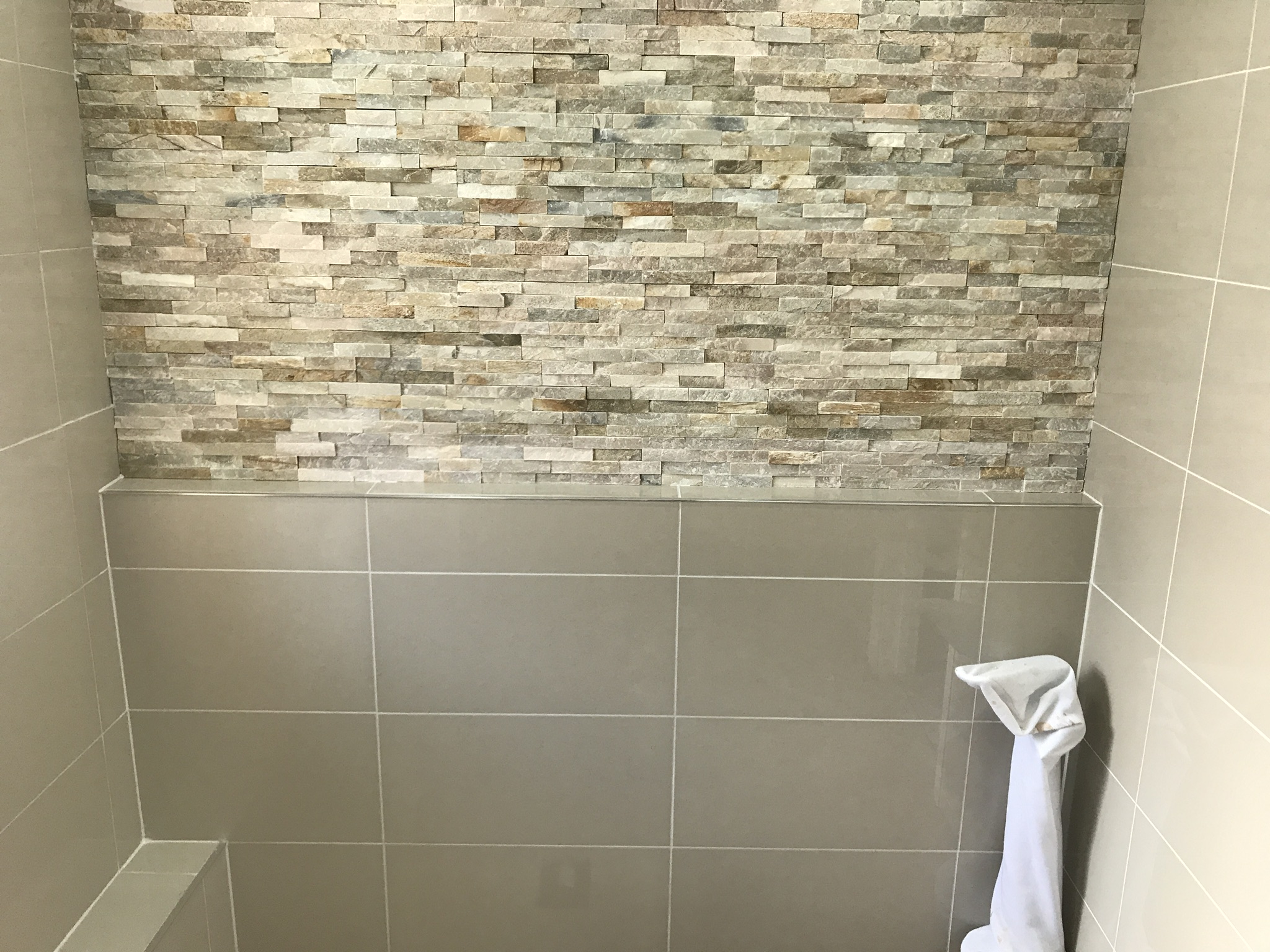

Fit them all the same way, and stagger the joints, last time I fitted them I just filled the joint's with my finger...
Maybe not the exact tile you got, but you get the picture...
Bill
split face quartz/stone are different than split face fake ones made from porcelain/ceramic.....
the fake ones, like you have got, need grouting on my opinion.
They can be fixed in any order you want.

so if I'm doing internal corners, would you continue the pattern round the corner or is it different using Splitface due to the variation in heights?
