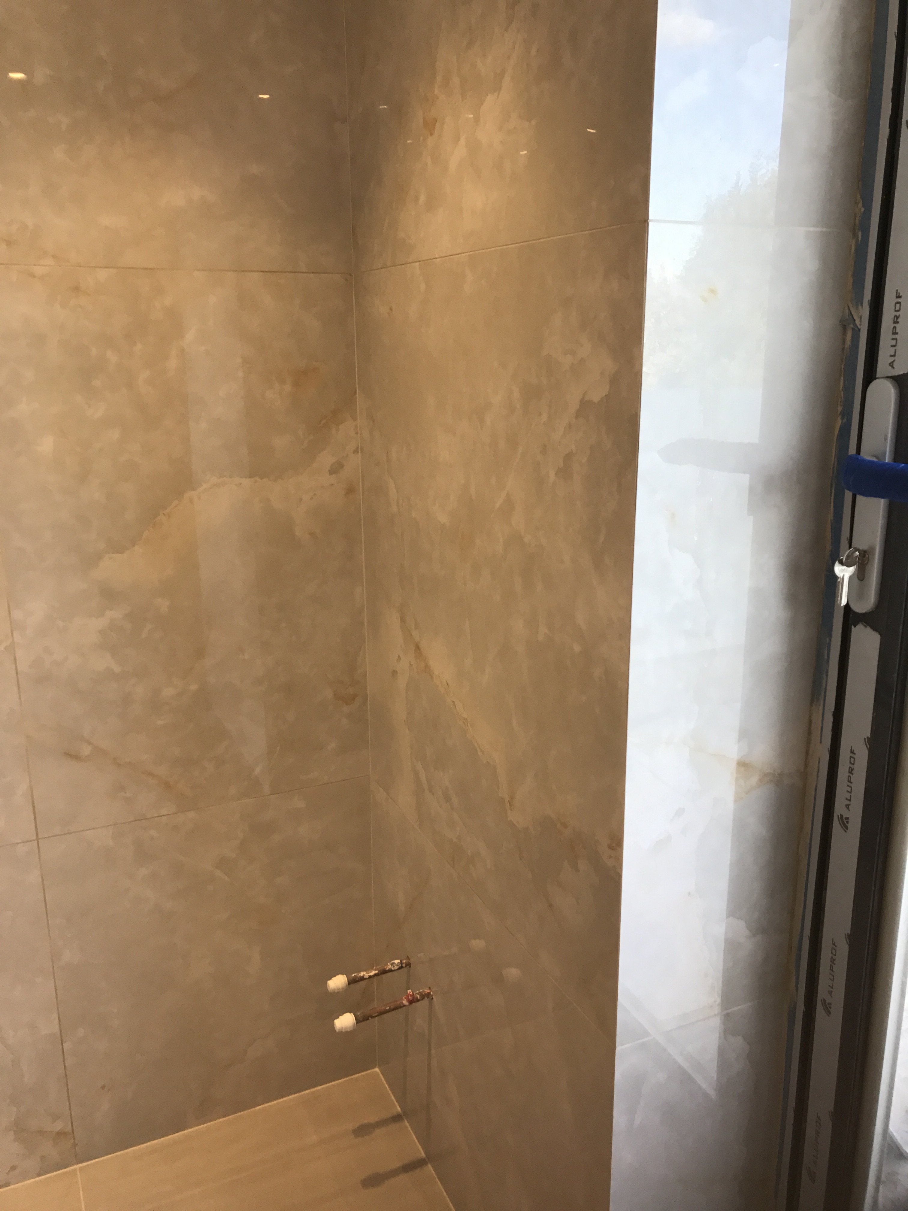

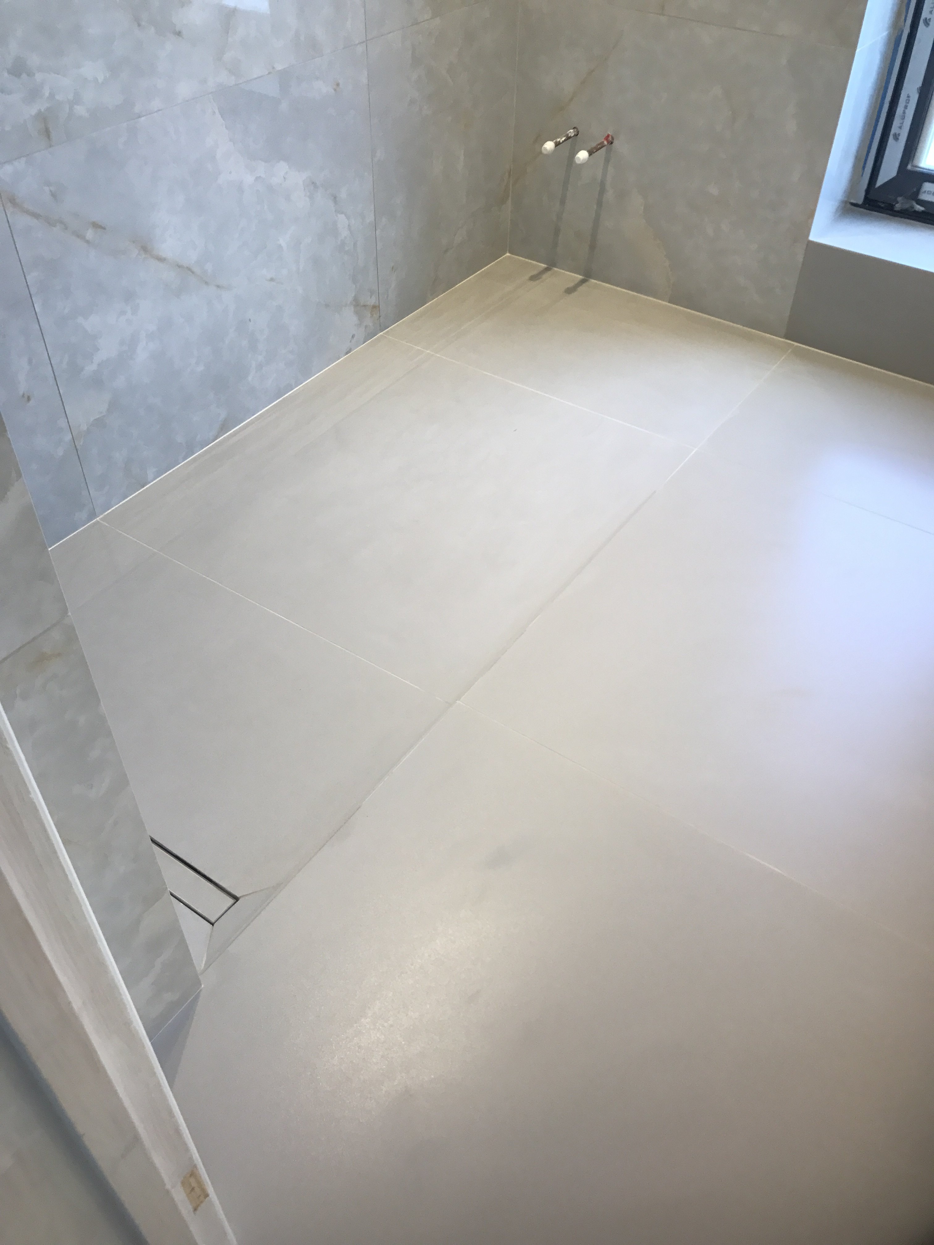

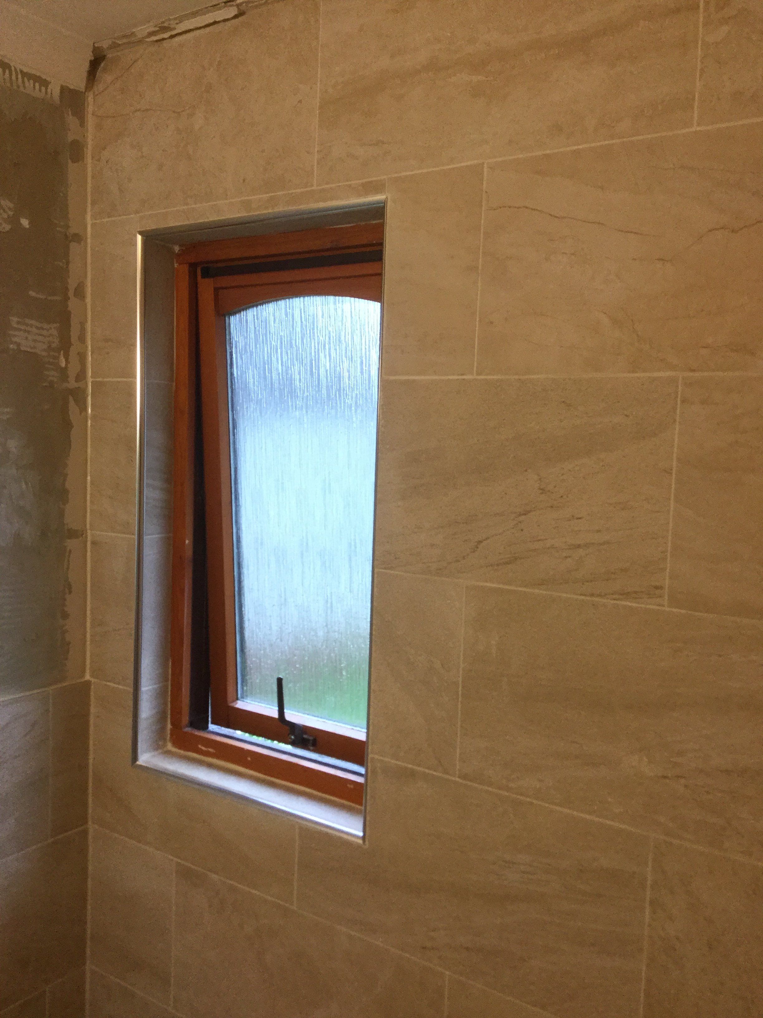

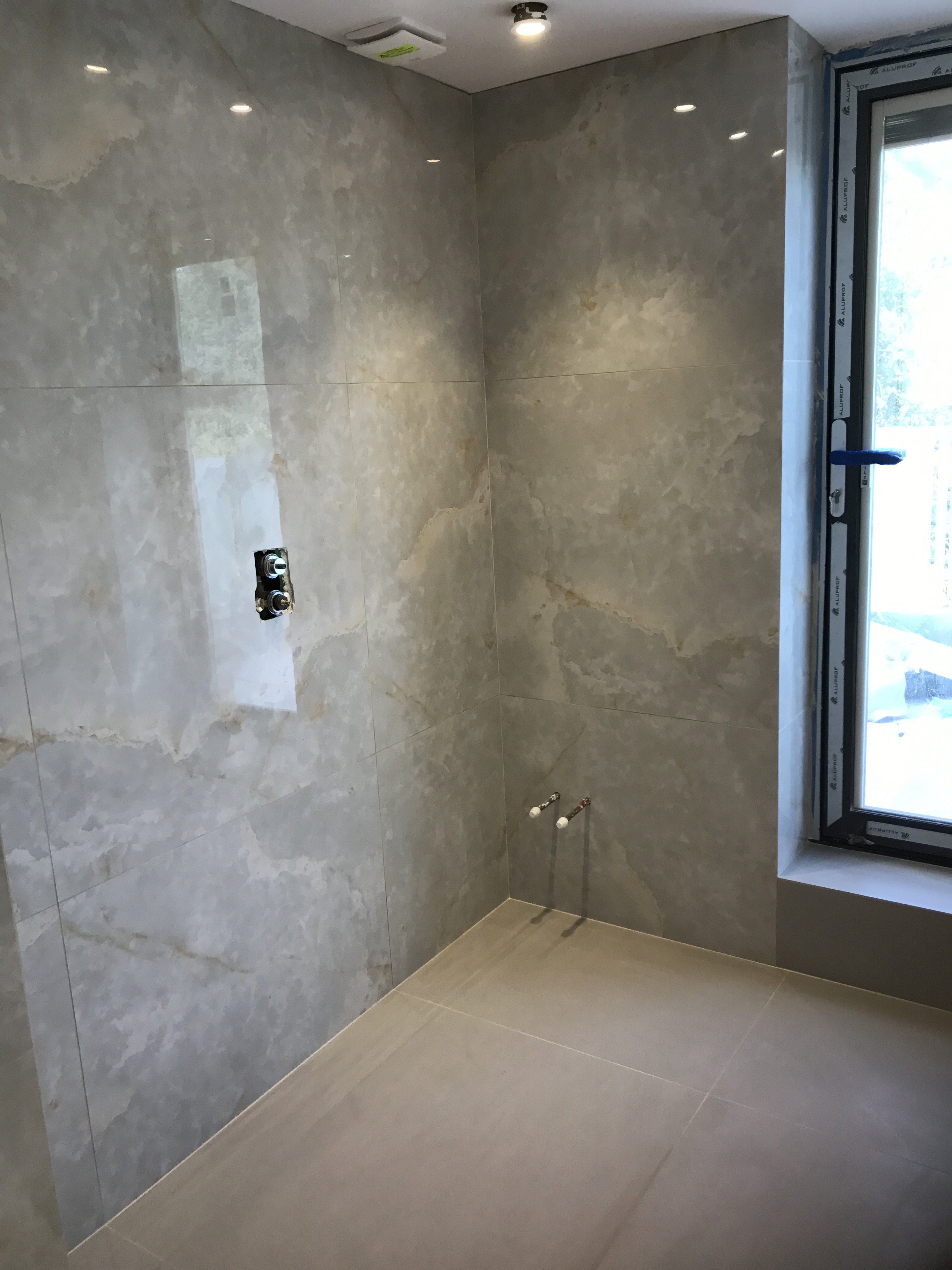

A small shower room, completed yesterday,porcelain on walls and floor.

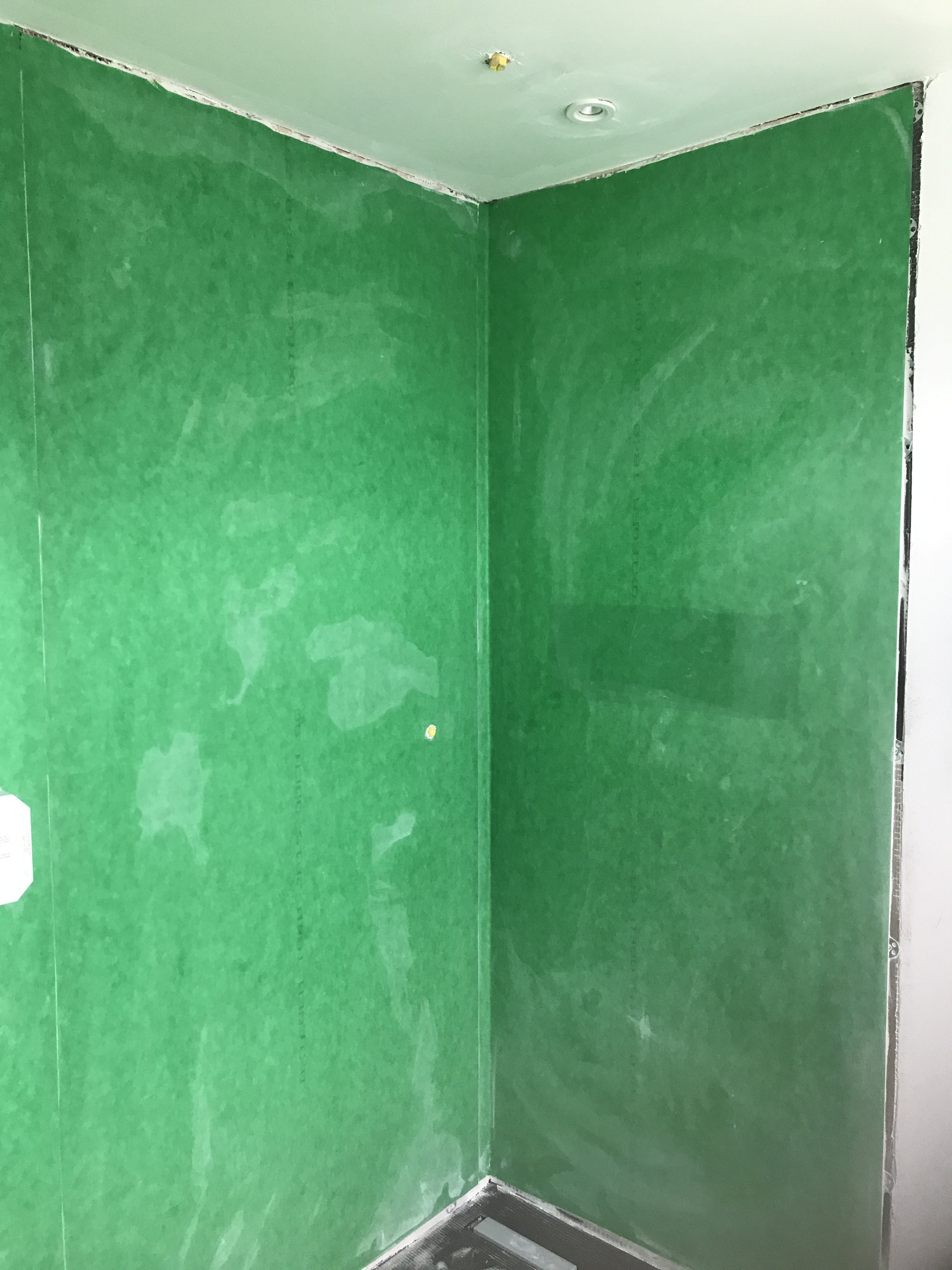

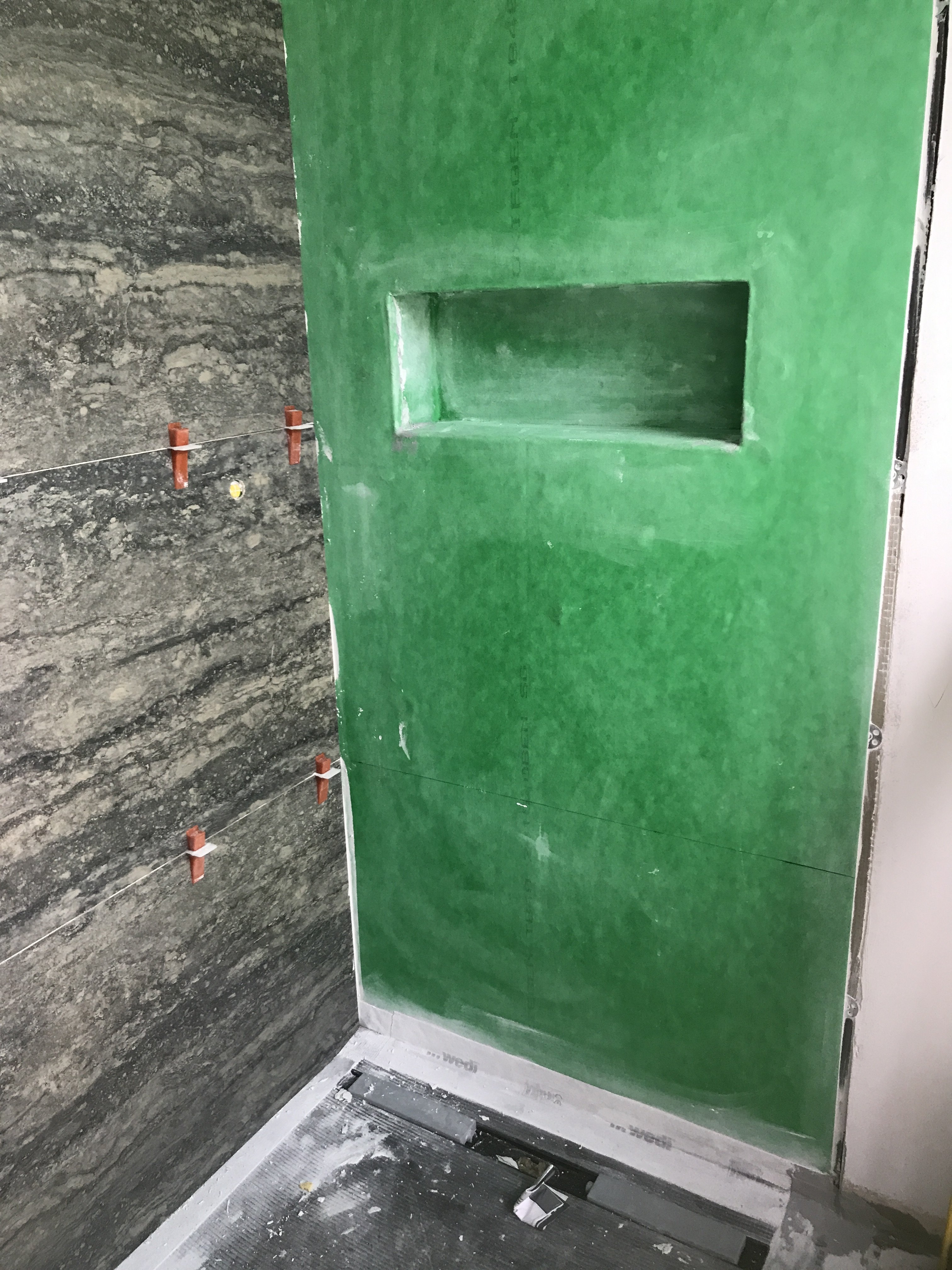

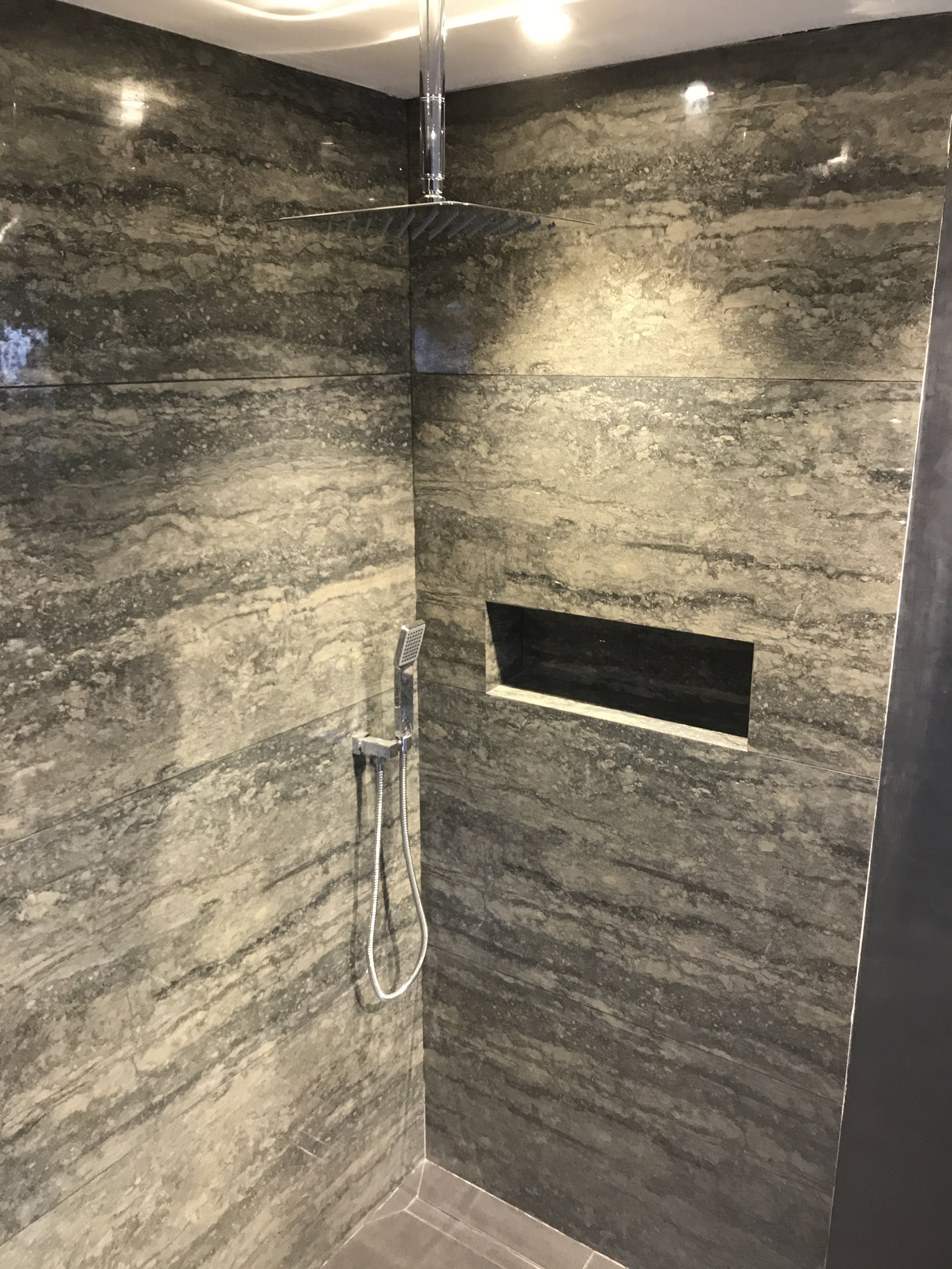

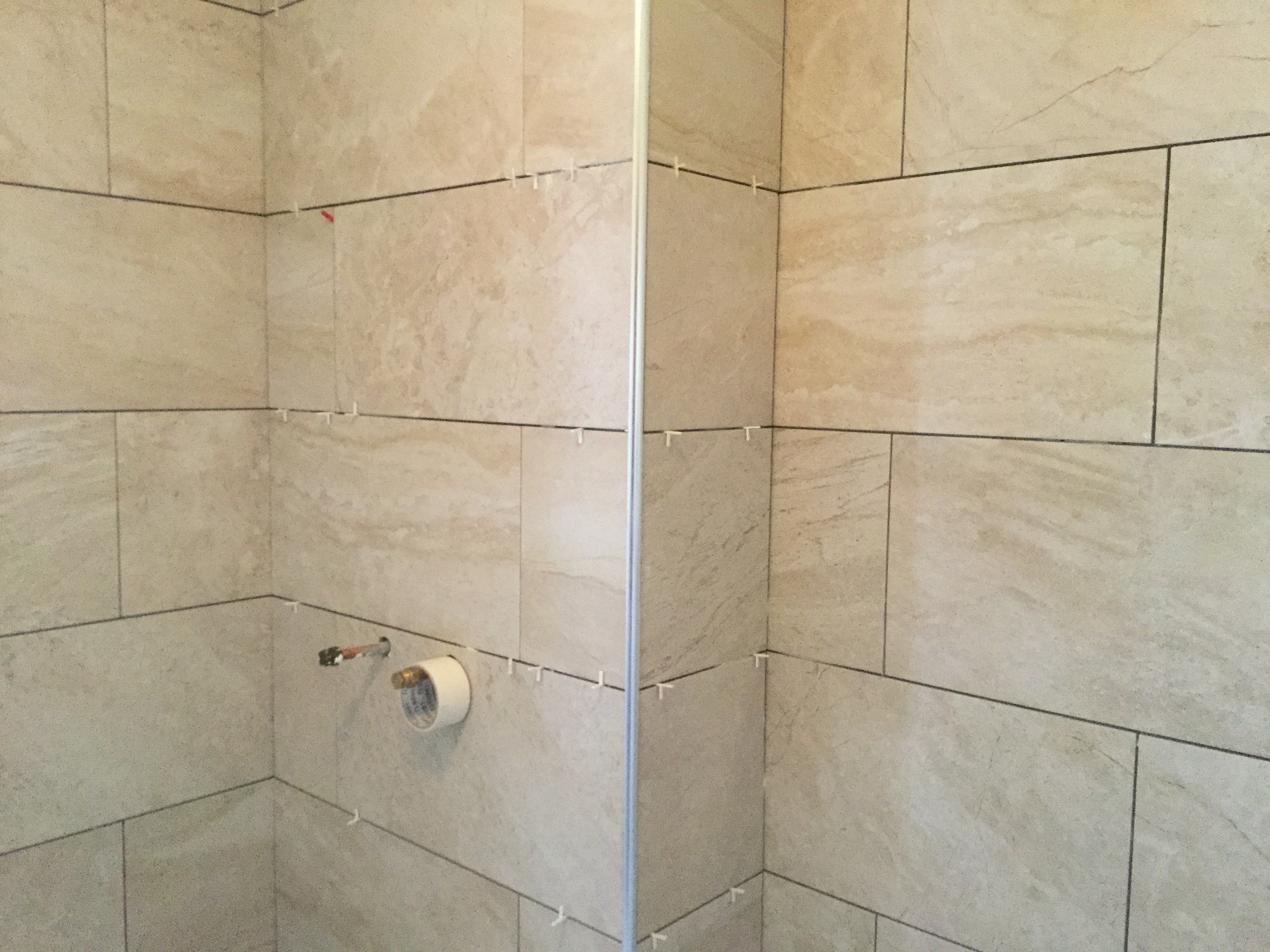

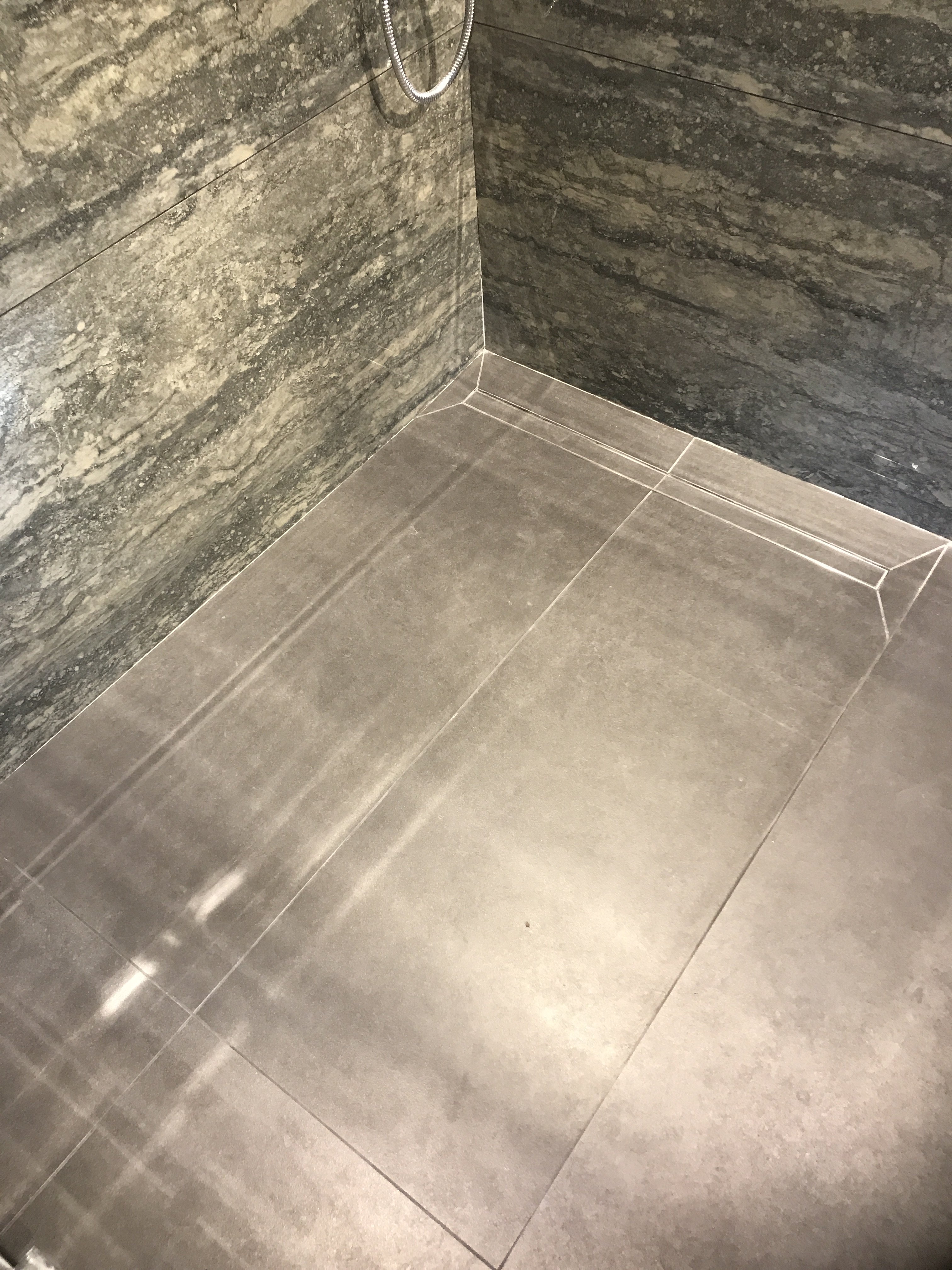

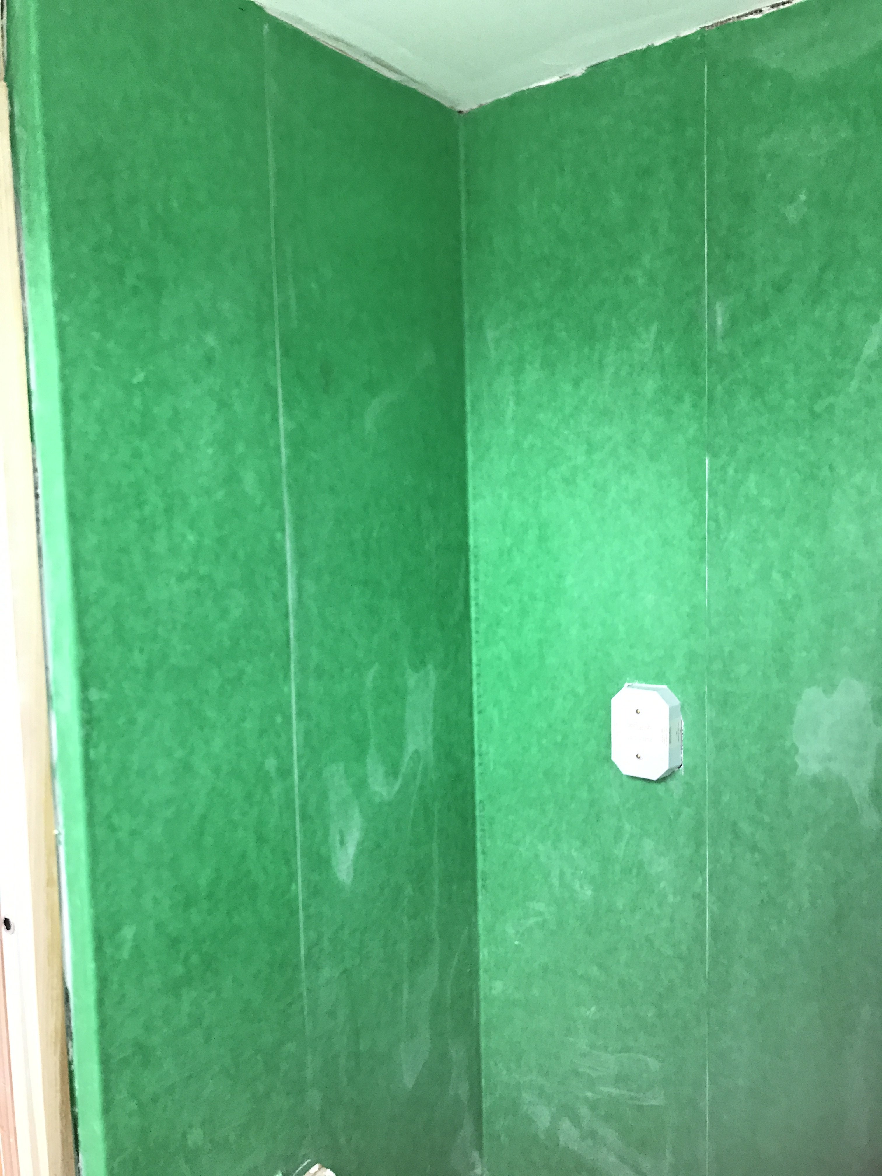

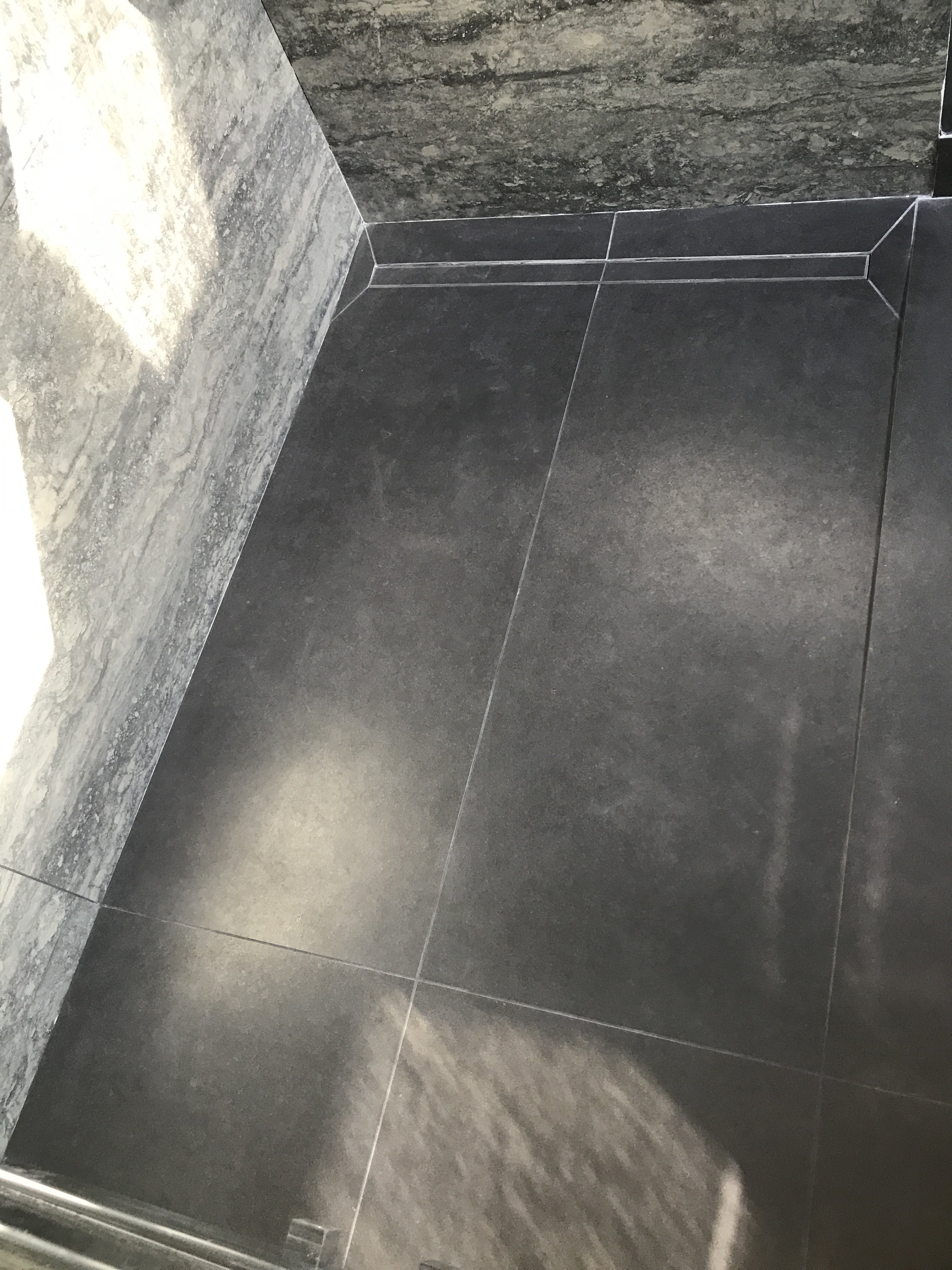

Couple of simple wet rooms completed last month. Built by builder with Wedi board, badly I might add, so completely re tanked with Isomat waterproof
membrane/antifrature sheeting.
Black shower is 1200 x 600 Porcelthin walls and floor.
Lighter shower is 900 x 900 random patterned walls and plain floor.
