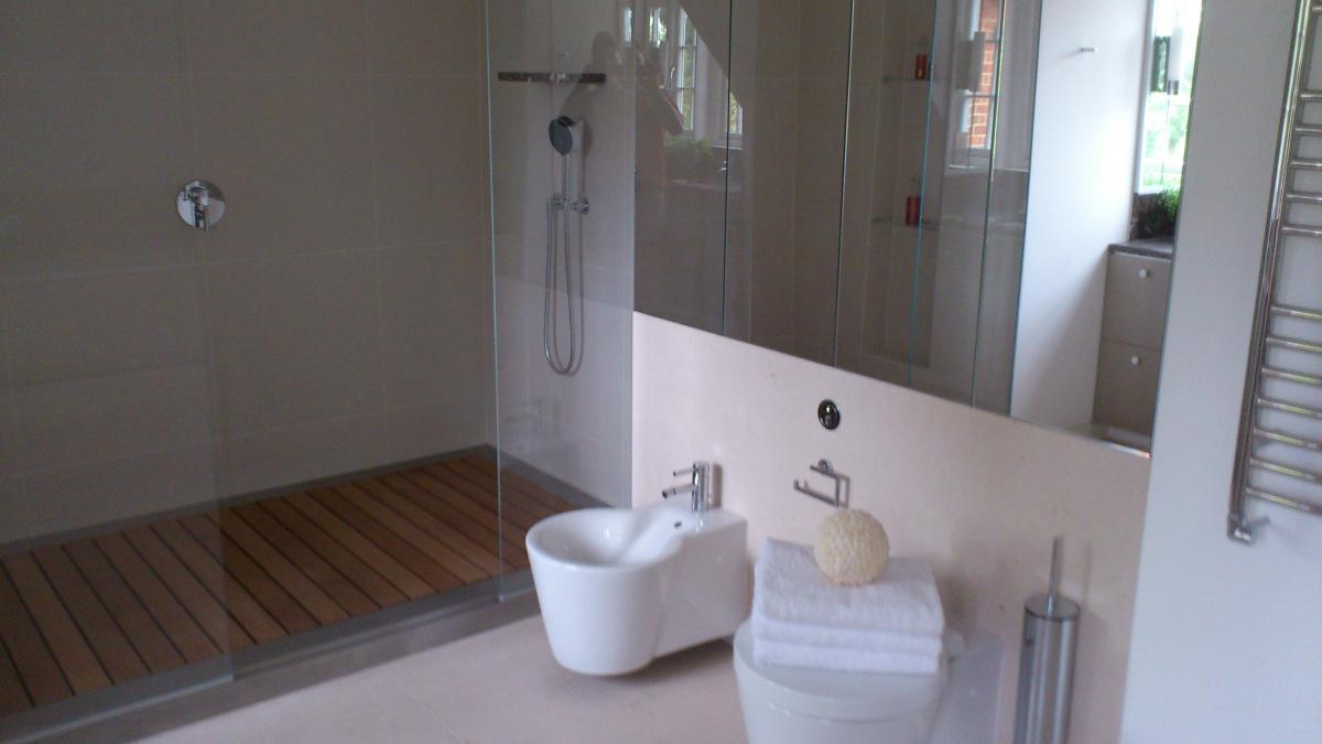

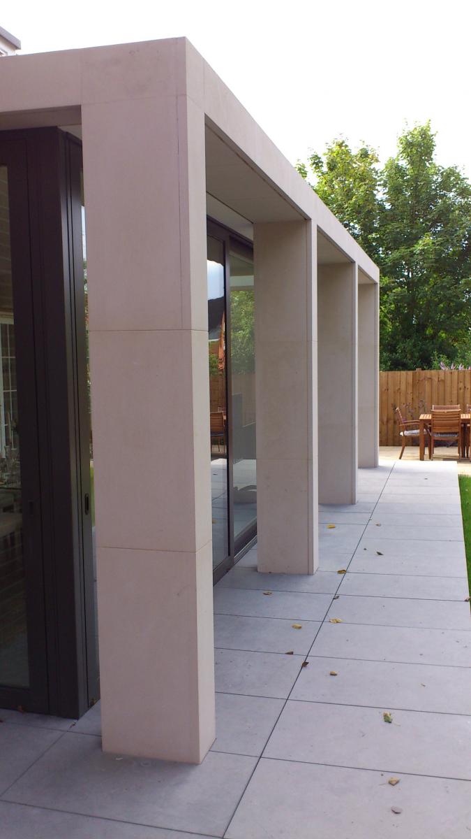

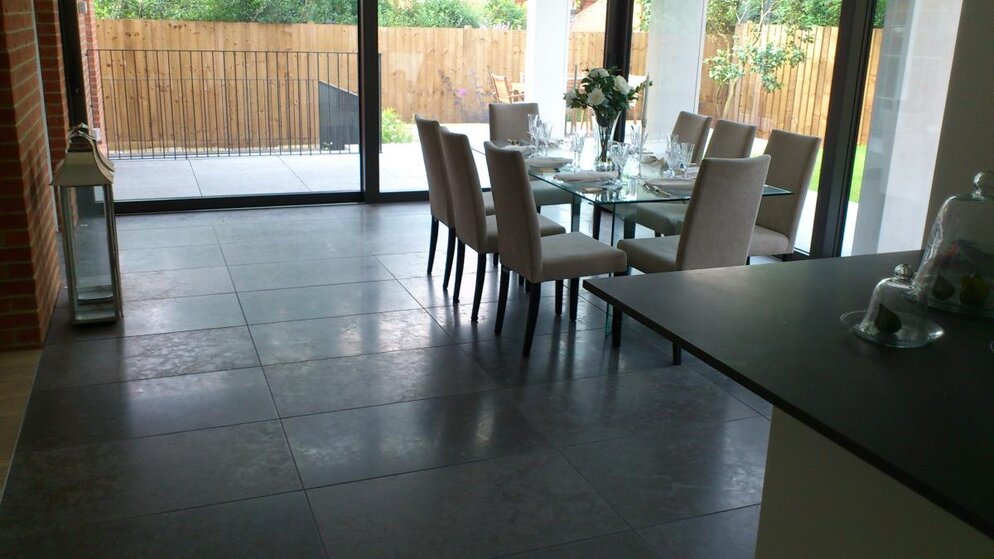

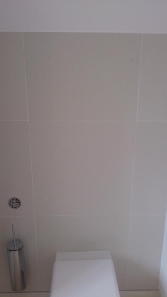

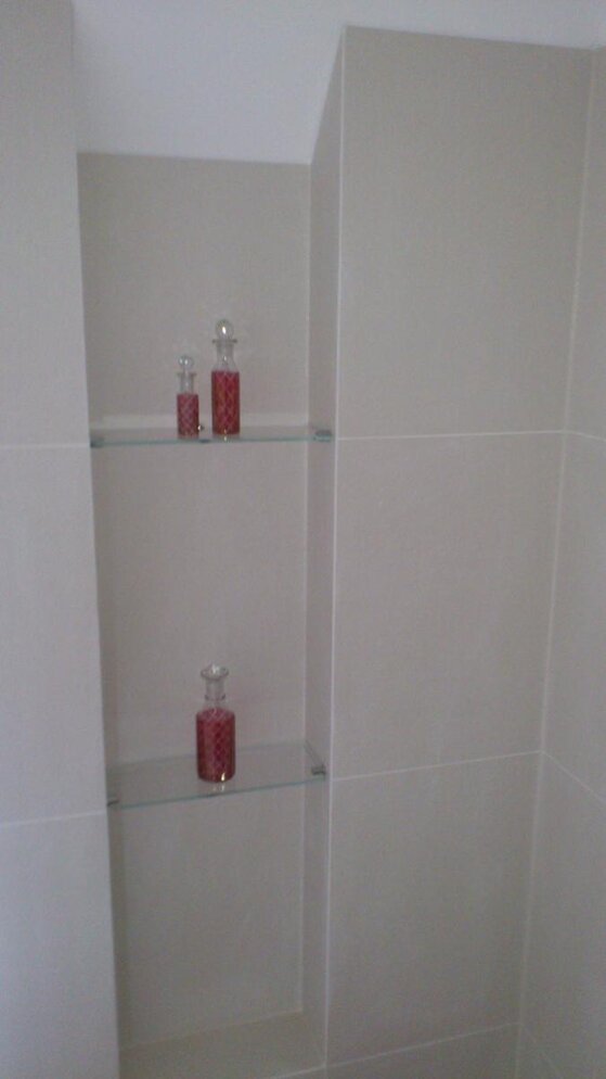

Got a chance to do some pictures this morning (finished this project august 2011). Master bathroom: 400x400x20 limestone on floor, 600x600x10 porelain on walls (mitre wizz external corners). templated and fitted limestone bath top and splash backs, dark emperador vanity tops. Other shower rooms tiled with 600x600 porcelain tiles. Living area: Calacatta oro fire place: made cutting sheet (my brother and my Ukrainian friend fitted). Kitchen/patio area: 950x560x20 blue jura stone( all tiles cut to size on site from 1000x600). And finaly outside columns manualy fitted (30mm and 40mm portland stone)
DSC_0428.jpgDSC_0431.jpgDSC_0432.jpgDSC_0433.jpgDSC_0434.jpgDSC_0435.jpgDSC_0436.jpgDSC_0437.jpgDSC_0438.jpgDSC_0439.jpgDSC_0440.jpgDSC_0441.jpgDSC_0442.jpgDSC_0443.jpgDSC_0444.jpgDSC_0445.jpgDSC_0446.jpgDSC_0448.jpgDSC_0451.jpgDSC_0454.jpgDSC_0446.jpg

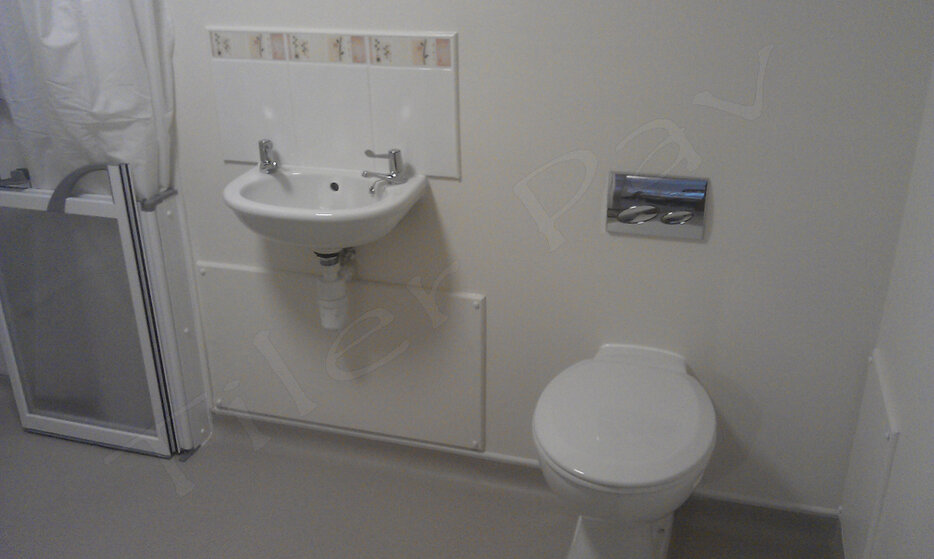

Hi Guys !
I finished already few jobs recently from my last upload. I'm so busy right now.
I gonna start put water marks on my pics 😉
