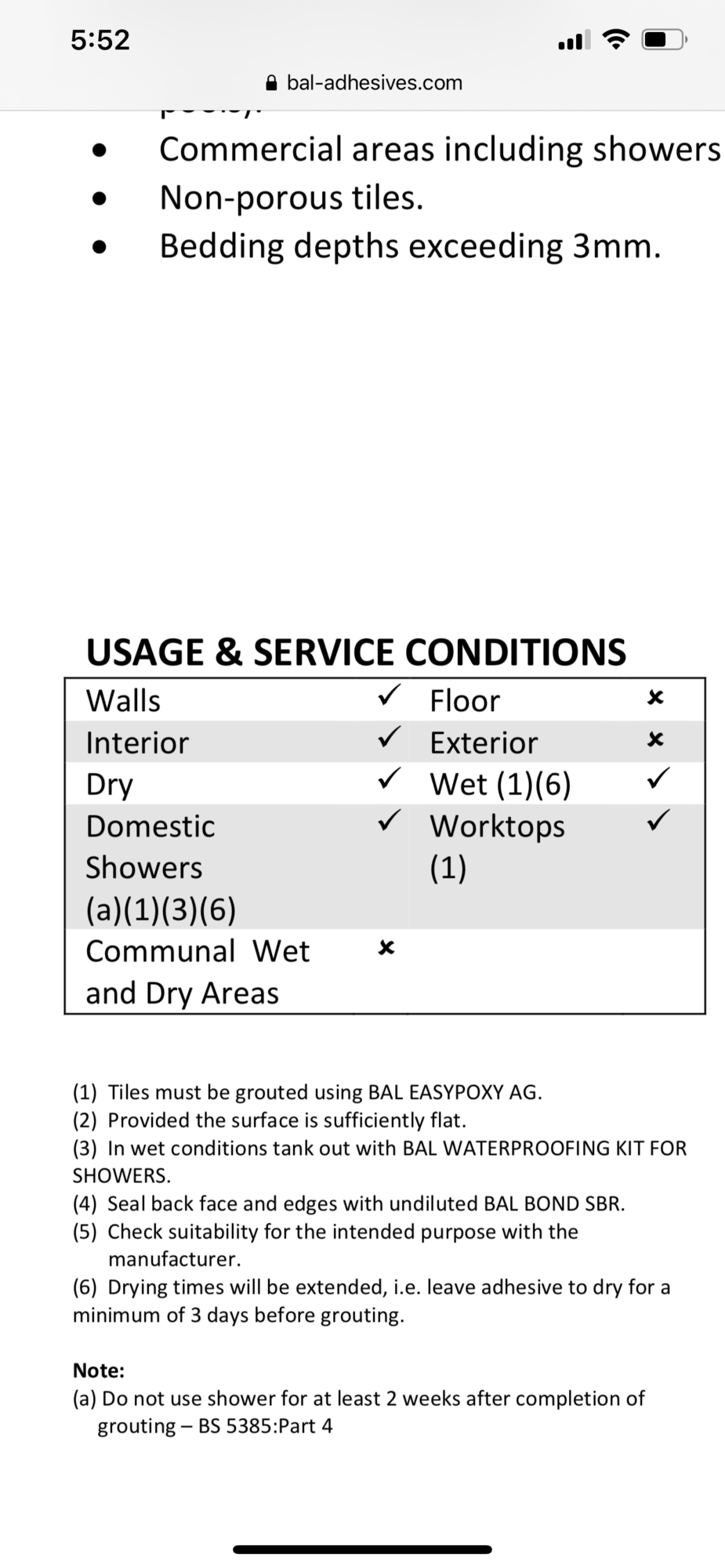

Green star adhesive on heavy tiles?

And don’t forget , he used the wrong adhesive and didn’t follow the instructions on the bucket.
