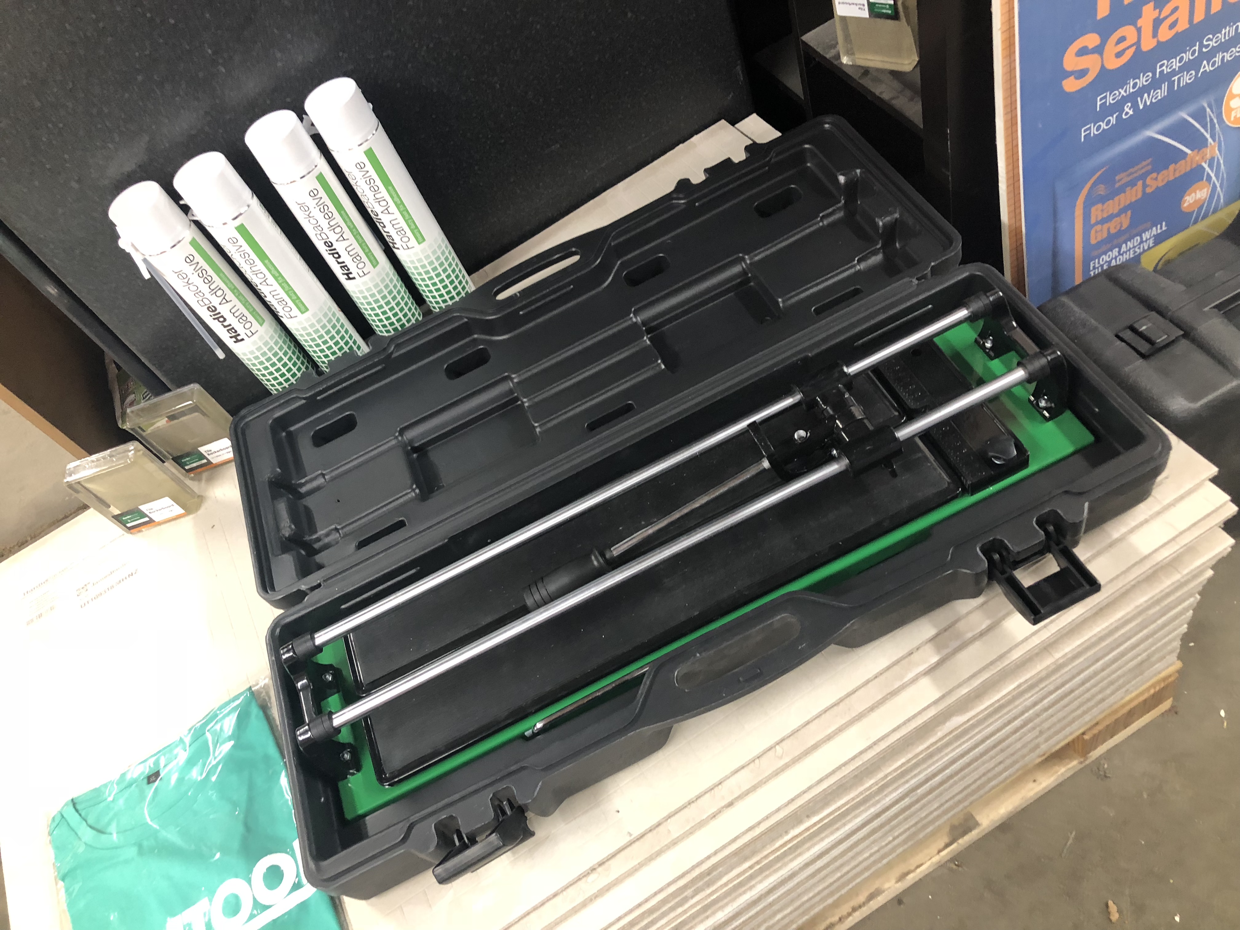

What cutter do you normally use then?
Well I’m only on job number 3, but I use this one.
