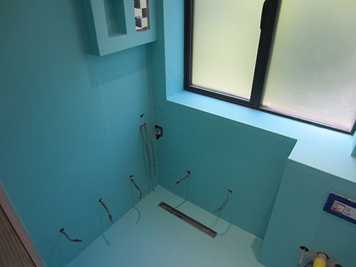

I have a photo of a "male" niche.........it confirms to building regs...........hehheheehhehheh.....hold on!
this is it......
it is on an exterior wall.......
is this a male pigeon hole?.........hhhehehehhhehehe.....

this is it......
most tilers never even see a building inspector.....do they?.........
Look nice lee, wouldnt call it a niche though, more like a tiled shelve unit 🙂
