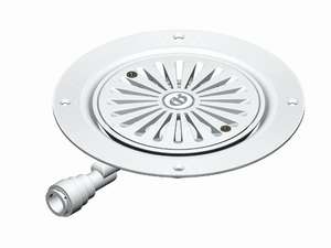

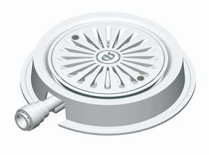

I got a pumped wetroom and shower gulley / drain that discharges through 15mm or 22mm pipe which are shallow at between 32mm and 52mm deep working off a pump :
