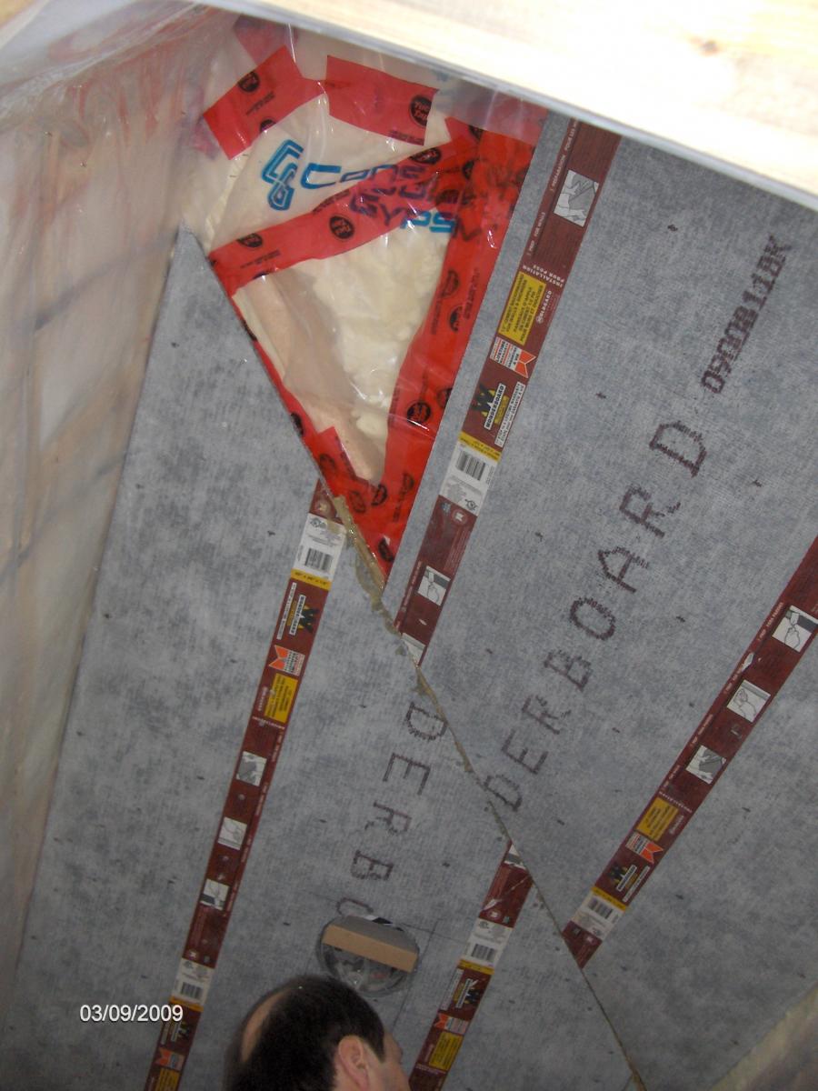

wonder board over the studs which have vapor barrier. It is an outside wall.
The board is nailed in place with 2 1/2 inch galvanized ring nails with oversized heads and the joints are all bonded with PL premium (polyurethane).

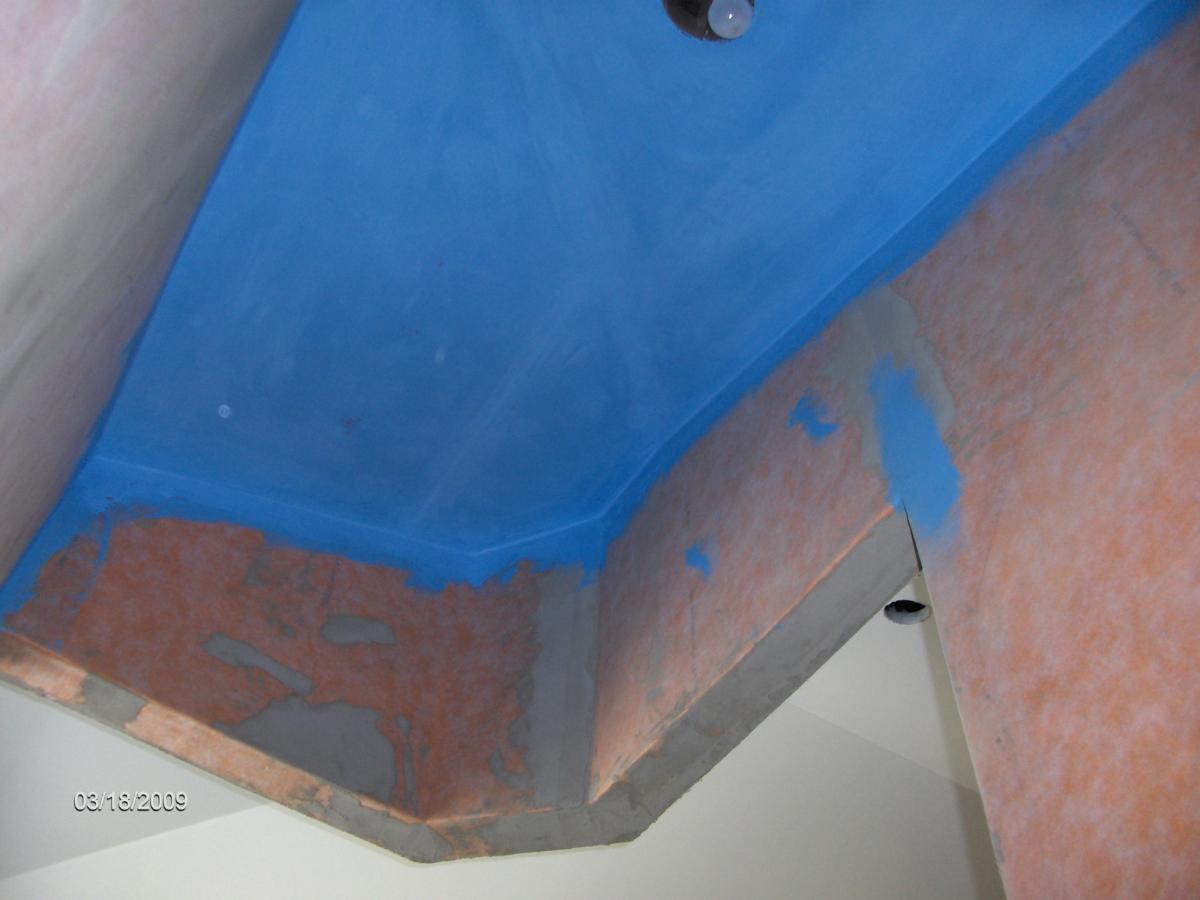

The blue is mapei HPG which I use at times to provide a bit of extra protection in certain areas.

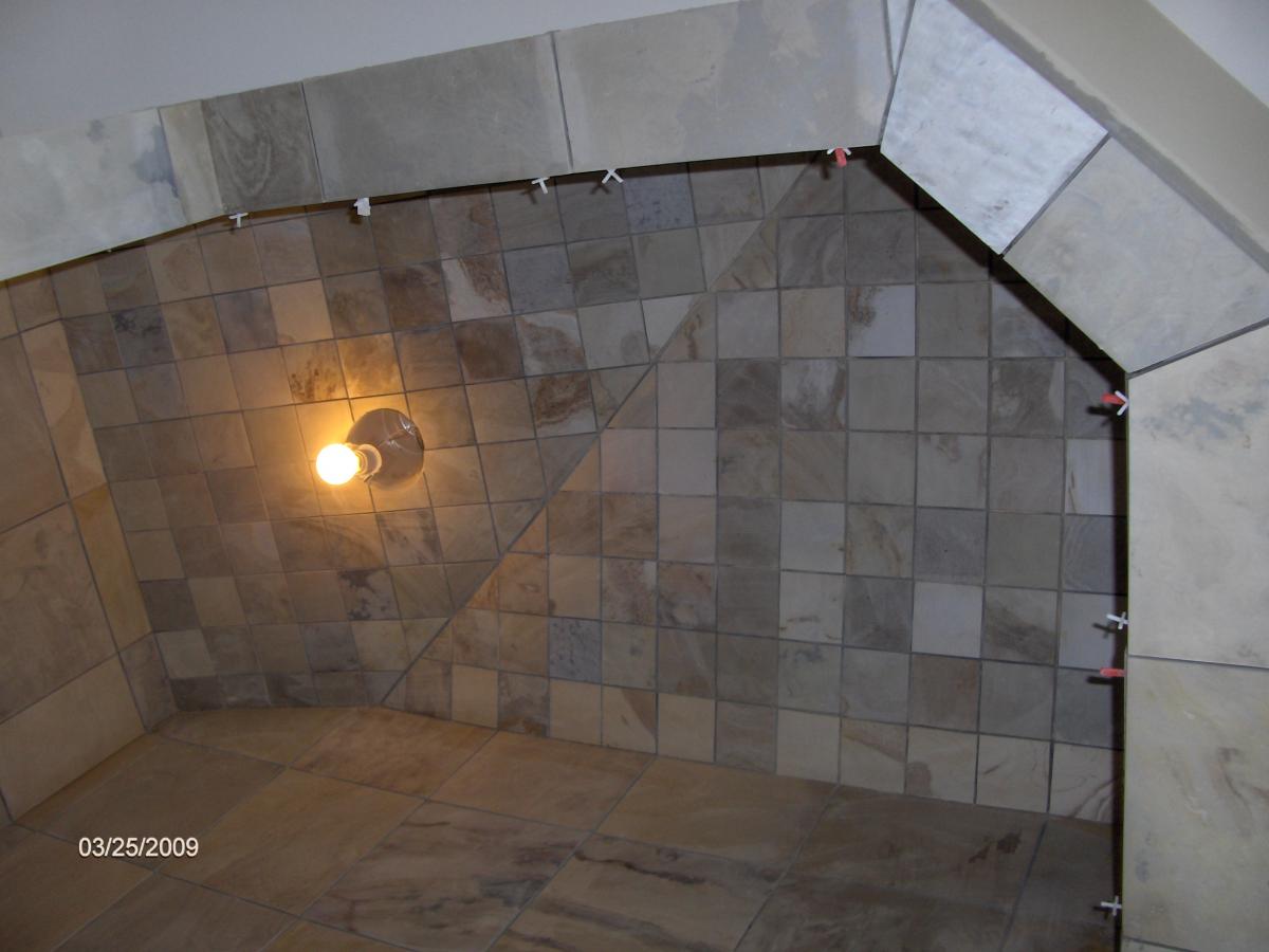

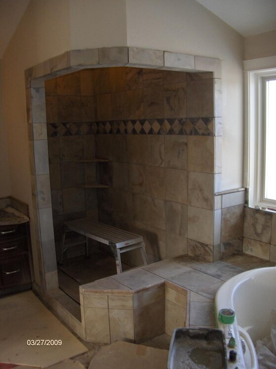

some with stone on.
The ceiling was spec'd to be that way. (odd angles) The grout lines had to match with the walls.

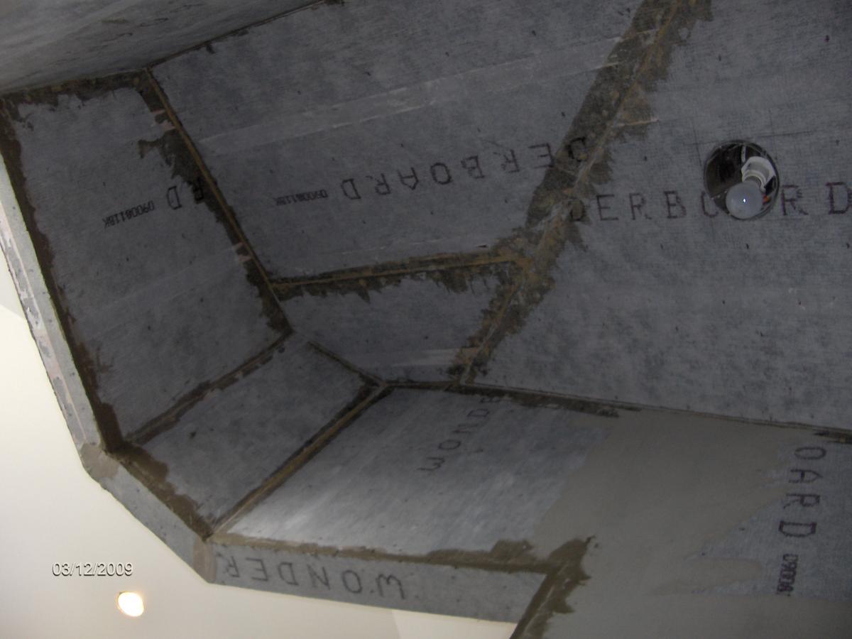

We had to cut 4 x 4's from the 12 inchers and do the floor and ceiling as per directions.
I haven't any pics of the job grouted and sealed yet.

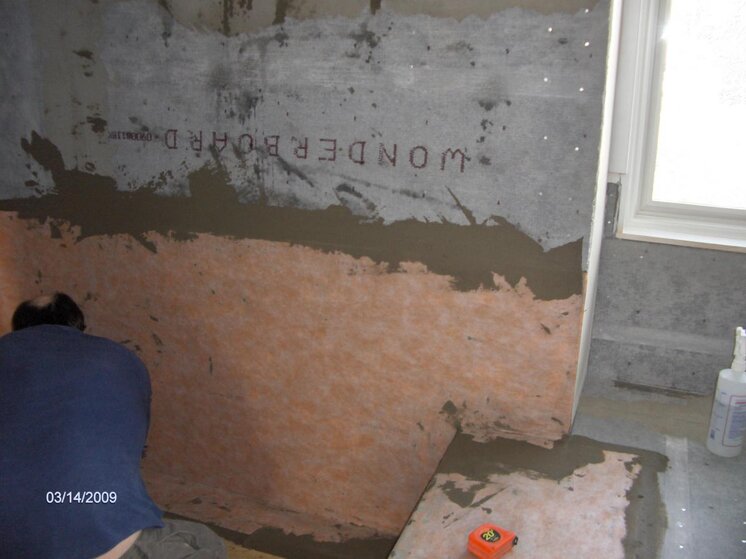

( a note for the first few snaps, the PL is scraped smooth when dry, then fibreglass tape is applied with thinset, then kerdi is put on with thinset. Tiles are fixed with unmodified thinset)

So many things the same but slightly different methods. I like the use of the Noble membrane on the walls as it is much cleaner,quicker and cheaper than my prefered method of using Laticrete 9235 but I love the finish and the flexibility that the Laticrete gives.
