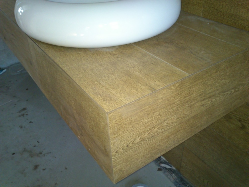

Opions on 3 way mitres

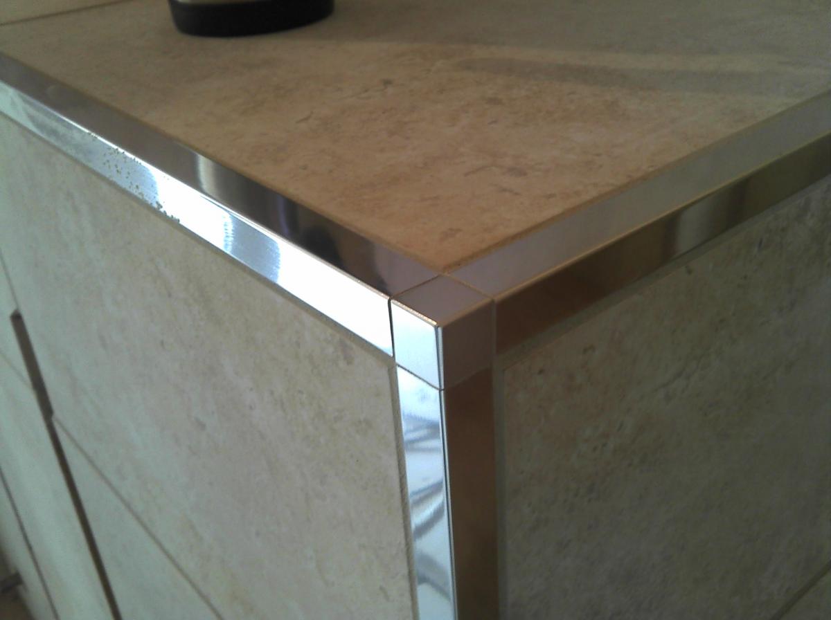

Even if you could do that, you'd then probably want to do the same on the horizontals and double up all over. Would look pap imo!

you cant do that in the other pics situation tho can you. and I see where you guys are coming from now thanks john appreciated mate :thumbsup:
As CR said you can only achieve this with square trim and you can either mitre the vertical or horizontal corners, I prefer the cubes personally
Instead of mitring the top edge, just cut the back out in a 'v' and bend it around a tile corner to a 90* angle!

How far do you cut the V into it John? Sounds like the way forward, those points can be nasty, especially on an external corner of skirting.
