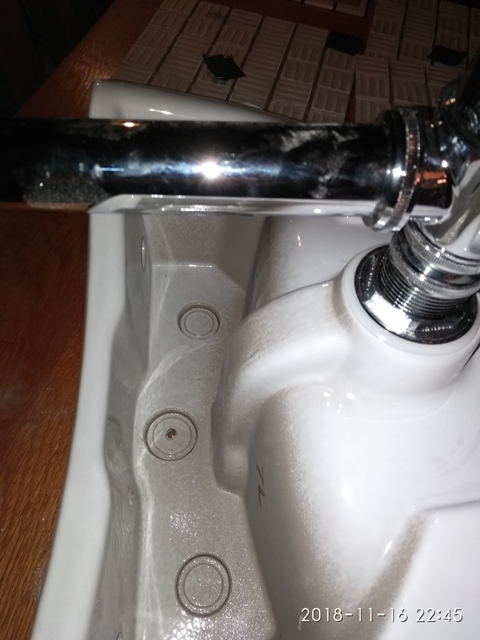

Lastly, and I realise this is probably a plumbing question rather than a tiling one, the new basin has knockouts for the taps. Do you just give them a whack with something to break them out or is there a more scientific way to ensure they fracture smoothly?

Knock out for tap not taps unless you like waving your hands under the hot then cold taps... I tap them out then tidy up with a diamond core drill.

And knock out tap holes in ceramic with a thin nail punch and hammer, mine is around 2.5mm and start in centre to break through and work outwards to required size.

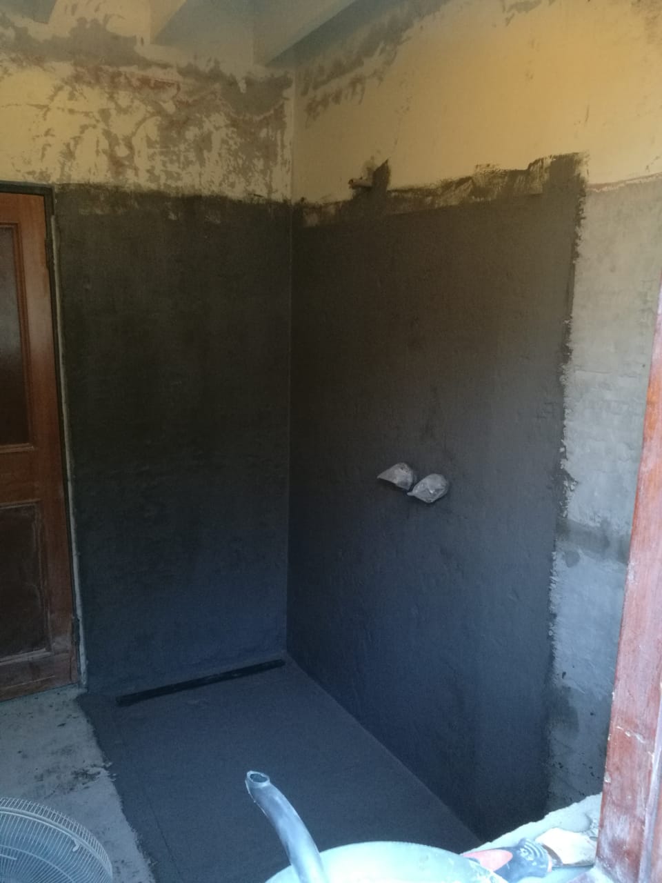

Waterproofing of shower area finished.

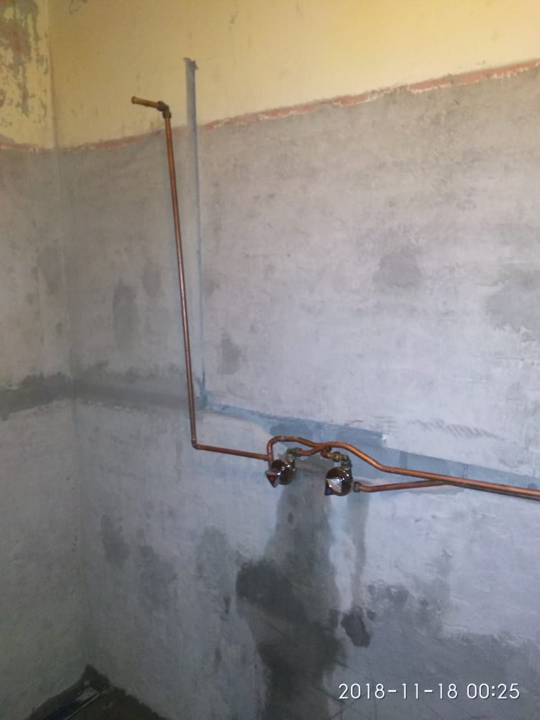

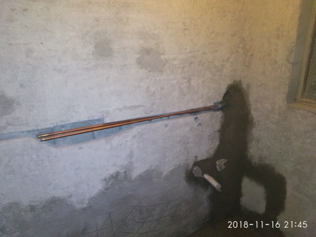

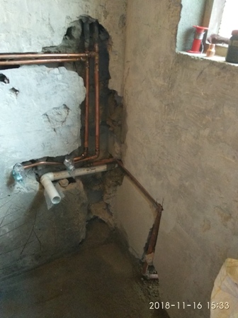

Plumbing for the shower;

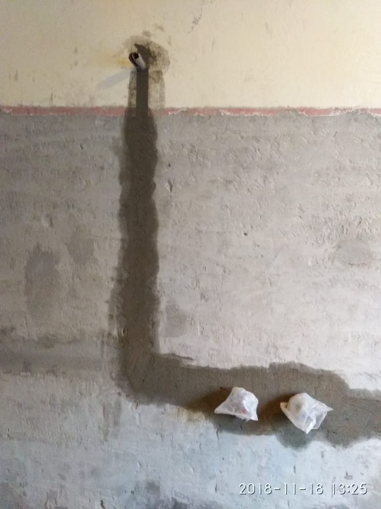

Plastered up;
Waterproofing done;
Apart from the fact I haven't seen separate valves like that used in a shower, why didn't you set them vertically to make your pipework easier?
I assume things are done differently over there!
With hindsight I should have brought the horizontal supply side pipework in lower and made the pipe across to the shower head higher then I could gone straight in and out of the taps. It would have been a lot easier but by the time I realised I didn't want to upset wifey with more dust by grinding again.
There's no particular reason I got separate valves, there's all sorts of shower mixer taps available and also fancy ones with thermostatic type mixing valves. Just figured simply separate valves would work fine and they're budget friendly.
I have another question please.
If you look at the gap in the metros in the second picture there's a gap with 2 tiles missing where there's an electrical conduit box in the wall.
How do I cut a 60mm round hole in the tiles to accomodate that? Unfortunately I don't have any fancy diamond cutters or anything like that, the closest I have might be a Dremmel tool or normal SDS drills etc.
Mark up a couple and take it to a tiler friend or colleague who would have the tools to do it
Have you got an angle grinder? A few diagonal cuts then tap it out with a hammer. If there's not a shroud going over it tidy it up with a tile file.
Unfortunately I don't have any tiler colleagues. I'll try the angle grinder method, the worst that can happen is it will cost me a tile.
