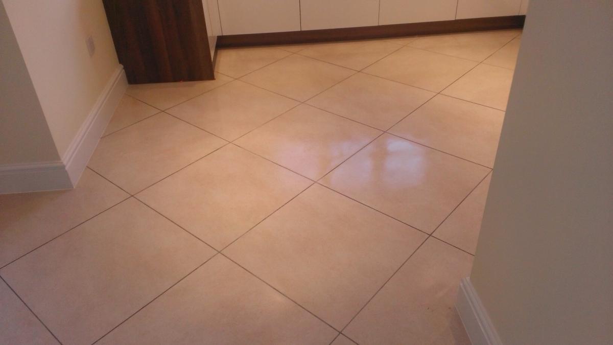

If skirtings are 10"-11" high and you don't want to take off then i under-cut. Or cut tiles within 3 or 4mm and silicone the perimetre joints.
If the skirting is newly painted id think about using white. But colour co-ordinated i think is better.
If the skirting is to be painted then seal after or tape the boards and seal. The tape will leave i nice straight line to make decorating easier. Any paint that the shakey hand gets on the bead simple wipe off with a baby wipe or peel of when dry with your finger nails. Simples.
With UFH i insist theu come off and suggest the option on all other occassions. Its a far better finish.
Ive fitted 1000's of linear metres of skirt over the years. I scribe in my corners rather than mitre too.
Because its a better finish!
nice neat job John but im thinking we are talking about skirting boards here are we not
And leave it more prone to failure. It is a movement joint designed to allow movement. Grouting would restrain it and potentially cause tiles to pop.Would still grout it could be solid floor,if the tiles are cut tight looks better than silicone.
Used to cut around but now remove, If done right, you can't tell the difference unless you look round the back of loo / sink.
tidy job their john !
