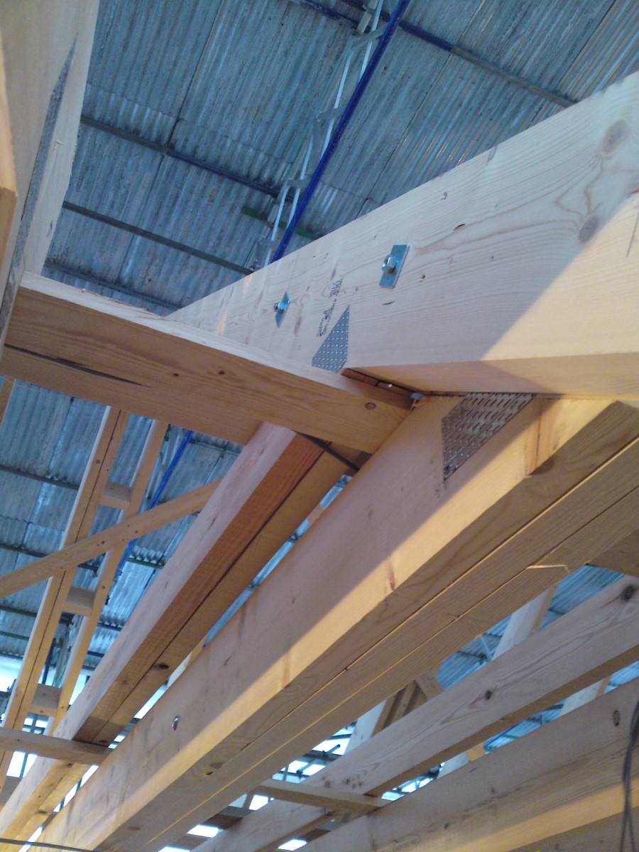

The company that supplied it were tested to their limits with this as they used 3 ply girder trusses for the first time. All 9x2 and over a wall plate span of 12.6 mts (41 1/2 feet)
Looking forward to it! :thumbsup:

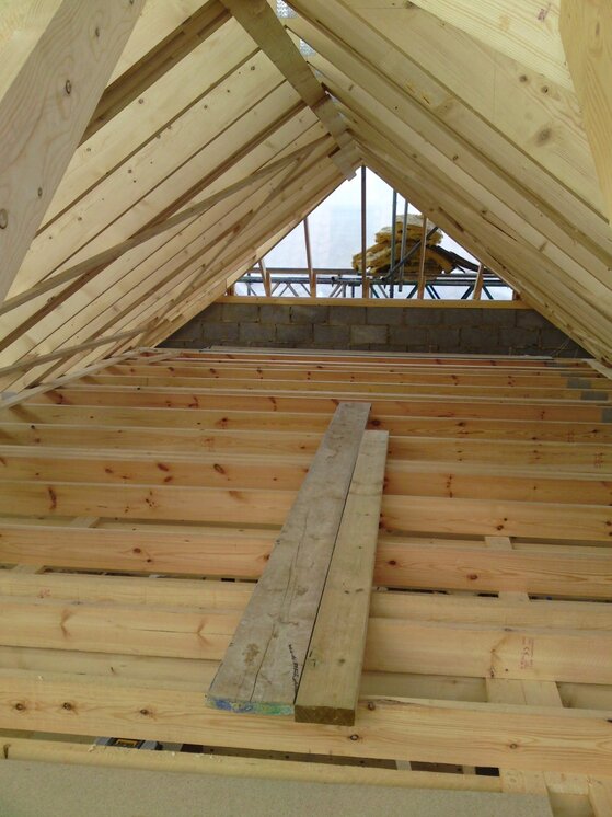

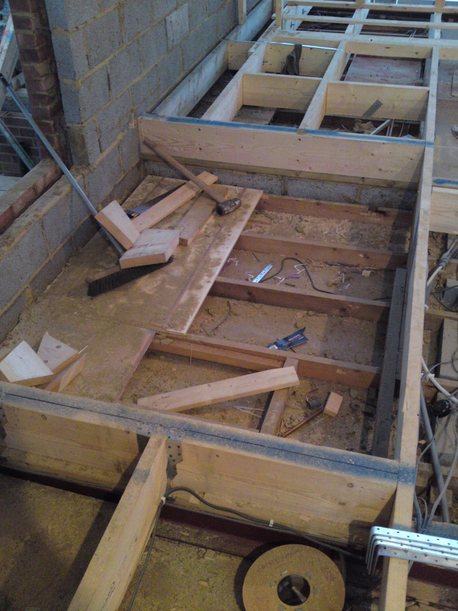

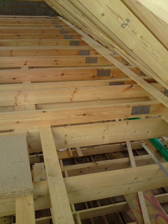

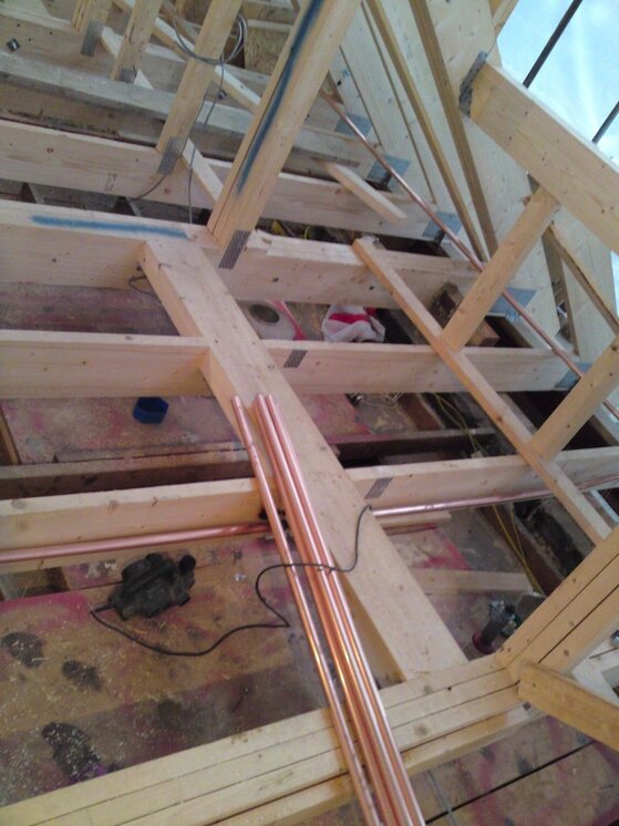

Some more pics for Rob to show the construction side of things.
The original design was for 4 off 3 ply girder trusses and 2680 feet of 9x2 timber (815 metres in english :thumbsup:), however i didnt fancy the idea of trying to frame trusses this size with loose timber as this would have meant having a working platform built through the centre for safety.
I asked for all the trusses to be made the same so we could crane them all in without needing them in any order. That way we could bolt the triples together on site and then cut the singles out as required for the dormer windows.
You can see in the pics the doubled up trimmers for the stairs, purlins and binders. You will also notice the binders have been set into the single joists. I think its all basic carpentry? Dont know how it is where you are? Are your trusses made the same with the gang nail plates?

Hi Scott, thanks for posting the pics. :thumbsup:
We have different hardware and some of the framing techniques are different from what I see in your pictures. What you would see where I live would be quite different from southern Florida (hurricanes) and California (earthquakes).
The quality of the lumber looks very nice. Do you know where it is harvested and milled? We get a lot from the US and also Canada, although increasingly I'm seeing trim labeled from Chile and New Zealand (how can that be brought here economically??)
Did you have your plans engineered? Drawn by an architect? And do you have to go through plan review and have building inspections? The requirements for these things vary tremendously around the US.
