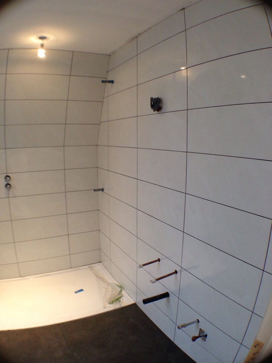

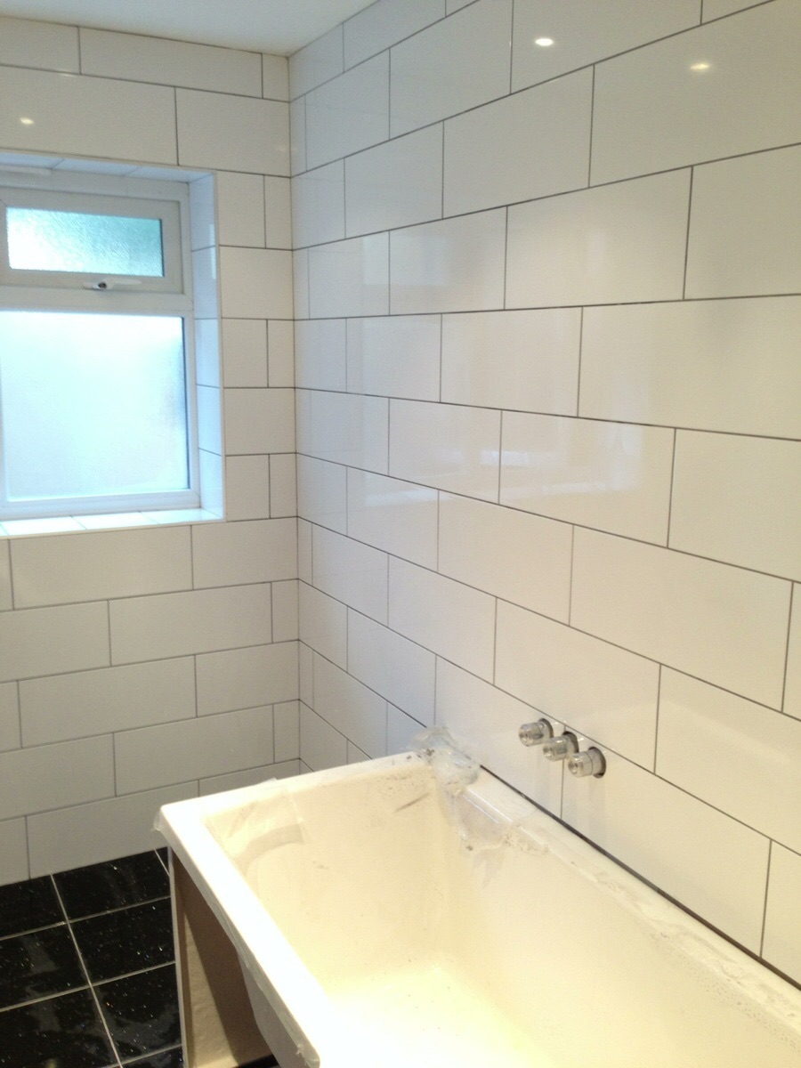

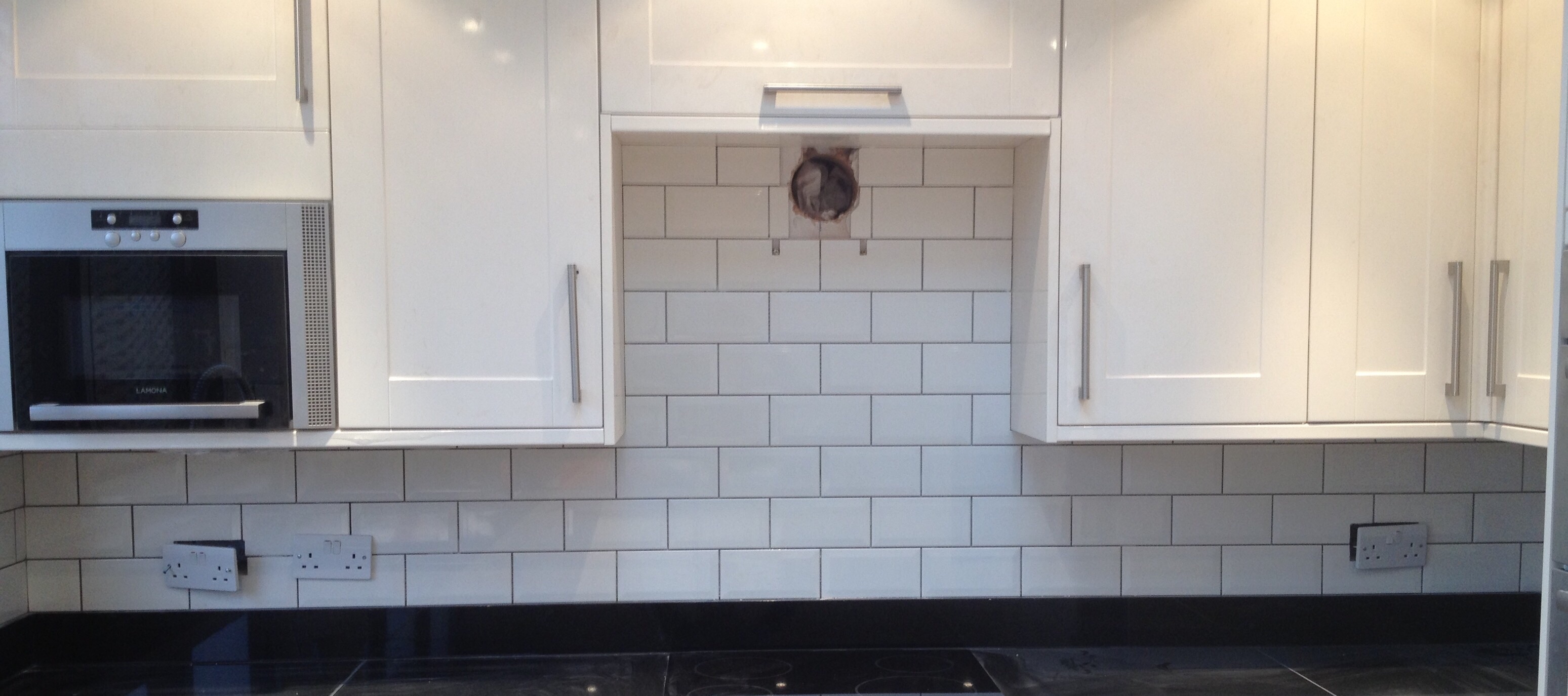

Been pushing greys in wet areas for 2-3 yrs now, it's a much better choice imo.
Main reason being if u go for a darker shade your wet area should stay looking new for many yrs with no grout discolouration.
As a bi product of that it makes my job easier 😀
Same grout walls and floors and no grout bleed to worry about at wall and floor transitions!
View attachment 74867 View attachment 74868 View attachment 74869 View attachment 74870 View attachment 74871

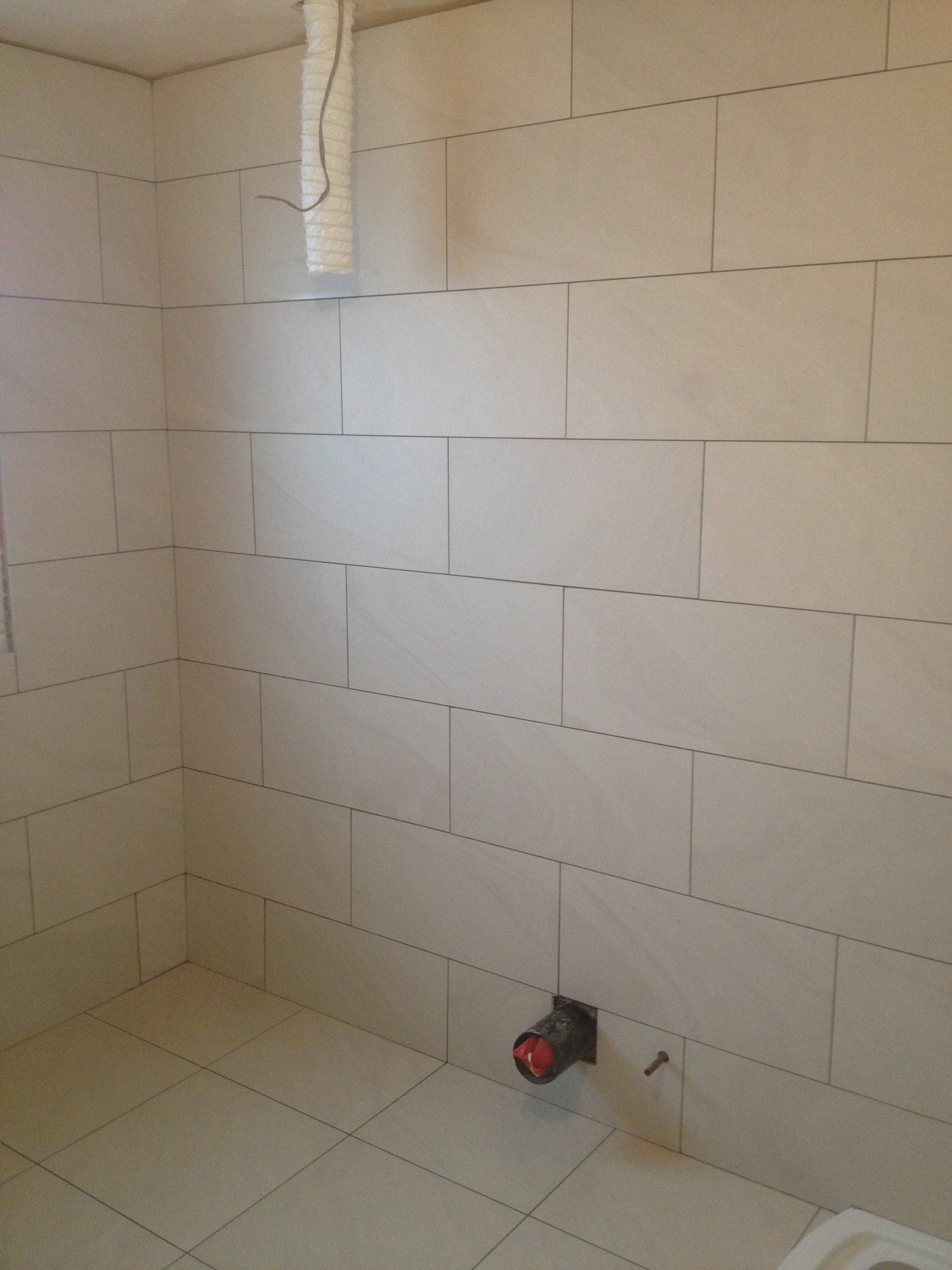

They all look great. Do you know which colour you used in the first 2 photos?
I've been trying to think back all morning actually, and I can't I'm afraid.
All I can say is that I usually try to get what used to be known as just a basic grey grout. Seems they don't just call it grey grout anymore haha all got fancy names.
If u take a look at Geoffs Mapei colour sticks above they would most resemble 113-114 but I'd be swaying more towards 114
sorry, not a massive help I know.
