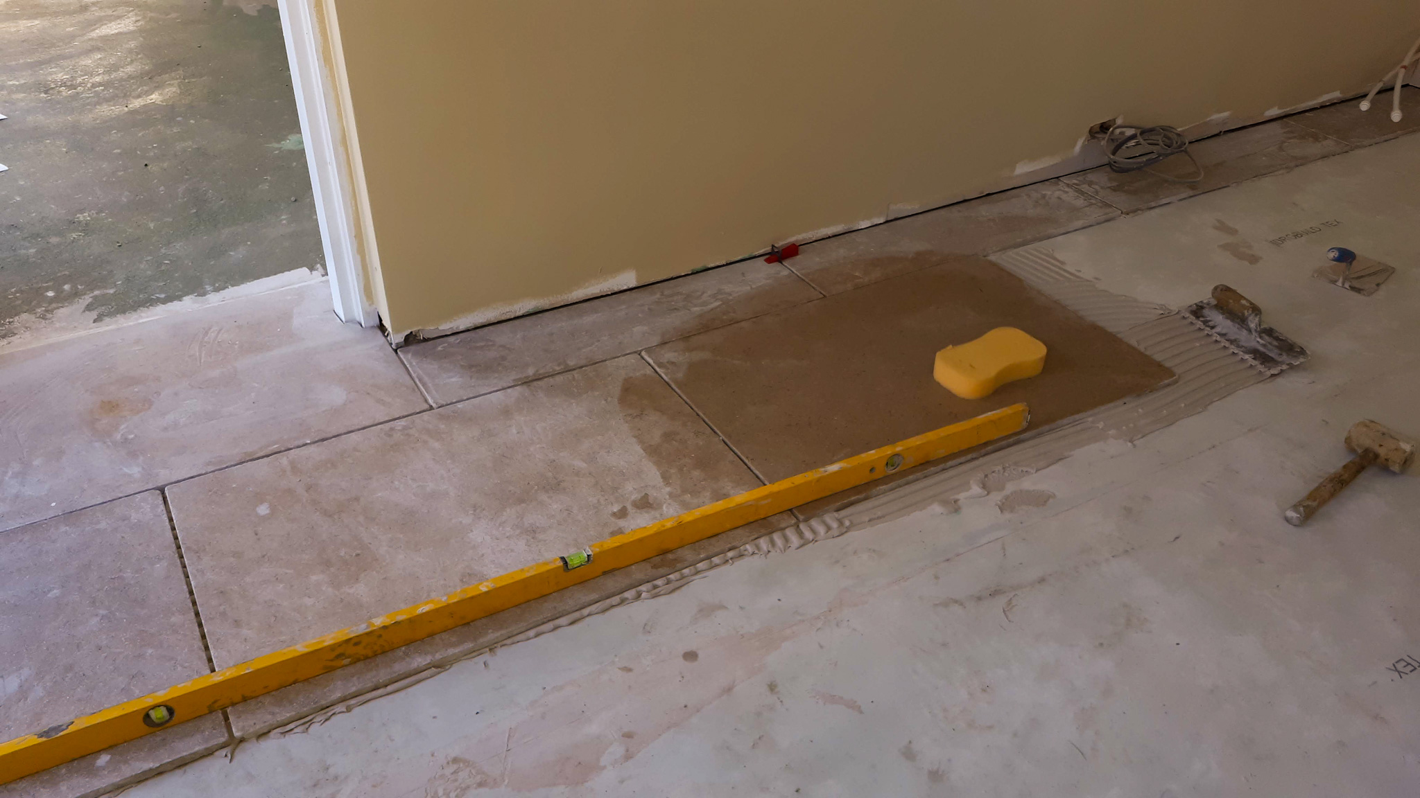

I just float the tm mat in as I doesn't take a roller well and don't walk on it until set unlike cavity matsJust used 100m2 of Butech anti fracture mat, not totally impressed with it - someone said it was the same as Tilemaster stuff!
Heavy roller and it still showed footprints.
