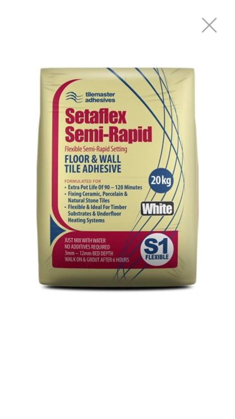

Use a standard/slow set adhesive, only need to give buckets and trowels a clean once at lunchtime and once at the end of the day. Exactly same spec as an S1 rapidspf it just sets slower ;)
Thanks a lot for that - it has been quick setting adhesive I have been using so will switch products

Unless I specifically need to get onto a floor I'm doing quickly, in which case I'd use a rapid set, I would always use a standard set adhesive and it would be Mapei Adesilex P9. It sticks ceramic, porcelain and stone, a good grab and a pot life of just about all day. It's a good product at a good price so little wastage.
What you have to think about with slow set - in the winter it will take longer to set than in summer, and you have to watch for shrinkage when it dries ( those lips weren’t there when you tiled it)!
Give your self a break Andy! If it doesn’t need to be walked on quickly, why use rapid ?
