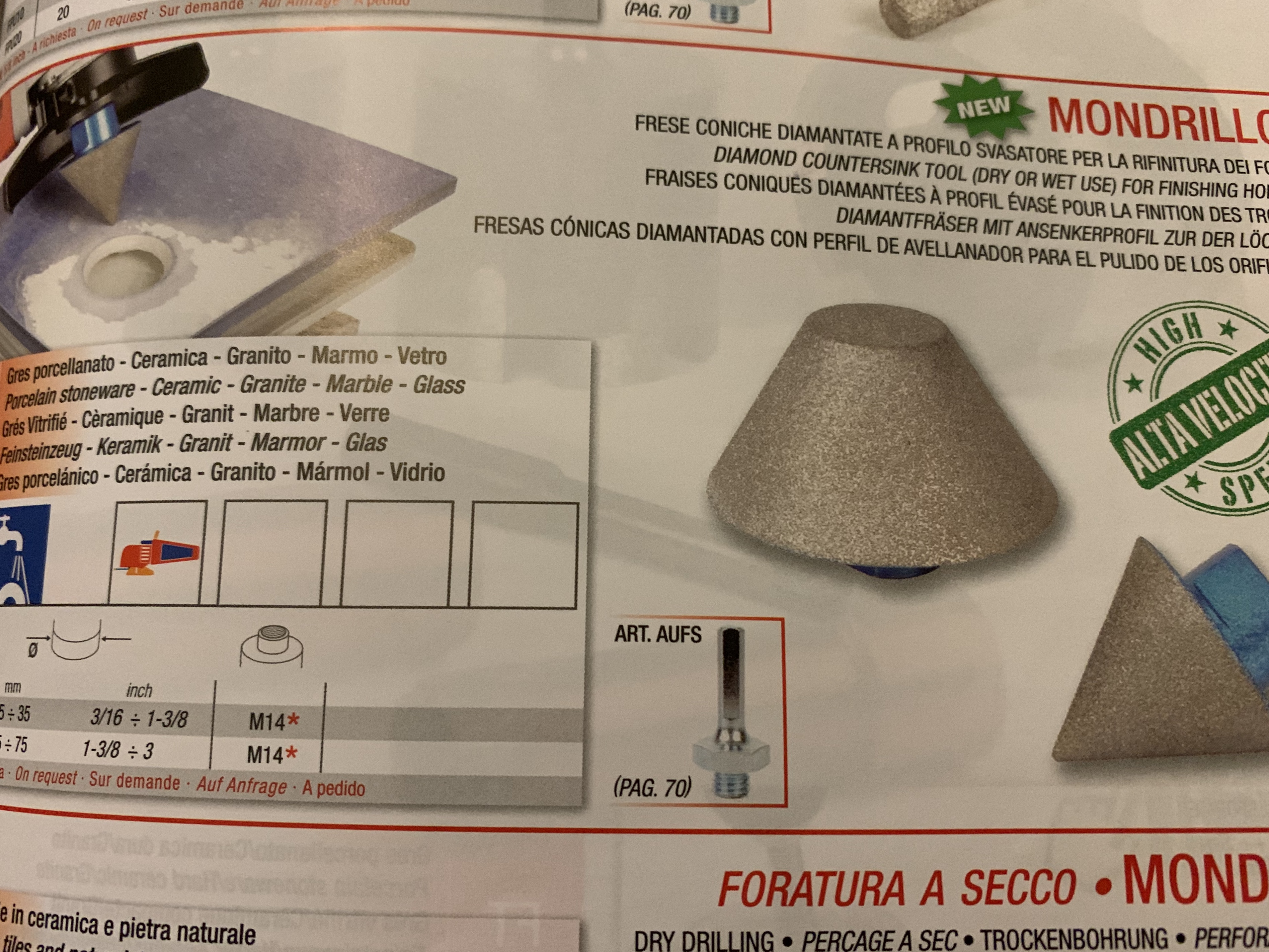

The montolit fps is designed to make a smooth finish, the tpu is designed to enlarge a hole.
One way I use it is to set my grinder speed mid way ( Bosch variable ) no.3 and wet the area and take my time. If you use a plunging action more chance of one of the fpu diamonds catching the tile and chipping
Ok tbf I’m not sure which one I have. It’s 10mm barrel type similar to the one in your photo on your page.
