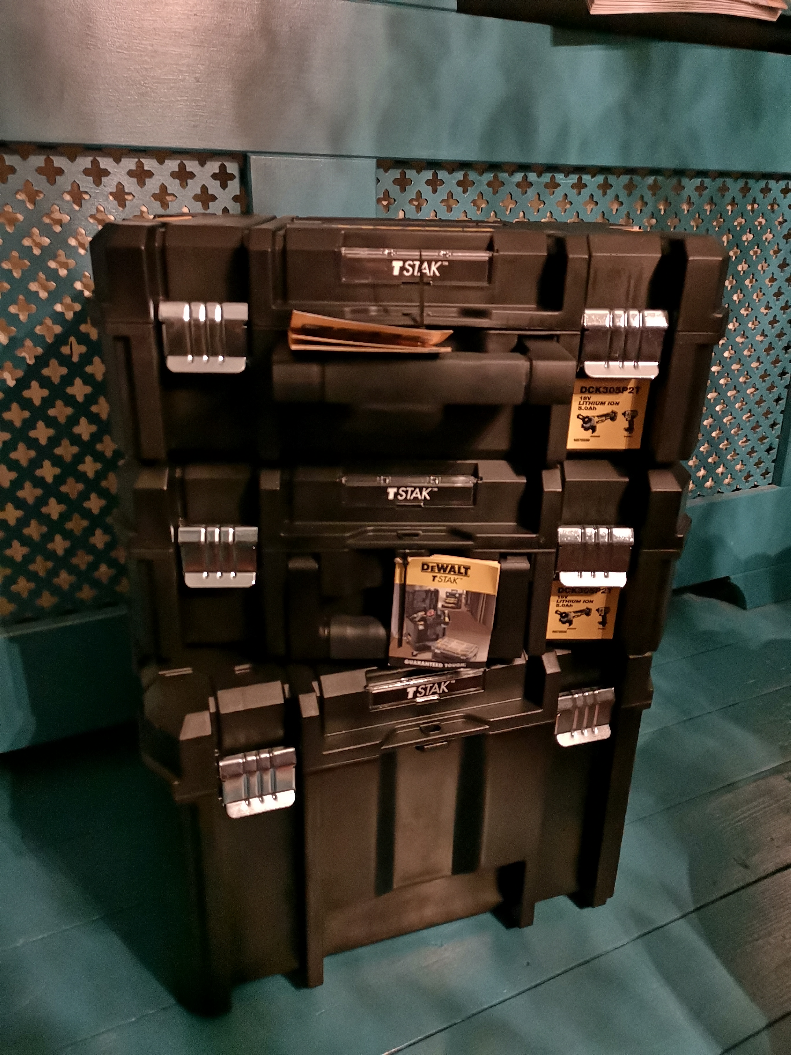

I've got 3 of them already Marc, smaller size, one with drill twin set in, one for laser and one for multi tool, this ones deeper than the breifcase size and comes with a tray in top for pens and bits etc. Was £30 from b and q. Great boxes. Thinking of getting more for other tools. DeWalt do a couple different bases with wheels for them but only good If working on ground floor ?

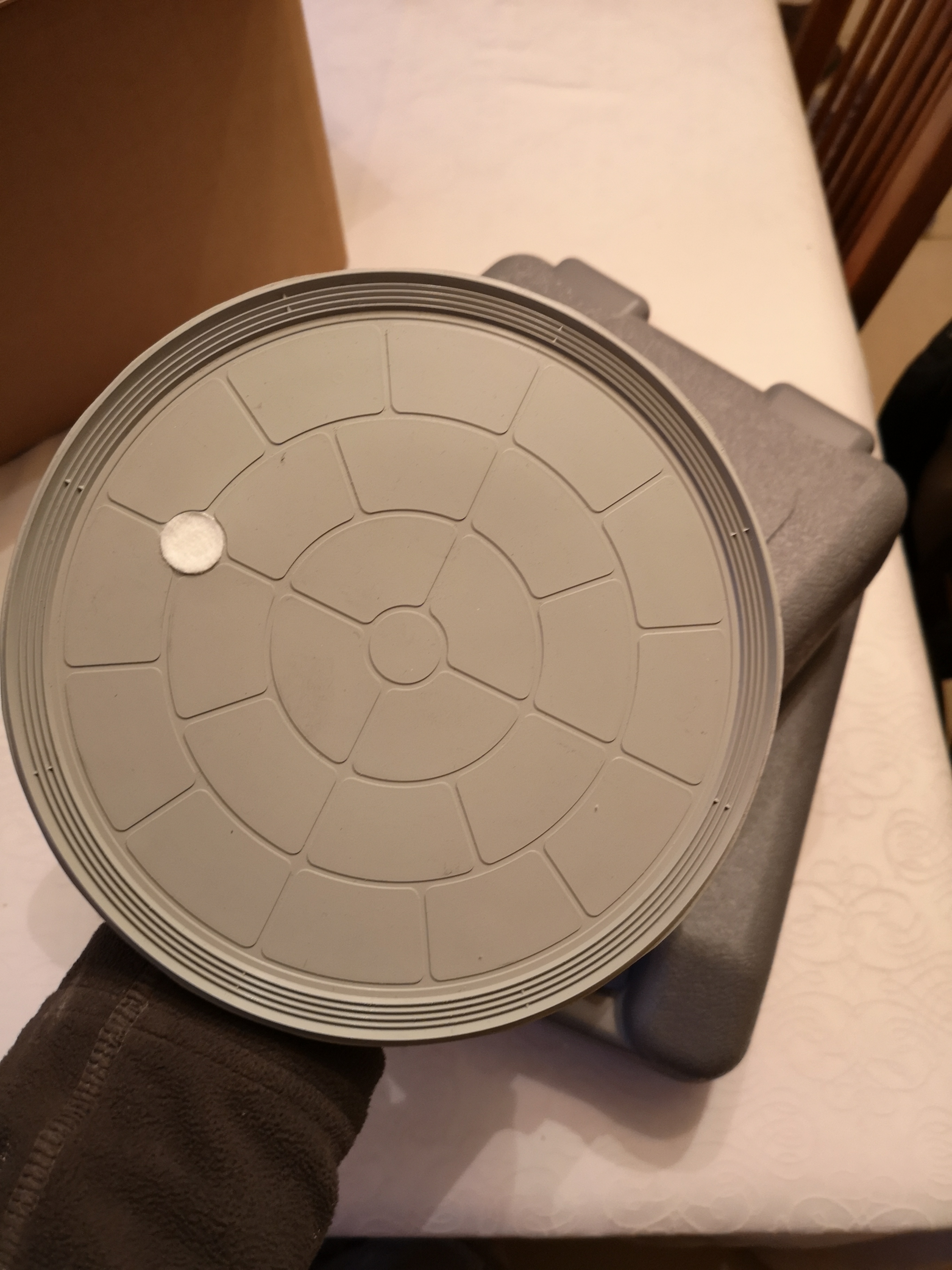

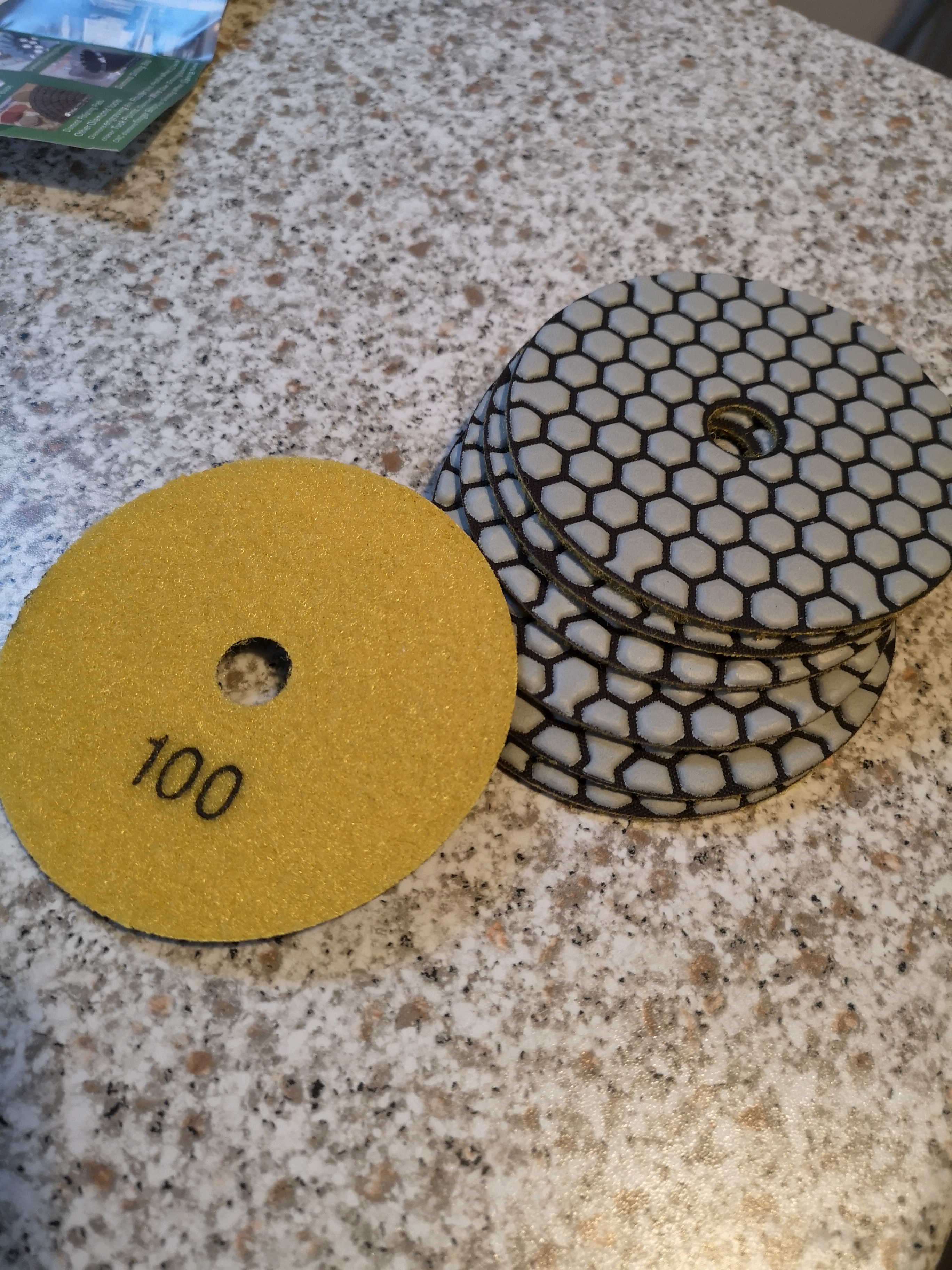

Received these although only 100mm, I need a smaller backer can anyone advise if a soft one or hard one is best with these pads IMG_20181231_153006.jpg
Received these although only 100mm, I need a smaller backer can anyone advise if a soft one or hard one is best with these pads View attachment 103473
Ultimately it depends on what you're doing with them. In general:-
Hard rubber or aluminium backer for flat surfaces or convex surfaces/edges.
The only reason to have a flexible or semi flexible backer is if you need the pads to form to a concave shape or curve.
Sponge (soft) type backers are more appropriate for paper discs, it gives them a little suspension and reduces the chance of tearing.
