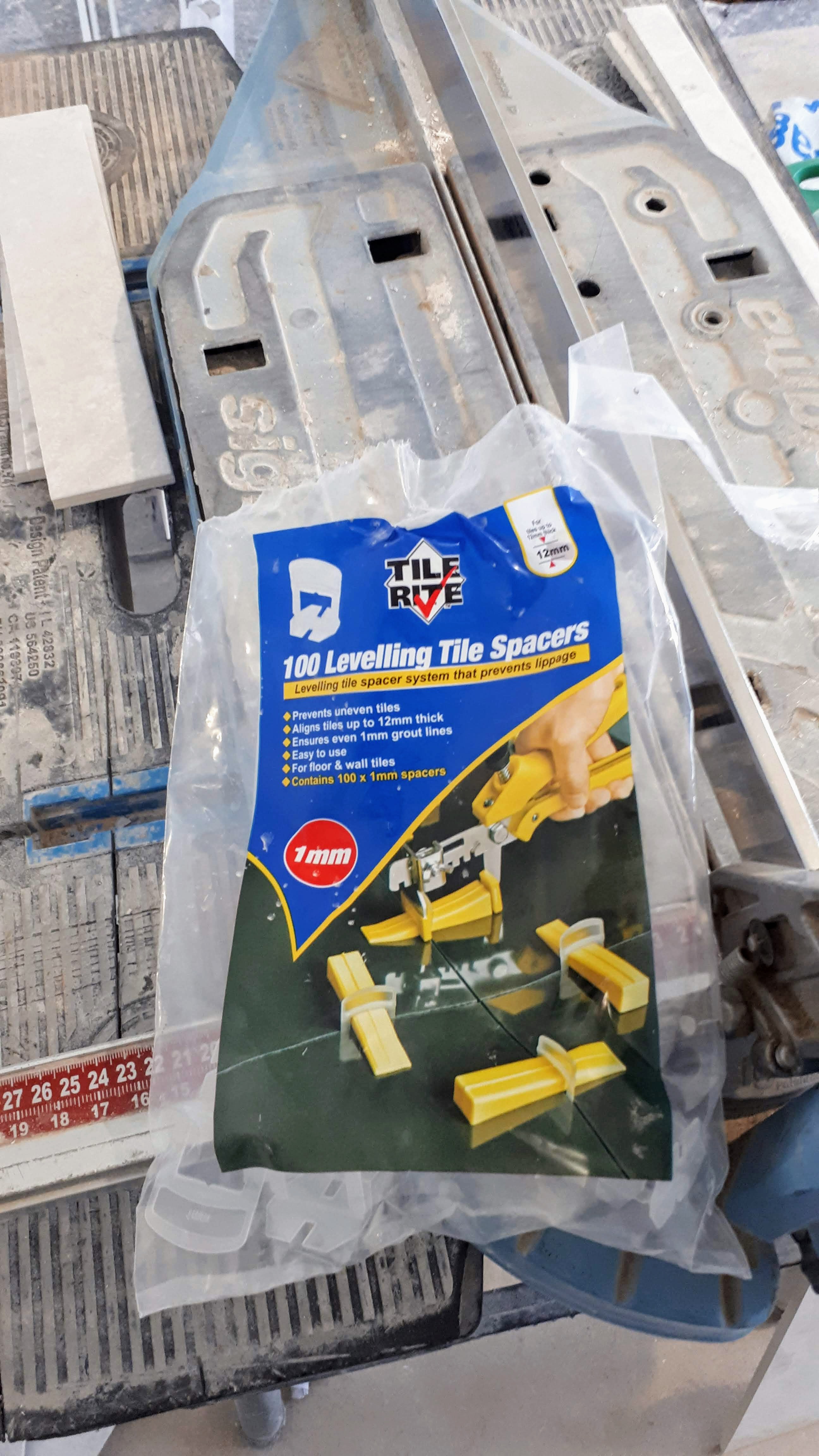

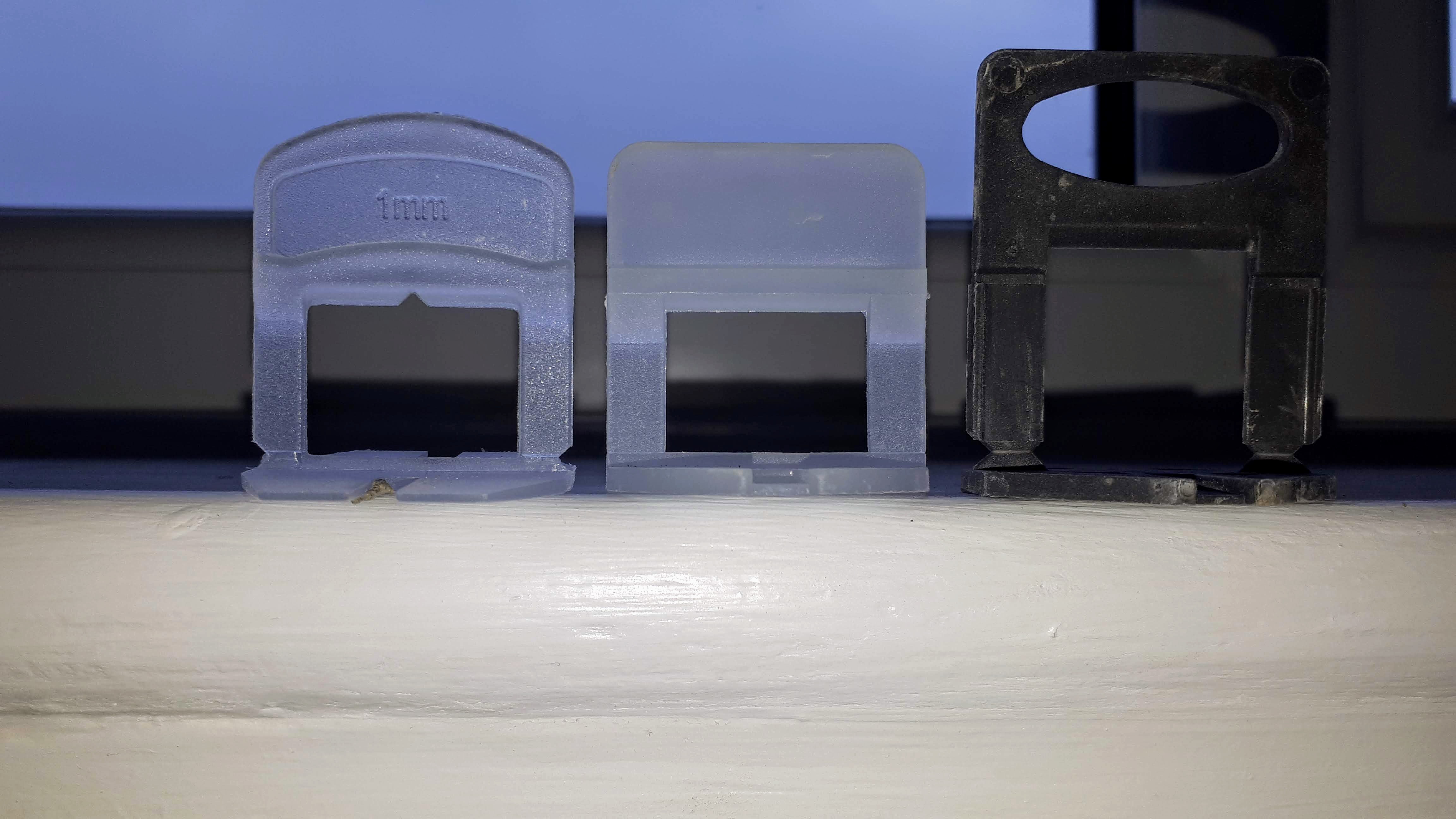

Bought these today as I had run out of my ebay clips.....
Thinnest bases I have come across and did not snap off when tightening. Brilliant if you want to save money on adhesive consumption and not double trowelling.
I need to find a cheaper supplier than the shop I went in though.
The new clip is the one on the left by the way - the middle is ebay and the right is a Mustang clip.

I always keep a supply of these ones handy for when I have tight spots where my normal clips off what are too thick to get under the tile/bed of adhesive, but I don't use them as my main clip because I do get too many snapping off when tightening than I would like
