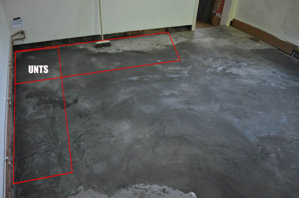

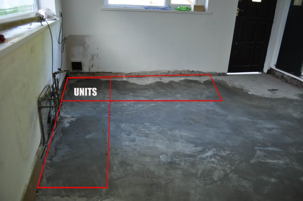

  • The room is about 4X4 square, where should I start?

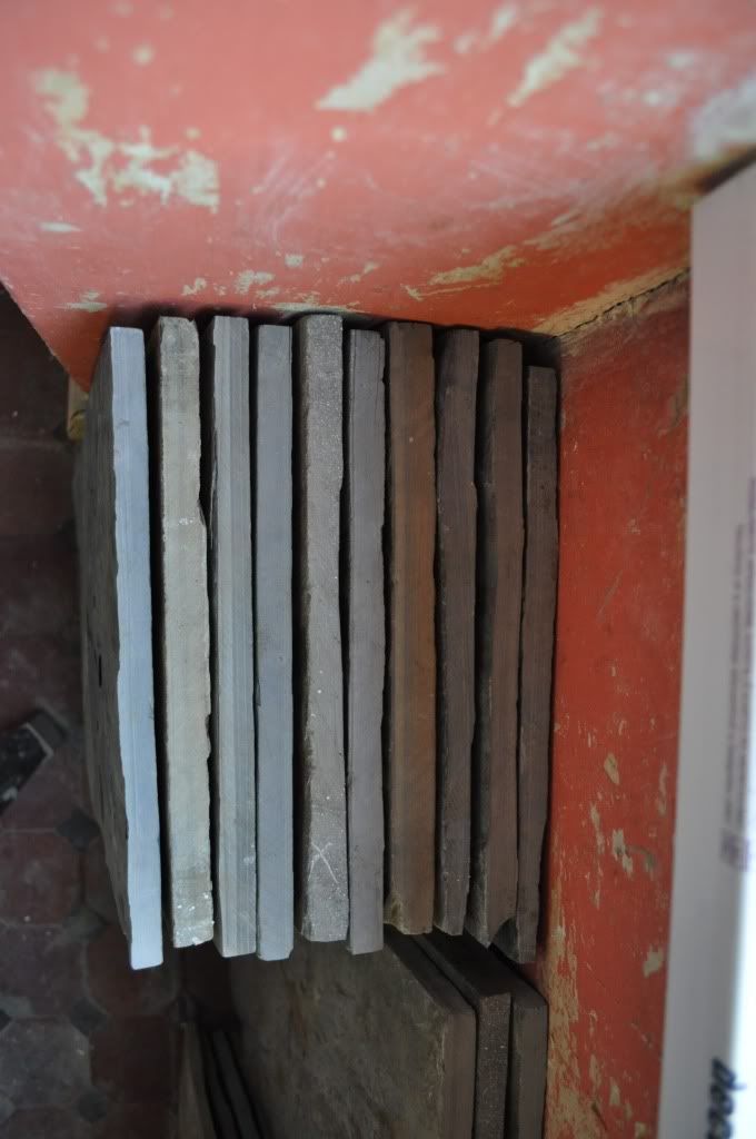

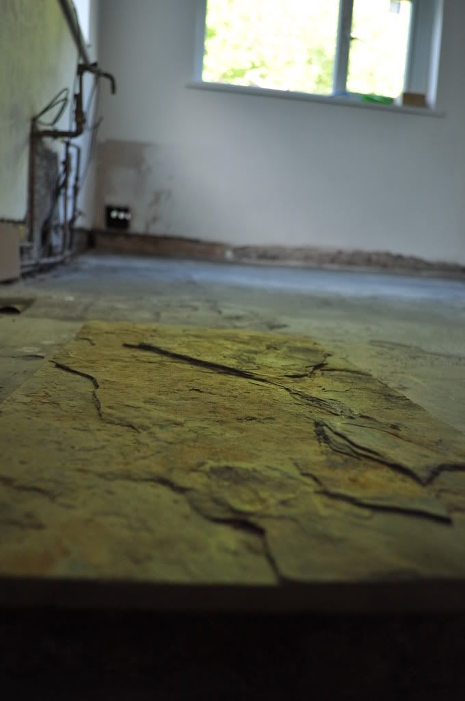

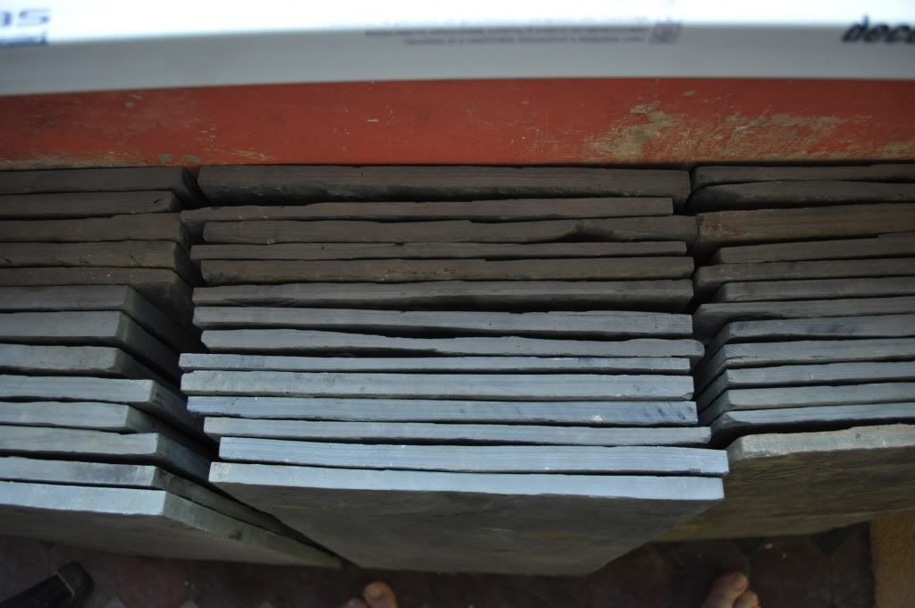

  • The tiles vary from a wafer thin mint to a doorstop crust. Can I make up the thickness with adesive?
  • Doorways scare me, should I be afraid, there's one either side of the room.
Start with the thickest first and please dont skimp on the cost of the adhesive!
You may need to pack out the thinner tiles by a fair depth so wyou will need a decent adhesive that is able to cope with the depth and not slump.

As for where to start, measure the centre line each way in the room and square it to the door and units. 'Ping' a chalk line and work out the tiles from the line to the walls/units to see what kind of cuts you will get, you can either put the tile to the line or stradle it over the centre of it. IF it wont work out with decent cuts then you can shift it left/right/forward/back etc until you are happy
